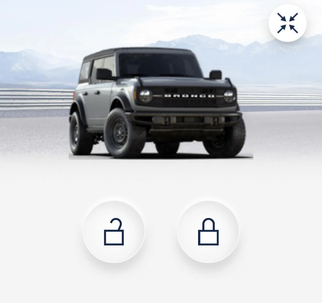

What's usually required to prove that it's in neutral for one of these?
I'm not familiar with Ford Pass, what happens with the app if you try to start it if it's in neutral on a manual? Will it just tell you "BONK! you have a manual, nice try."?
The last bit there is a big question for me too... I hope that Ford Pass can integrate with the 3rd Party remote start systems, but I have big doubts.
