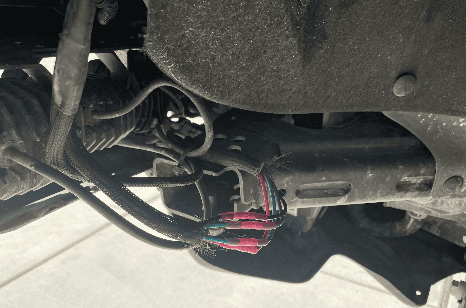

I'm heading down to San Felipe in Baja this Thursday with Camp4Lo. I'd been putting off rotating my wheels a little longer than I should and punched through some procrastination today and got to it. When I got to the last wheel, I discovered the zip tie for my fog light wiring harness had broken loose and must have directly contacted the tire which promptly shredded it. Somehow the positive wire was holding on for dear life. Some butt connectors, a heat gun, and many many many more zip ties later and I'm nice and tidy and back in action.
Ford Bronco Maintenance: Just do it before issue arises!! 1666042001253
I suppose I owe ya'll a proper after pic, but it's super tight and tidy now. I chcked the other side and that zip tie had broken too.
