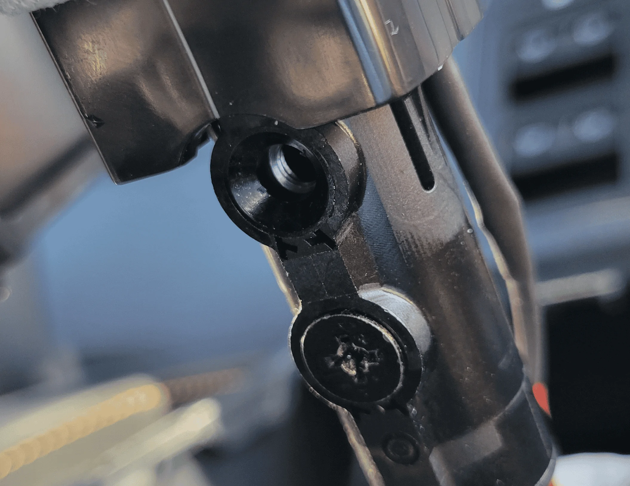

After you struggle and wrangle getting the console disconnected, you need to remove 2 forward facing screws on the shifter (automatic). Damn soft, cheap ass screws... The Phillips screws did what they do, so now I have one I cannot loosen. It is too awkward to use anything to get it out.

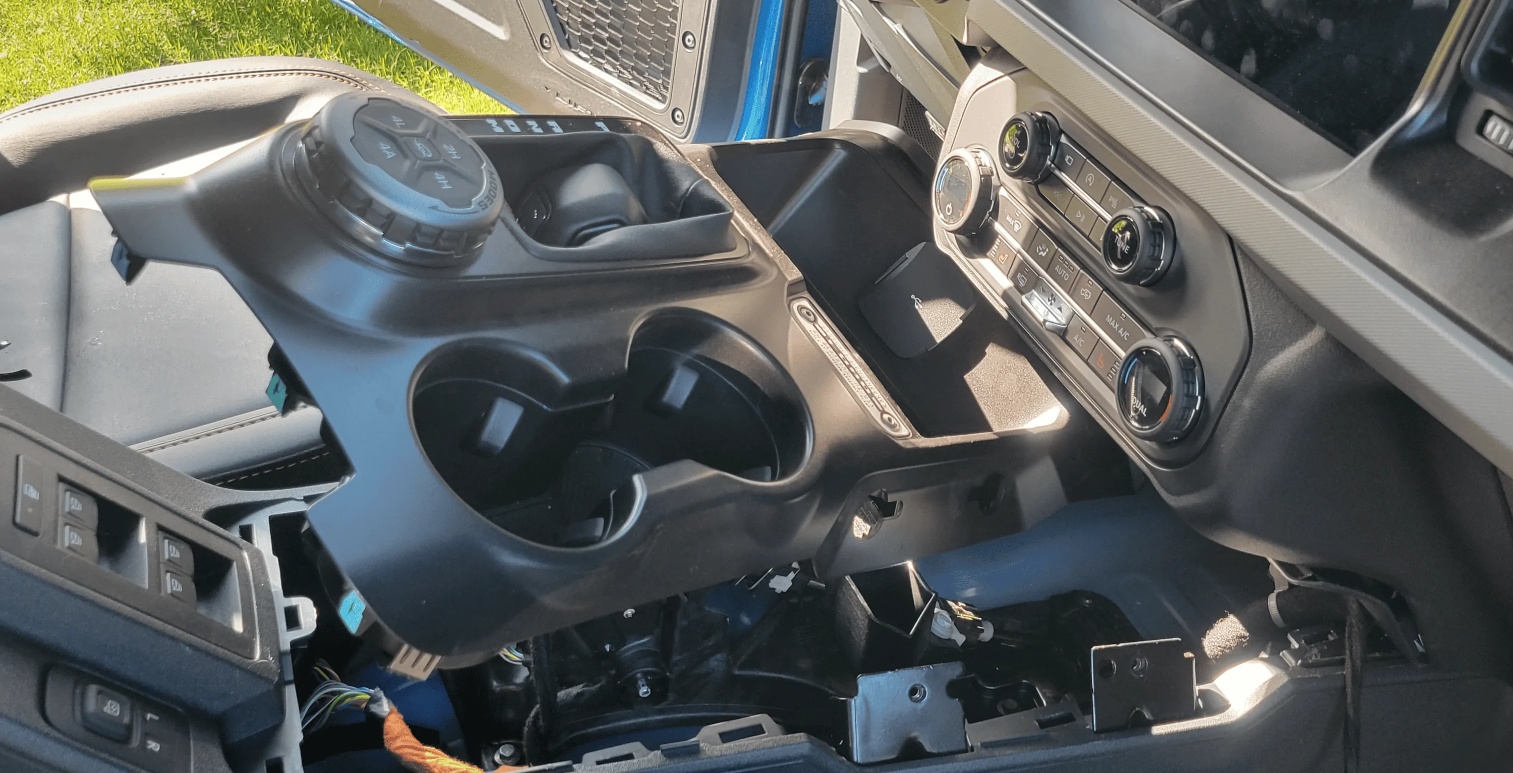

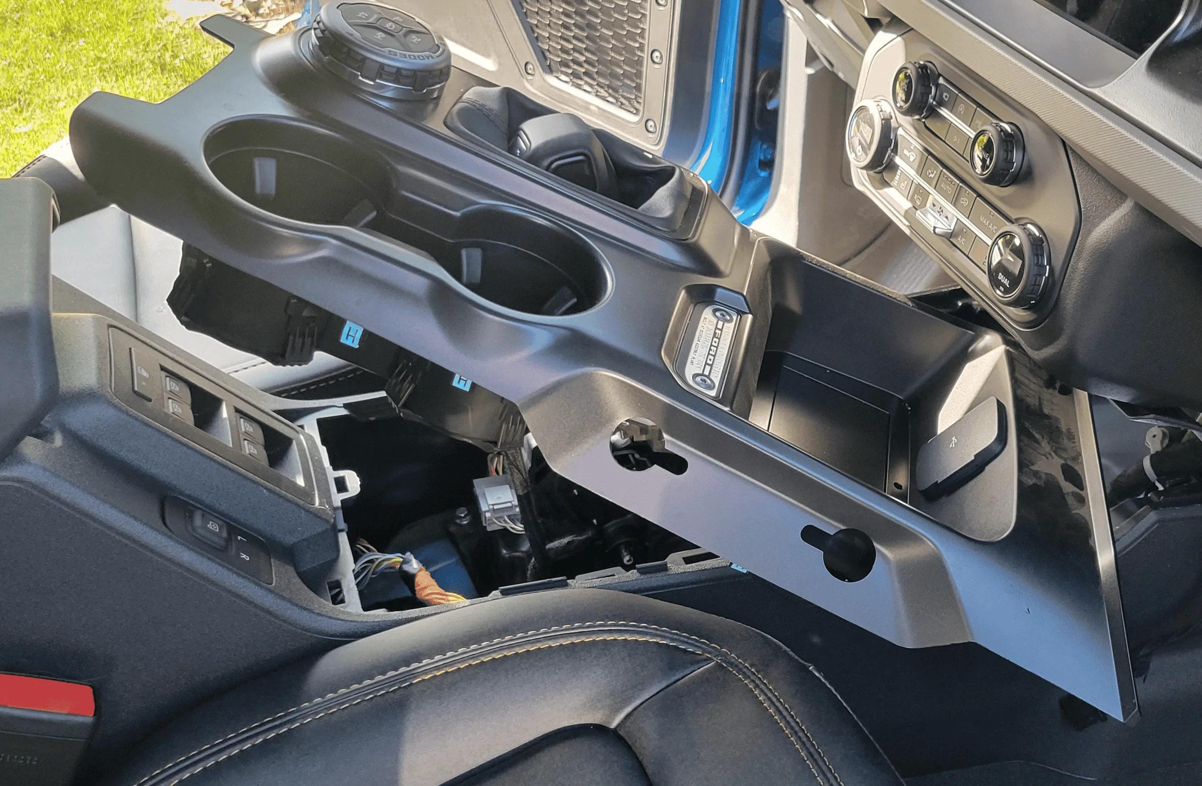

But you can lift the console to the left and right, and uninstall the torks screws where the charger goes IF...
Block your tires, start the car, turn on the parking brake, shift it to M (manual), then turn off the car.
The vehicle is IN DRIVE. Turn the engine off and use wheel chucks for safety!!!
Your Bronco will ding like crazy for 20 minutes (that is how long it took to finish up.)
You have to go to the drivers and passenger's side to remove the screws and screw in the charging unit.
