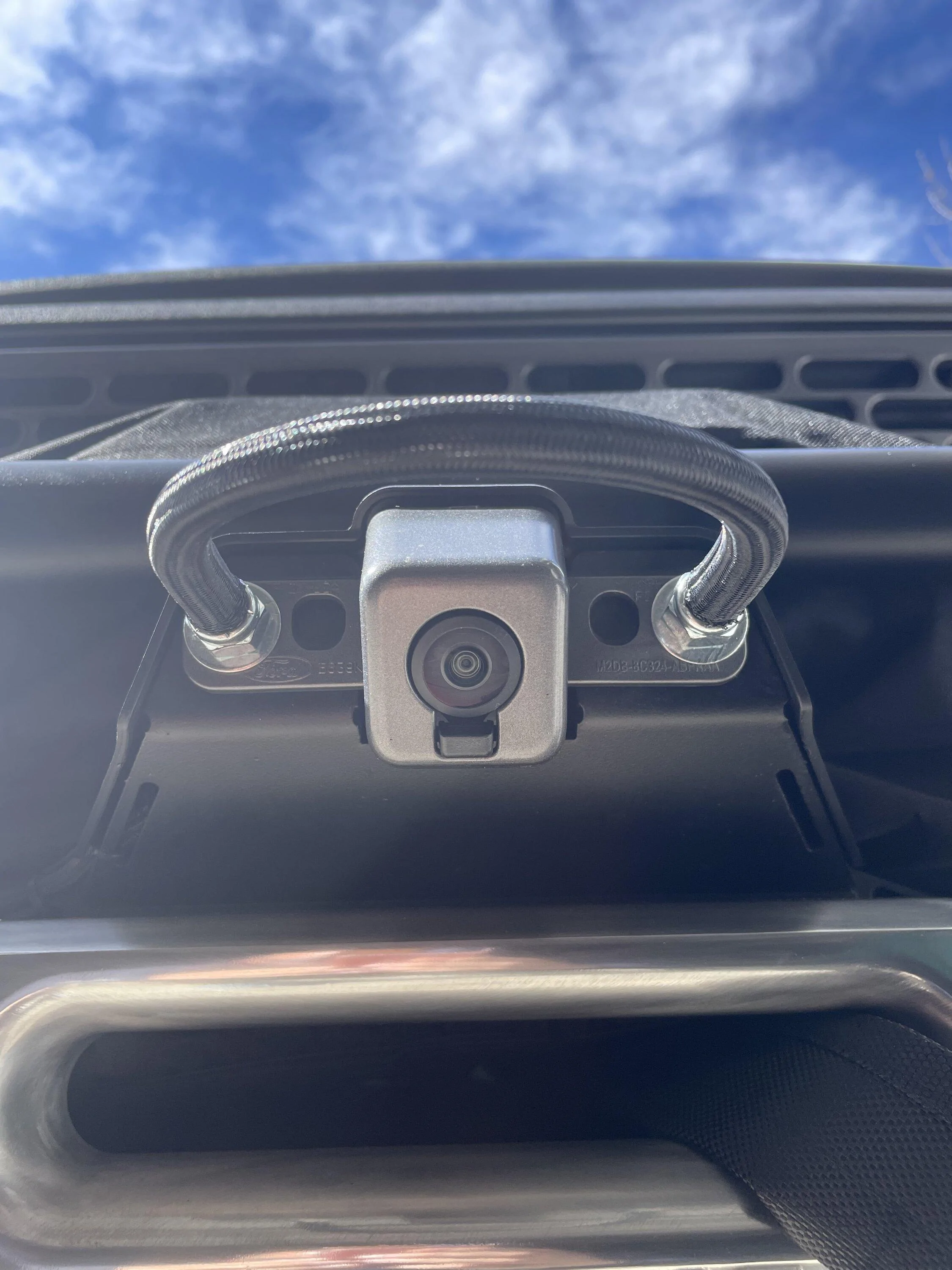

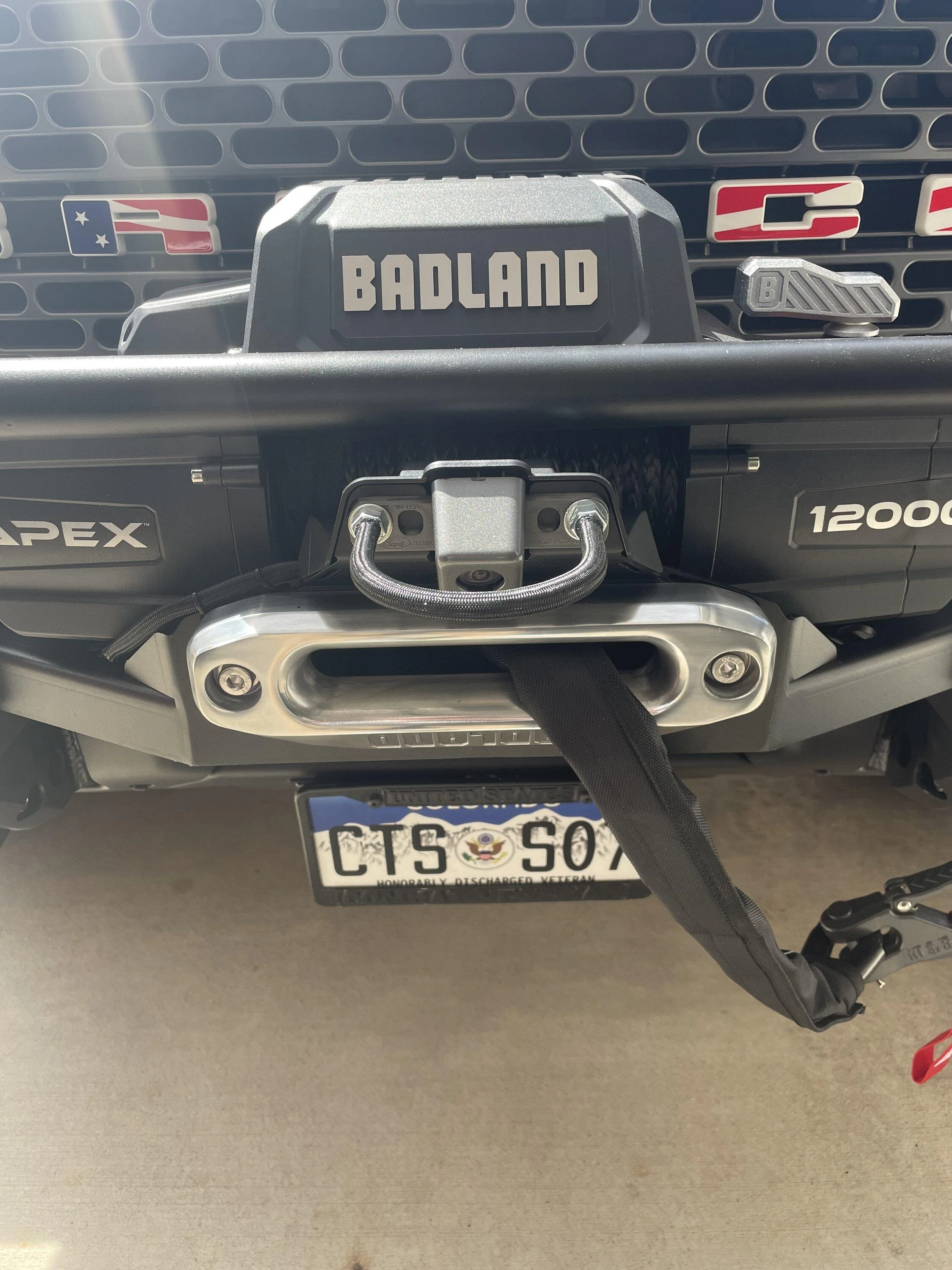

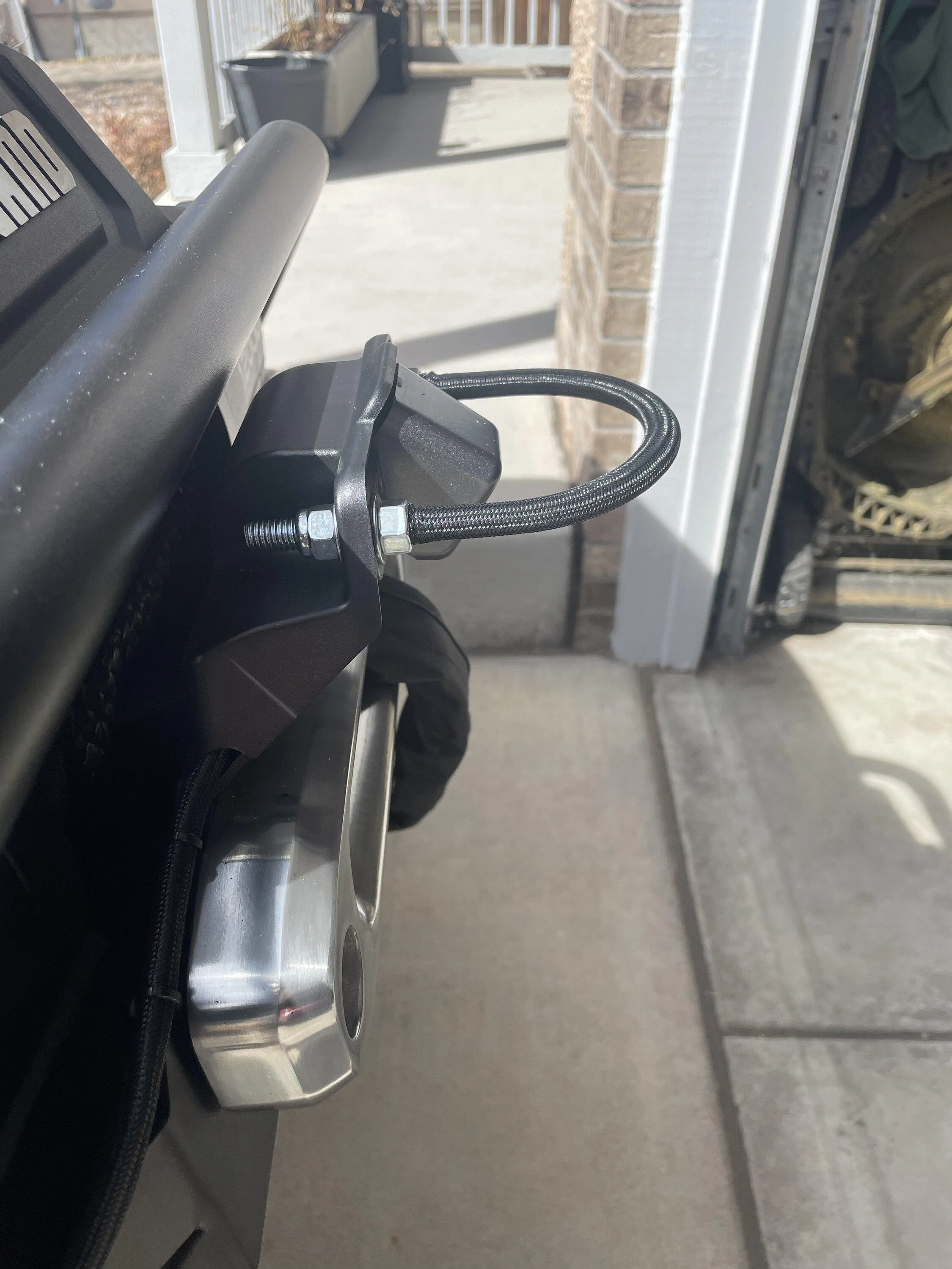

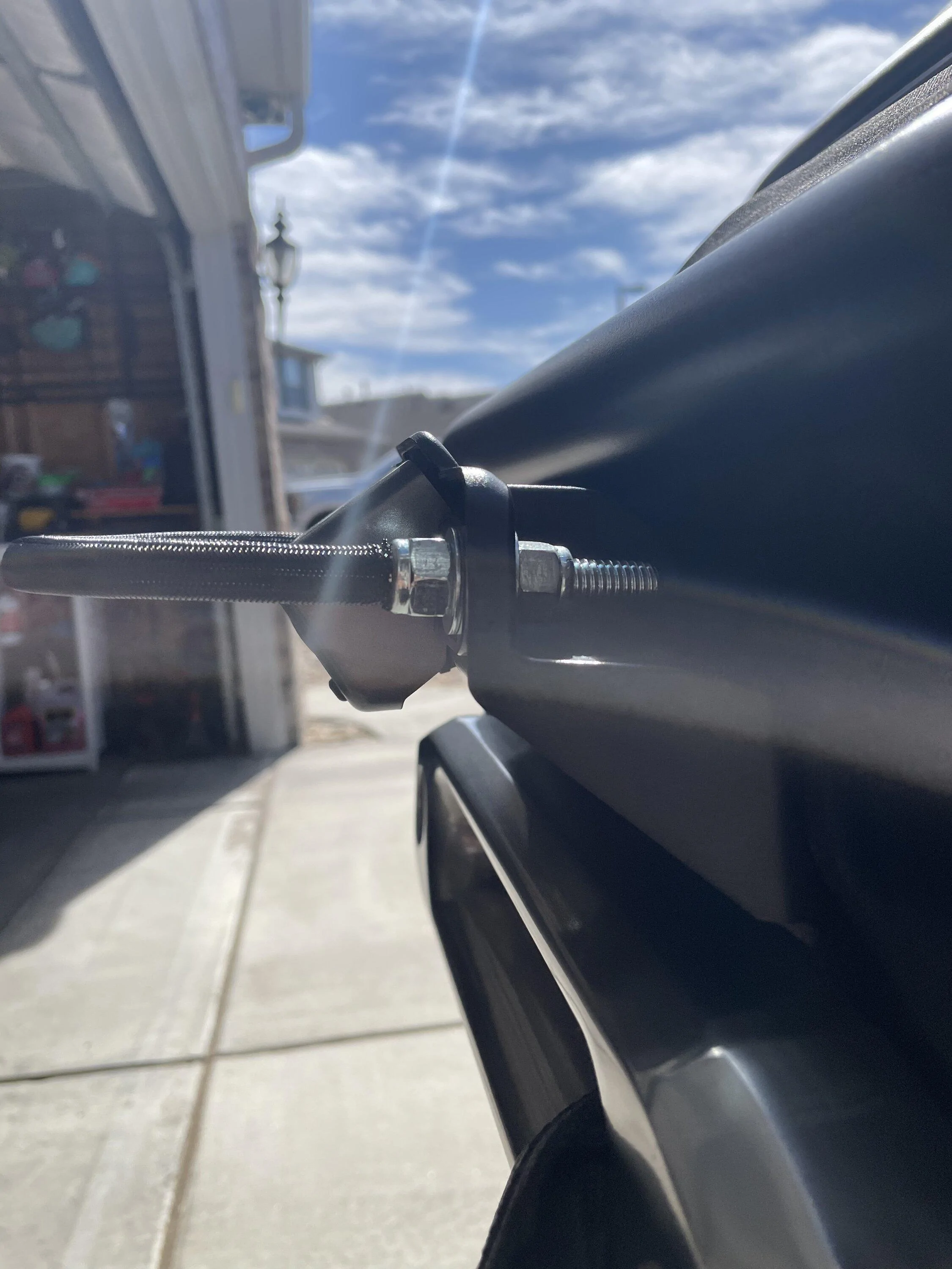

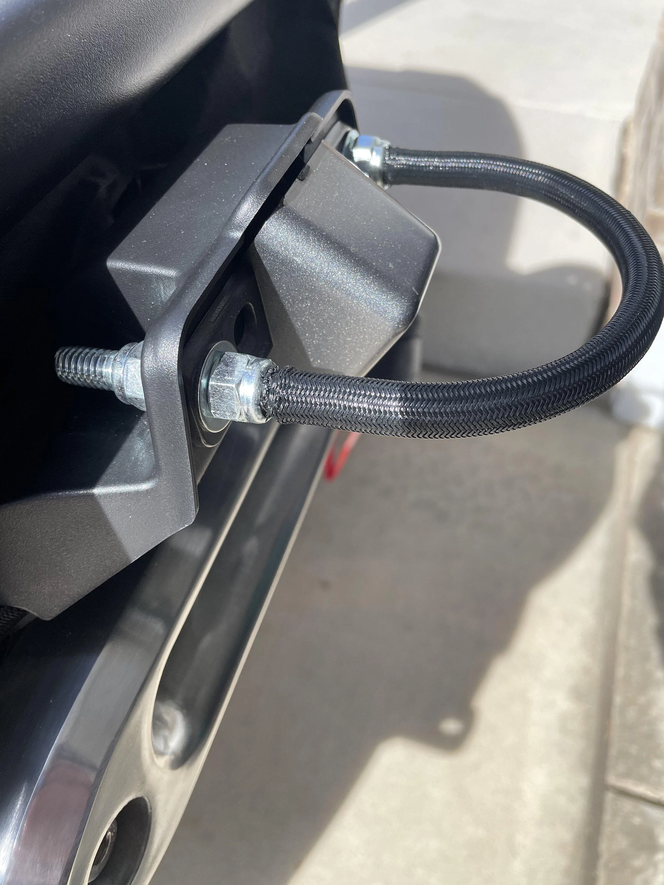

I used a 3/8”x3.5”x4.63” u-bolt I found over at Ace hardware. The OE camera mount holes are 3/8” but I did need to drill the Mabett mount and back cover holes to 3/8”. Then I used washers on the front and back along with nylon nuts. So I total of 4 washers 4 nuts that I had laying around. I wanted to add shrink tube to the u-bolt but couldn’t find my stash so I went with some wire loom sleeving just to black it out.
