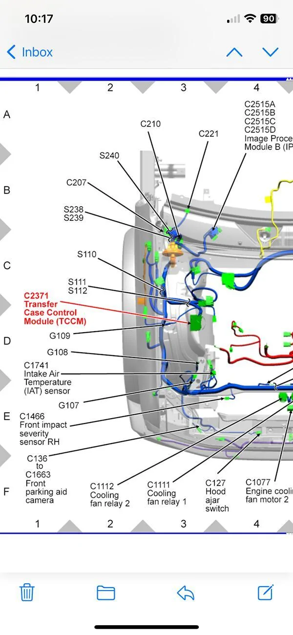

AWD module is engine bay, passenger side, right next to the windshield wiper fluid fill spout.
isn’t that the tcase control module?
That’s the tcase control module

It’s the same thing

Where is the ground for this? I heard it comes loose.
Ray
G109
It’s also shown in the picture I posted previously that you quoted.
