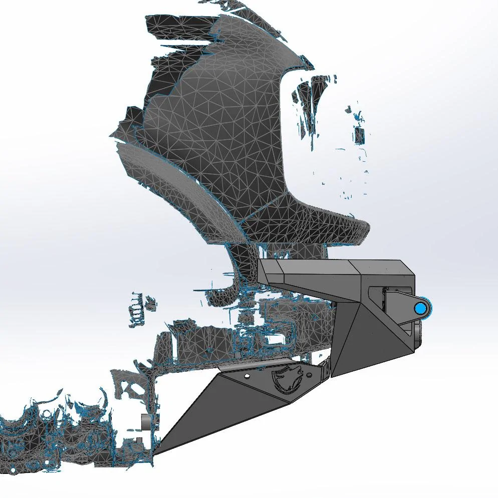

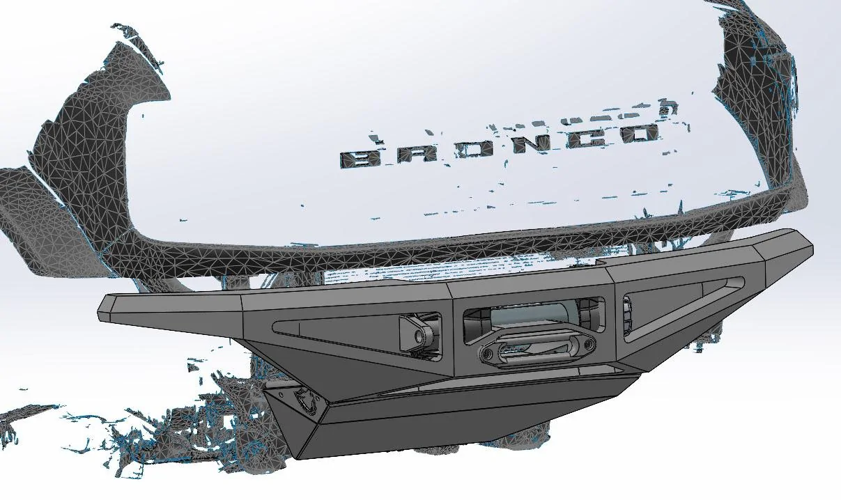

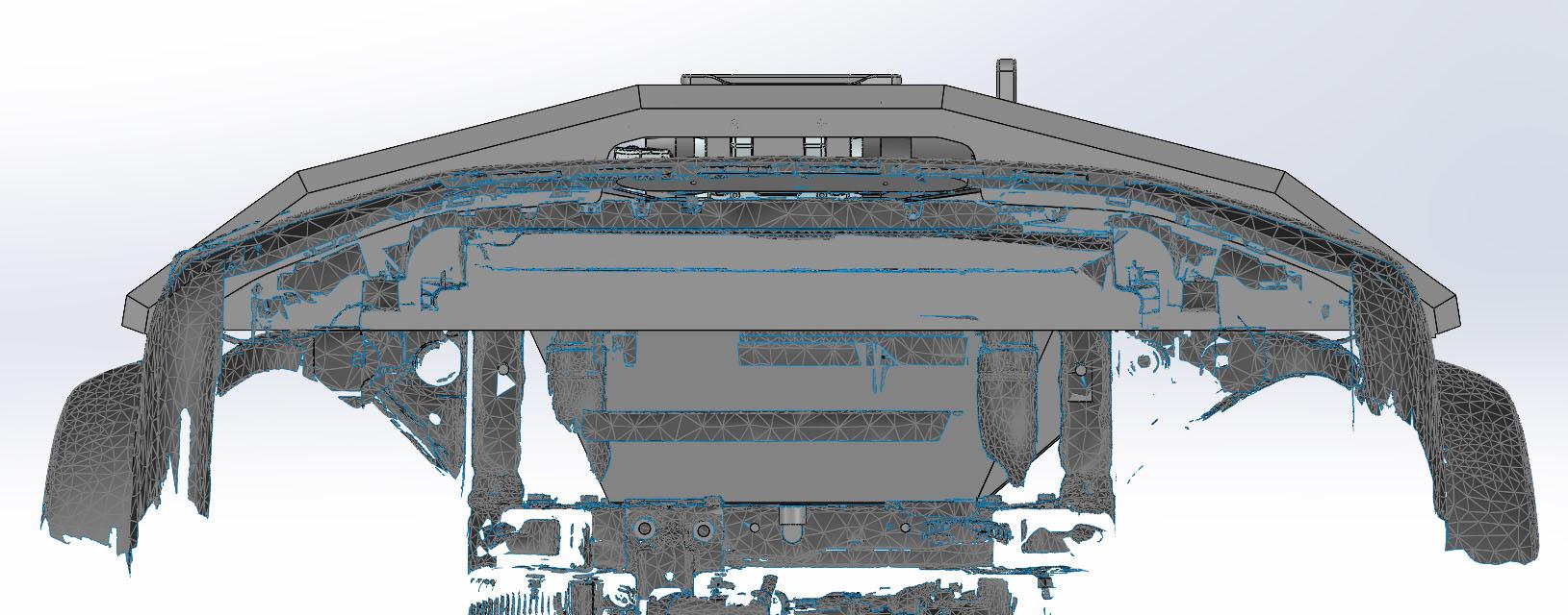

Hey guys I've made a lot of design progress on our WNC series front bumper, and it's coming out even nicer than I thought. The WNC bumper is our version of a front bumper with incorporated winch mount, but trying to adhere as much as possible to our "High-N-Tight" design philosophy. So it's not *quite* as tucked in as our HNT bumper, it's dang close:
Ford Bronco Lobo Off-Road Product Development Thread F6-11-3001-00-I004-
For this one we targeted using the Warn EVO-series winches (8S, 10S, 12S) which all use the same housing so any of them will fit. We couldn't fit a ZEON in there, but the EVO is a good workhorse of a winch. Many other winch brands including lower cost imports should fit in the same footprint.
As you can see, the winch fits entirely within the envelope of the bumper shell, and it only sticks forward an additional 1-7/8" compared to the HNT bumper. Here's a view looking down from the top (ignore the missing recovery tab in the drawing LOL):
Ford Bronco Lobo Off-Road Product Development Thread F6-11-3001-00-I003-w
The WNC gives up a little bit of approach angle right at the center, as you can see from the side view below. But we've narrowed the center section slightly so the outriggers still tuck up very nicely.
Ford Bronco Lobo Off-Road Product Development Thread F6-11-3001-00-I001-sq
Like the HNT bumper, the WNC uses a separate bumper shell, while the recovery points and winch cradle are incorporated into a heavier duty sub-structure. This bumper also gets laser cut grille inserts in the center and outrigger cutouts. This bumper will include parking sensor mounts, but will require ACC relocation. It is compatible with our non-winch skid plate.
For more info about this one, and if you'd like to get on our interest list for it, please check out our website page for it. The waiting list is non-binding, but it will give you dibs on the first units produced, according to your place on that list. You may of course opt out when it comes time to order, if the price, availability date or any other details aren't quite right for you.
If anyone has any questions about this one, fire away. And thanks for taking a look :)

Ugh, just looked at your website and saw the winch bumper, now I’m torn between the HNT Bumper and the Winch Bumper, both look legit. Haha.

How much does the winch plate change approach angle, if at all?
Within our line up so far, we have created a couple options for clearances. Our winch skid and HNT non winch bumper is slightly more clearance than the stock steel skid plate and has more clearance than stock on the corners of the bumper, however is pretty much stock where the factory D rings are located. ( not going to CLAIM to have more clearance than stock, depends on how people want to look at it.)
The second set up would be the HNT winch bumper with the HNT aluminum skid. This will gain over a 1.5" of skid plate clearance, but move the front face of the bumper a little under 2" forward.
The HNT non winch skid and skid plate would be the ideal package for a person looking to maximize clearances.
I know it did not answer your question directly, but hope it gives you a idea.
