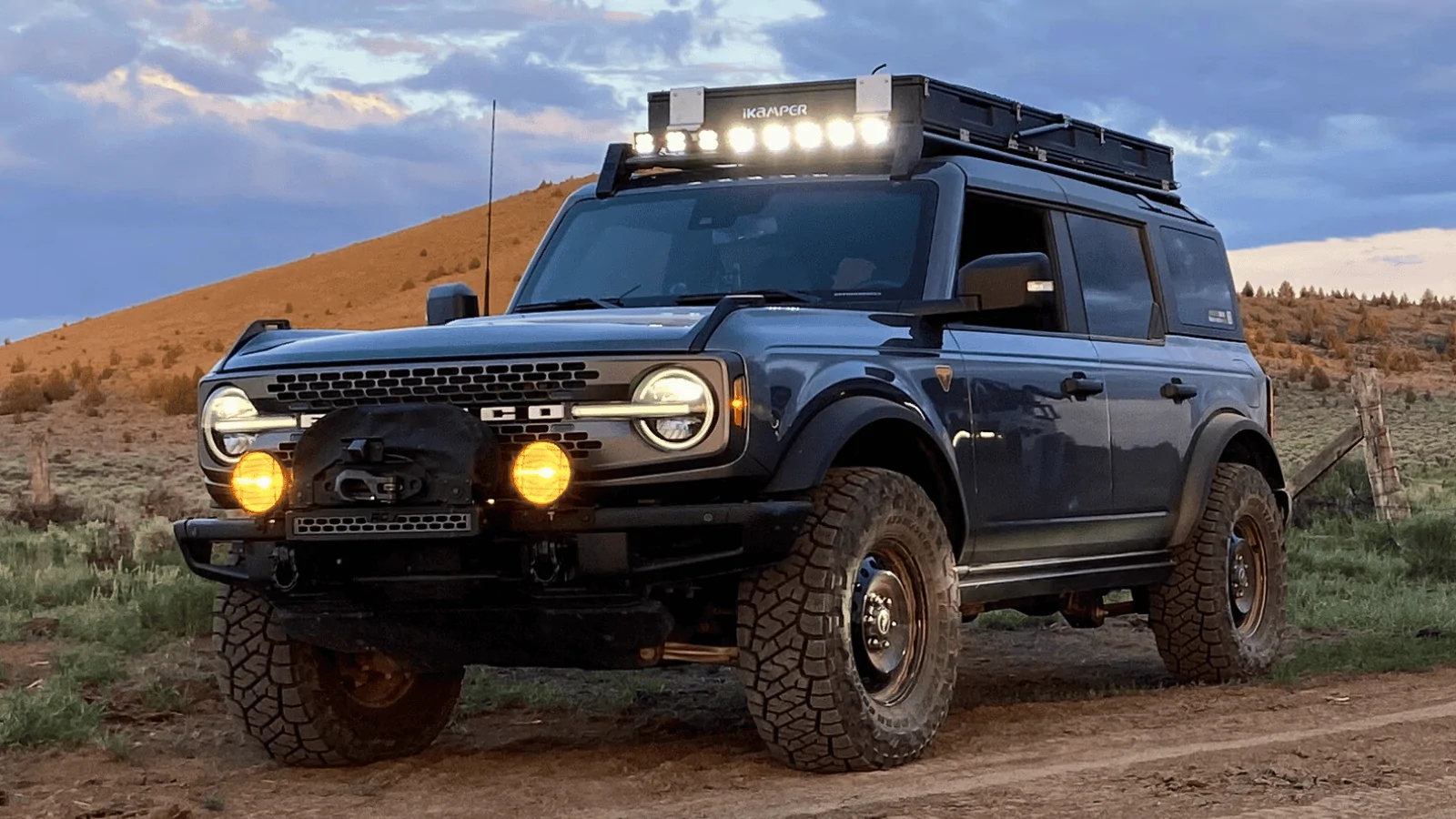

This is not a solution, but info about another brand you may want to try. I run a bunch of ZROADZ 3" Pod lights on my rack wired to an Aux switch. They do not interfere with my GMRS or FM radio.
Maybe give them a try?
