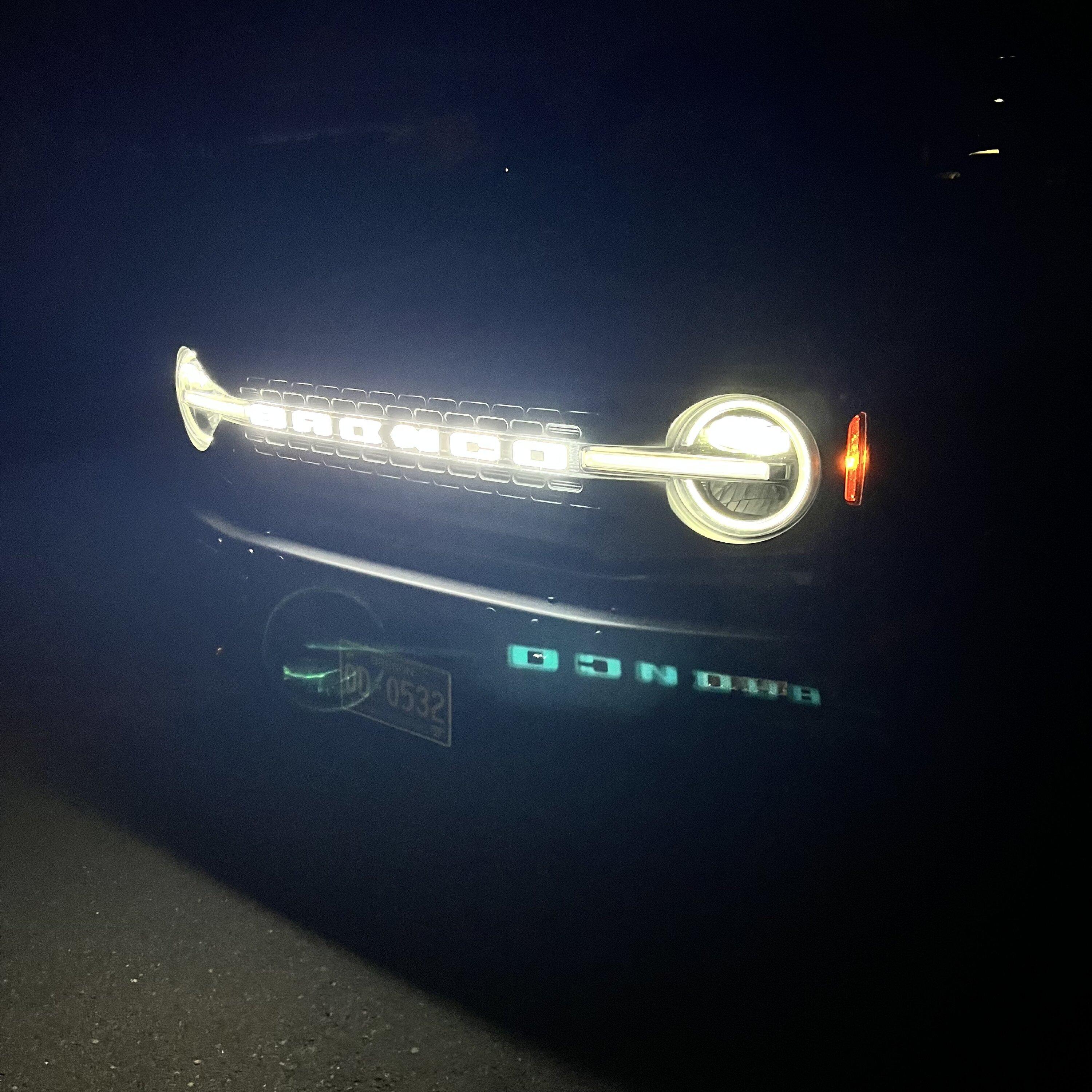

I went
with the Oracle letters, which are slightly different. It is impossible to see them as lit during the day. For that reason I ran them to my Aux 6 and only turn them on at night (when I remember to). Wouldn’t running them to a DRL line cause them to turn off when your headlights are on at night?
Not if theyre tapped to a running light they shouldnt, i.e. the amber marker light. I dont like the oracle because of the backlit. I want the whole letter lit up.

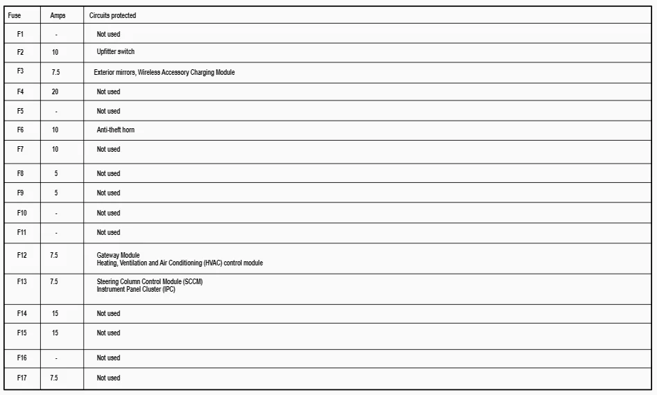

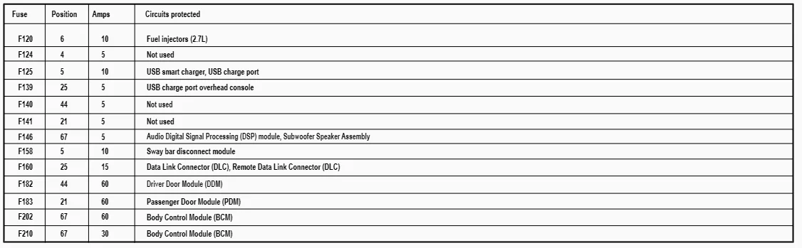

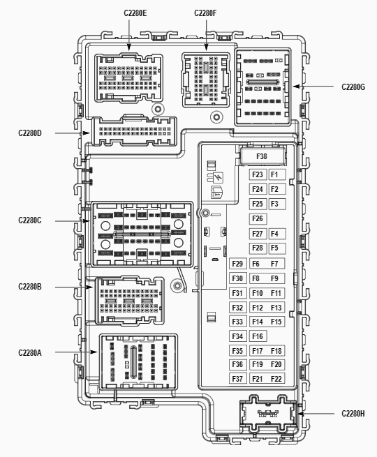

There are some exceptions. If I go though the following section, power distribution, things like this come up. F156 isn't shown in the battery junction box and the cavity in C1035B is empty. I used '22 Bronco for the lookup, not VIN specific but I don't think that would matter much for general stuff like this. This might be for something else in the future but why bother naming if there isn't anything coming out of the box???

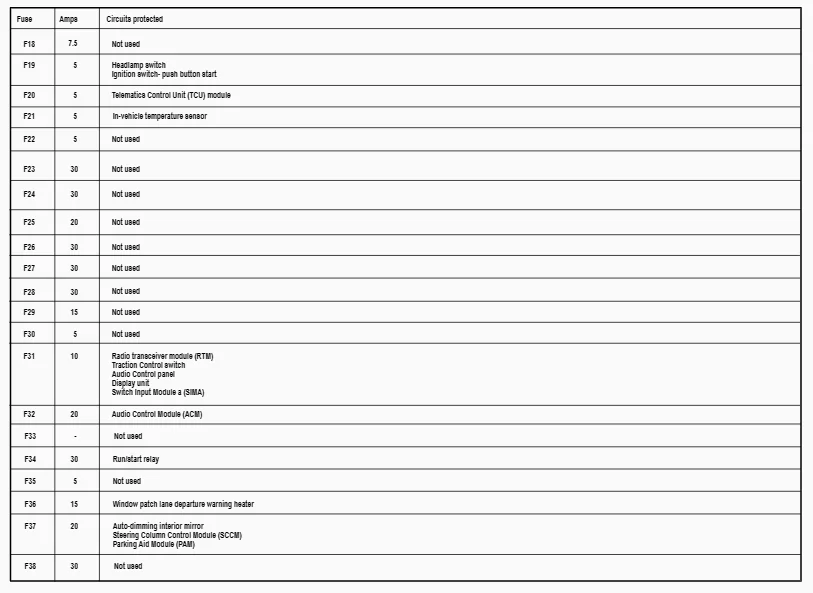

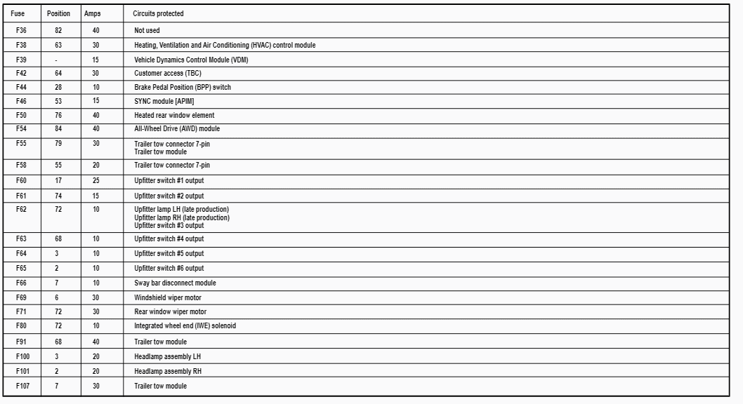

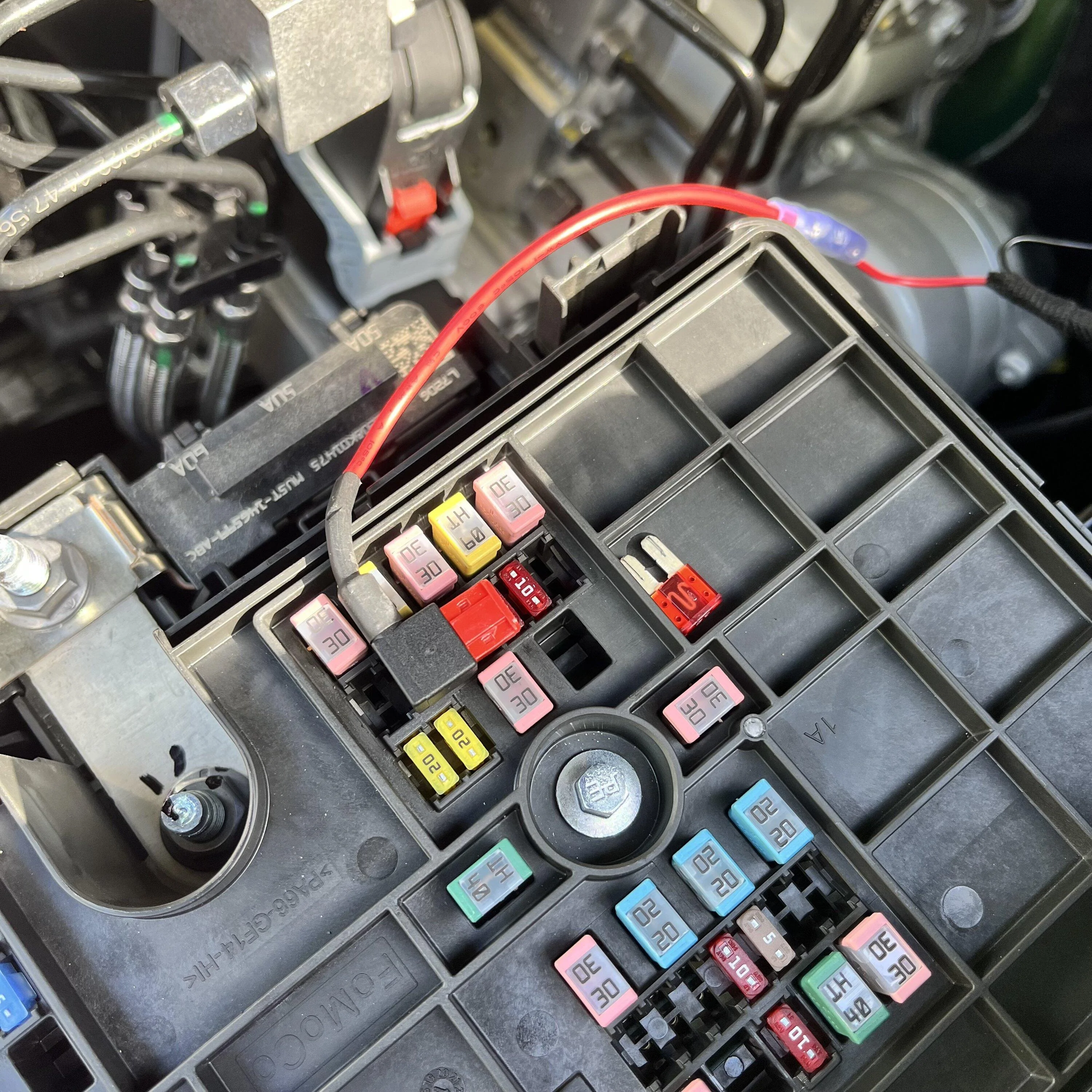

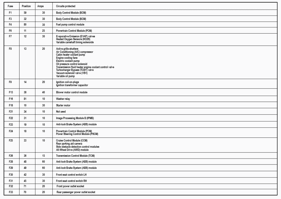

Real tight except for the notch. Also I think that fuse is for the fuel injection. I'm not willing to risk a failure on that circuit even if it's fused.
Correction, based on the diagram it looks like they are using the Cruise Control and 4WD circuit F25.
What is 13-2 (the description is cut off)? If there is a wire and a fuse location does that mean there is power to that location in the fuse box? Since it's not in the diagram any idea where in the box that is?
I plugged the 10amp add a fuse into every open 10amp spot in the box and on my base trim I couldn't find an open one that was live.
13-2 is just the section/cell number where the box is located in wiring book.

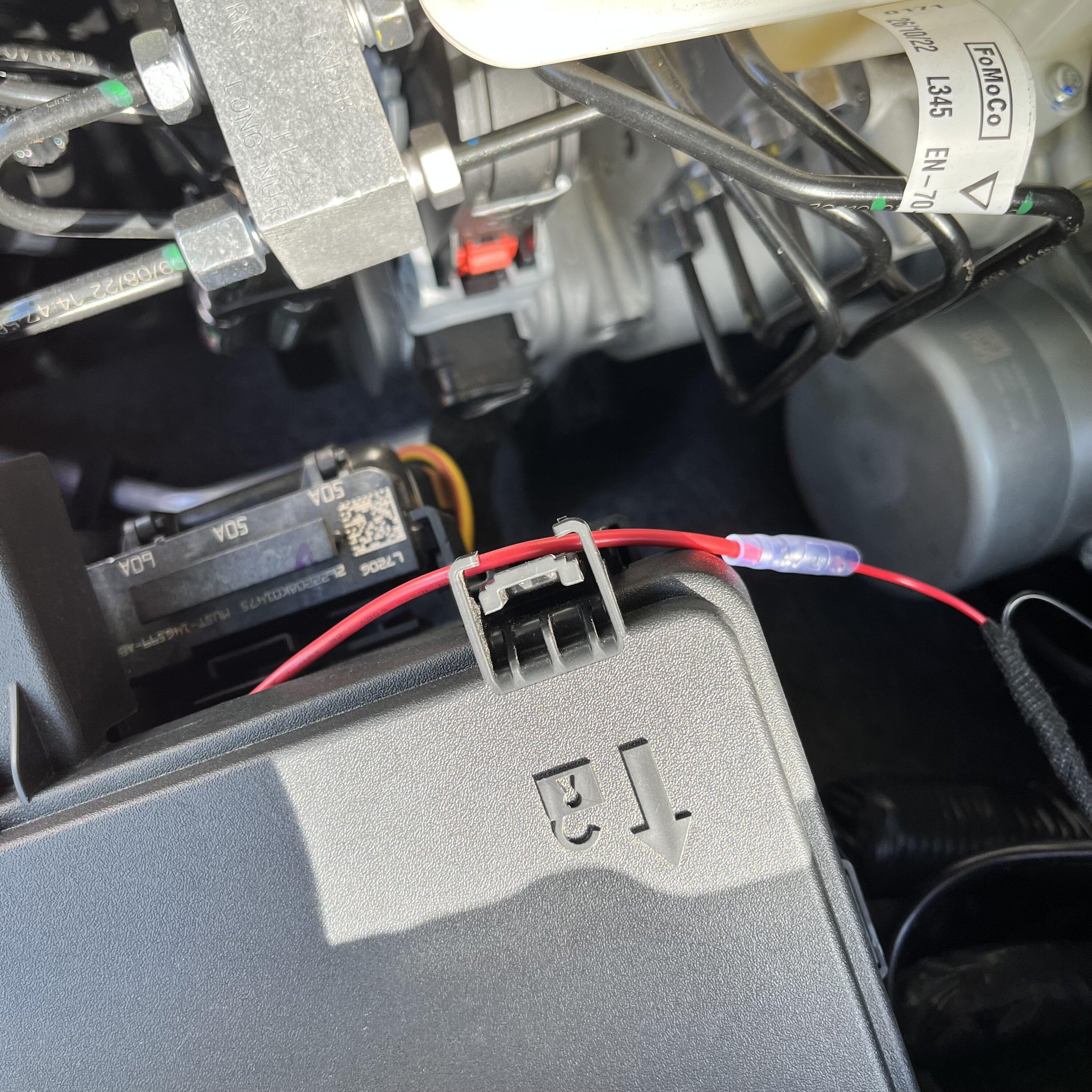

When I installed the Oracle lights on our Bronco, I ran them to the front light bar wire that Ford included and tied the lights into AUX 6 and just leave it on all the time.
As for the tap to the fuse box, cut a small notch with some snips that's just large enough to fit the wire through and still have a tight seal and you're good to go.

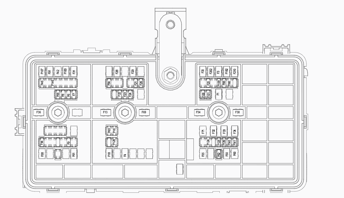

Mabett and IAG has this fuse box cover on Amazon (<$25). It may be helpful if you need to go into there for power.
