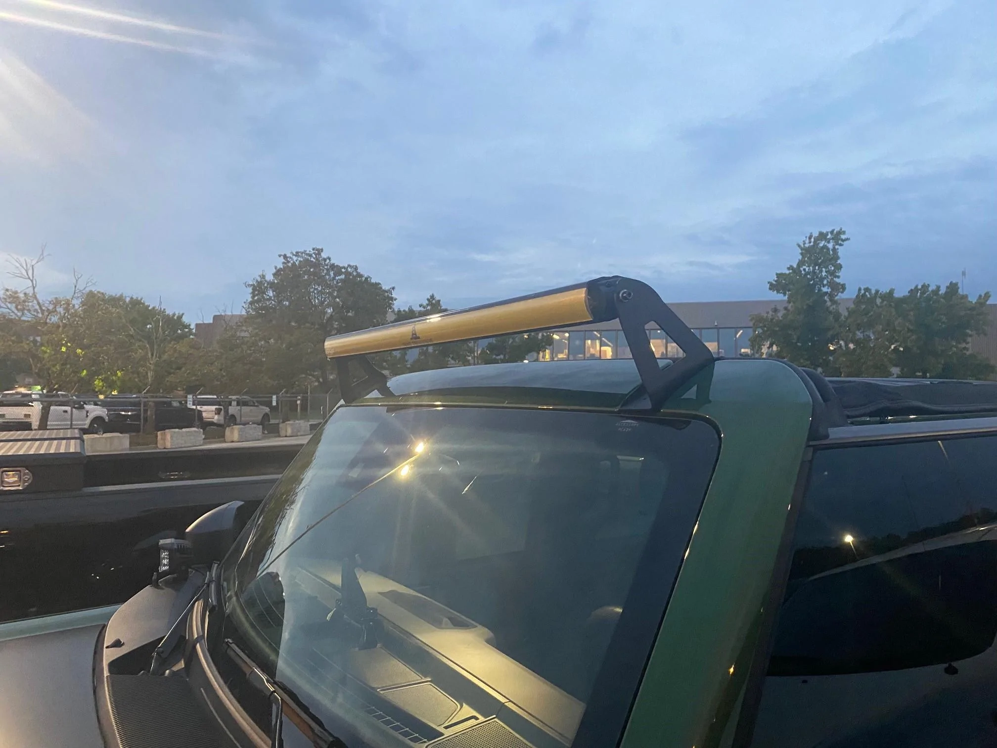

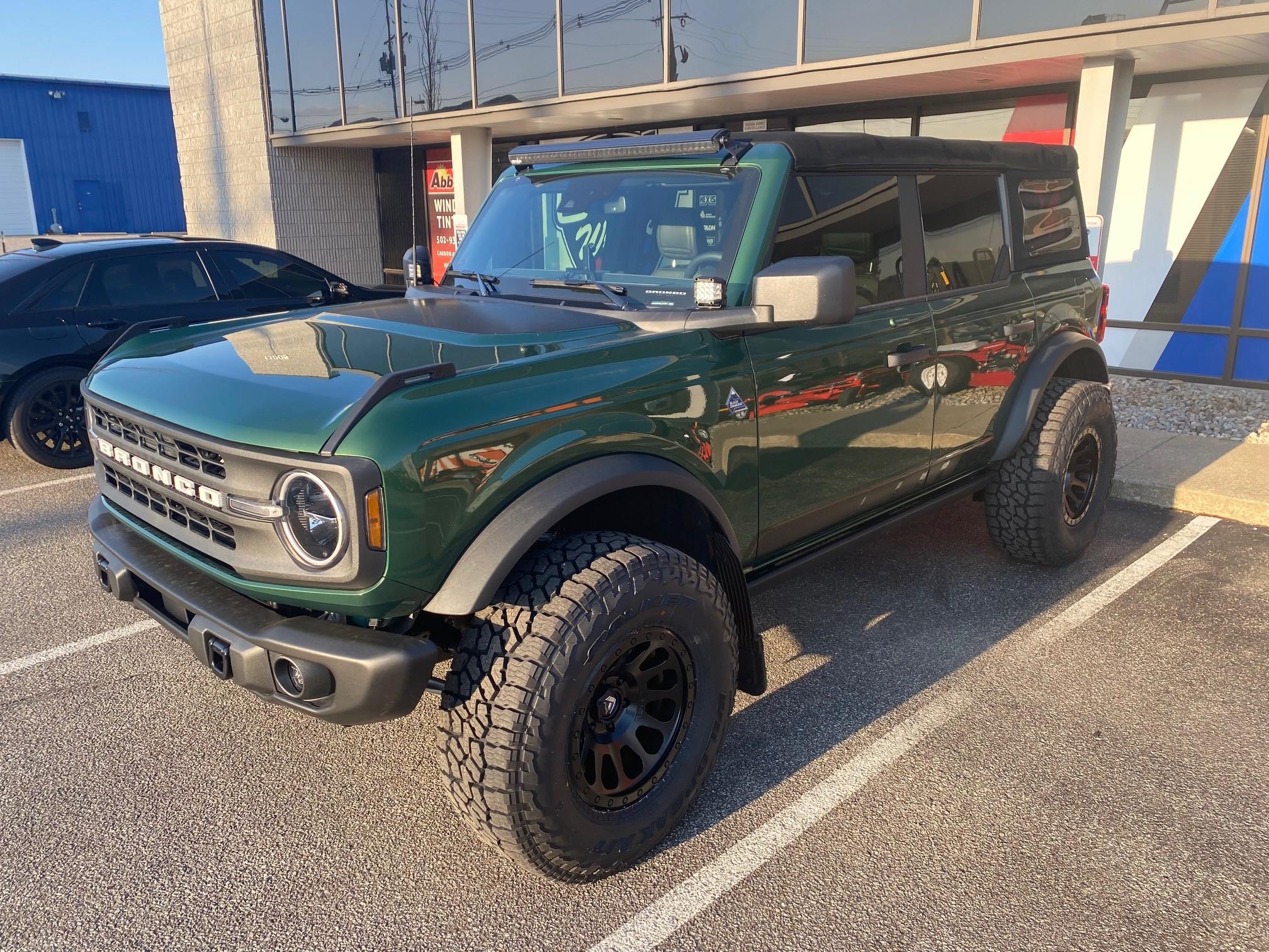

Special Thanks to Rigid Industries for allowing me to buy the tall mounts for my 40in Light Bar -- The change in wind/top noise was amazing. There is still noise but i can actually drive with Light bar facing forward - no top thumping and much lower over all noise. I also use an AeroLidz cover. First picture is before -- Second After

Yeah thats why Im not sold on roof mounted lightbar. Ill prolly mount it on bumper. I would have to hear it for myself. Love the look,but not with added noise. Looks good for sure.

I like the way that looks! I'm going to get a rack mounted one.

How did you order the tall mounts from Rigid Industries? Is there a part number? Or a link?

I had to call their customer service and they helped me

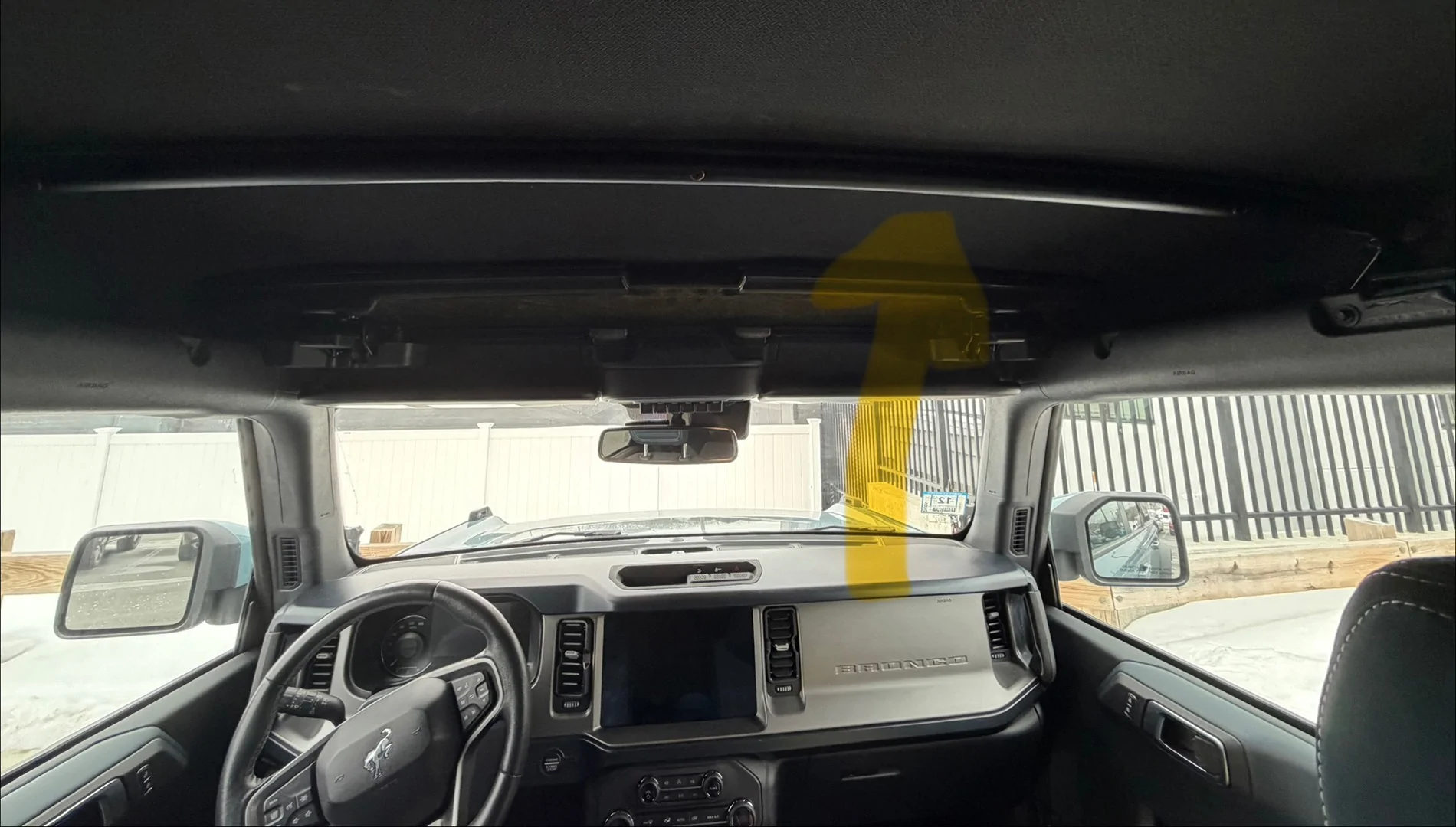

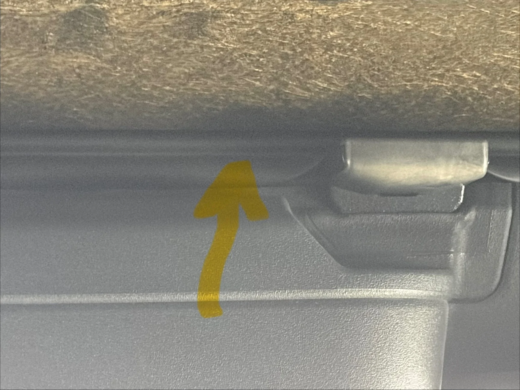

I installed a Heretic 40” light bar and the noise on my ragtop was insanely loud with the ragtop flapping during highway driving. However, was able to eliminate all the turbulence noise by wedging in a 1” pipe foam insulation tube in the front and securing it with 3M strip caulking (pic #2), then I wedged rubber door insulators on each of the ragtop frame members (pic #1)

Pic #s reversed when uploaded
