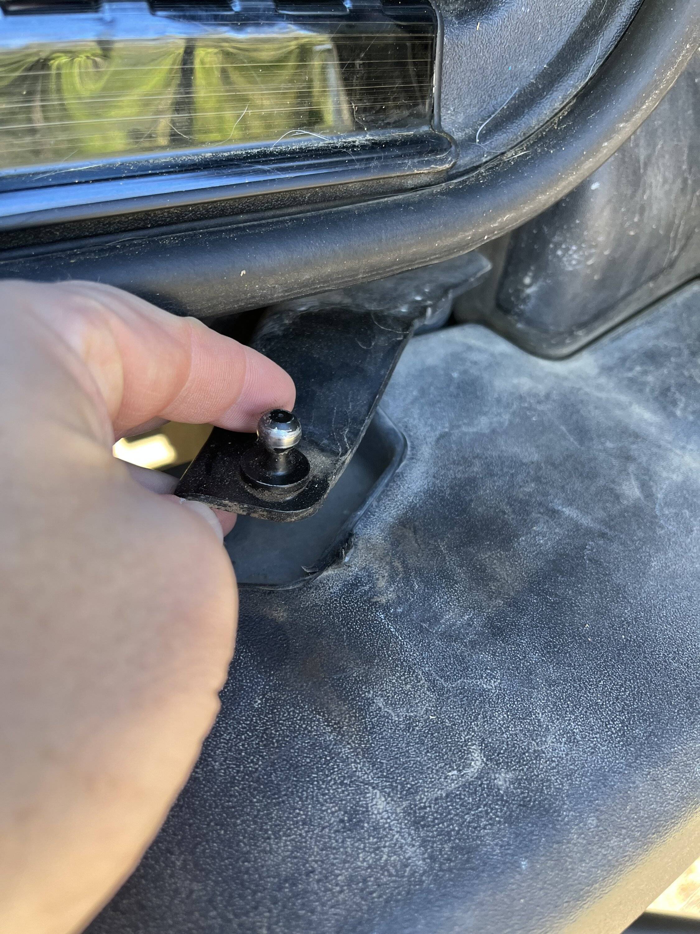

Just a PSA - took me a few weeks to track this one down.
That bracket has two T35 bolts holding it on - easy to pull back and trim the plastic a bit. Pic was taken with the bolts loosened so I could get at the plastic
Ford Bronco Latest squeaking location from cargo area IMG_2292

Where is that? 2 / 4 door. Hard or soft?

That's where the strut for the rear cargo door connects to the body
A 4dr if it matters, but I'm pretty sure the 2Dr is gonna have the same bracket/strut.

thanks
