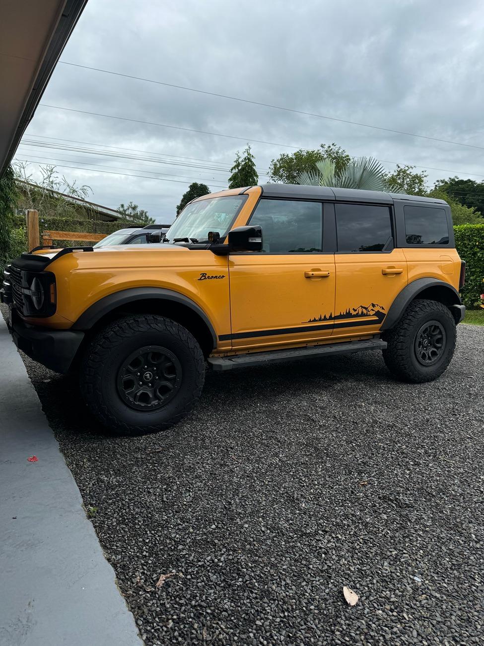

Hi Everyone.
I hope to get some feedback for a couple of doubts I have before moving forward with what we are trying to do.
I have been reading for a couple of weeks now, and watching reviews over King Coilovers, and their counterparty Fox 2.5.
I am more used to Fox, since got them on 2 different F150 Raptors from Factory and the ride with the right C-Rated K02's on 35" is great, but I still want to give KING a try.
When we got the Bronco, we got the Wildtrak with Sasquatch package, but I have to say, the ride it is not so great. specially on the back.
Anyways, we are thinking now on install King Coil Overs and possibly go for 37"s. This is a daily driver car, my wife uses, and she likes the idea. My only concern is the Geometry and even when replacing UCA's I am worried about breaking CV's etc. What I have quoted is CoilOvers, UCA's Tie Rods and Stabilizer links. we plan to do almost no extreme offroading with this vehicle, so thats question #1. How easy a CV joint is going to be affected by going with these coilovers? and what are the chances to break one on a daily conmute.
Second item is the 37"s. Are they really worth it? I have seen builds and they look amazing for the looks, but if we can keep the original 35's with the factory wheels that would be fine too. Also if we go 37"s after the King CO install, we have to replace the wheels to Offset 0 from what I've read?
Last item, is there an intermediate (possible stage 2) suspension that we can upgrade from the Yellow Bilsteins that give some ride confort? I have seen some other Bilsteins and Eibach kits, and I have used those brands on another vehicles but I have no clue if they are any good.
Attached picture of the vehicle we own.
Thanks for the advice.
