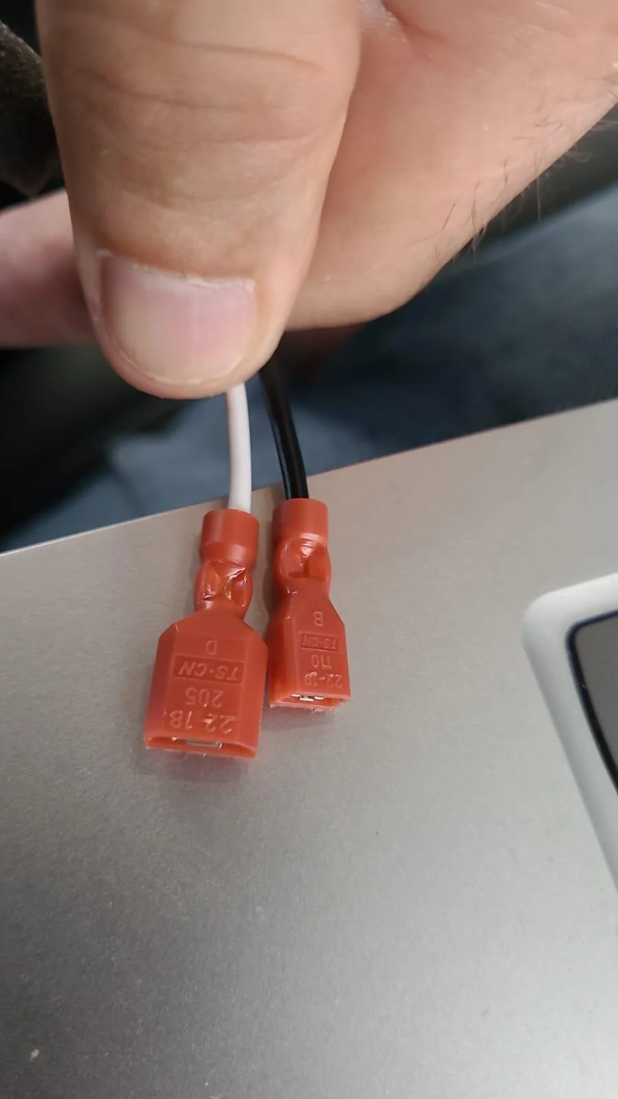

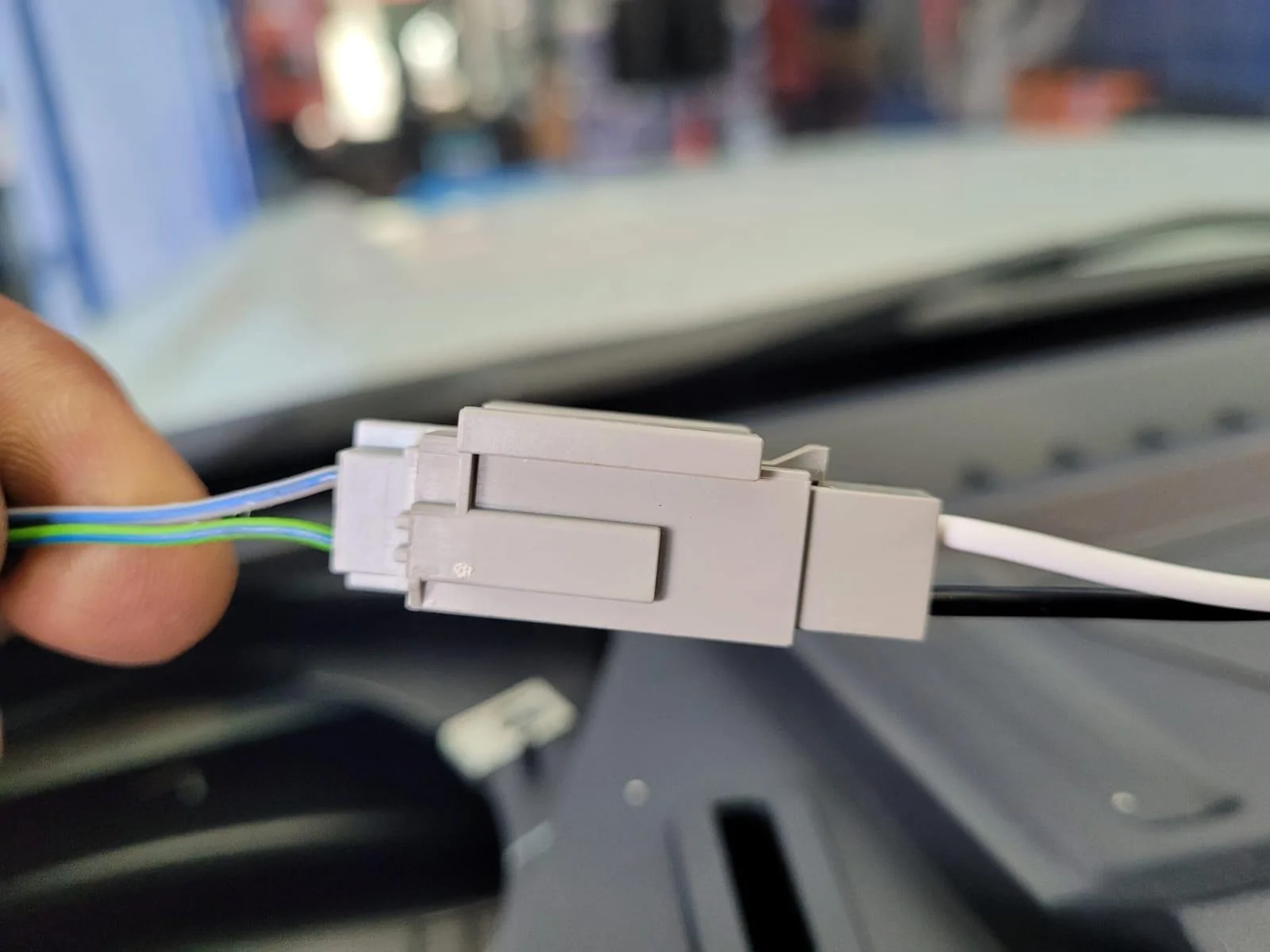

I recently encountered a serious issue while upgrading the 4" speakers on my Ford Bronco with the standard sound system, and I want to share a warning with the community. If you plan on using the METRA 72-5603 connectors for the dash and rear pod speakers, please be aware that the cables may be inverted. During my installation today (May 1, 2023), I noticed that the positive cable was aligned with the negative cable, causing some confusion. To clarify, I reached out to Crutchfield support with photos, and they confirmed that the connectors may be inverted. I suggest double-checking your connectors before proceeding with your installation to avoid any potential issues. Thank you for your attention and I hope this information can help others avoid this problem.

How do you check?
During my installation, I noticed that the positive cable was aligned with the negative cable, causing some confusion. To clarify, I will be posting a photo that clearly shows the error of the left driver side dash speaker connected to the Metra 72-5603. In the photo, you can see that the green cable (positive) is lined up with the black cable that has the smaller spade connector for the negative terminal of the speaker.
