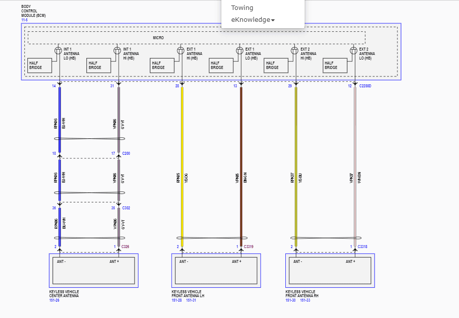

There is an antenna about door handle high on both B pillars and one on each corner of the rear trim panels. We have a '22 with the same message, did batteries, tried new fob, BCM, battery state of charge is good. Depending on exactly where the fob was it would not start. Right pant pocket-ok, anywhere in or on the console-ok, near either B pillar-ok. Sitting on the hero switches-not ok, sitting on back seat-not ok, holding fob at head height or higher, directly above center console-not ok, anywhere within a few inches of the roof panel-no ok.
Mine does not do this and so we conclude it likely has something to do with one or both front antennas after ruling out everything else. Since holding the key near the roof is not normal, the solution is for the customer to keep the fob near or on the console. I think wife may have been leaving in purse which was put on the back seat where it was about equidistant from all 4 antennas. Have seen other reports of the same thing with no confirmed "fix".

People are theorizing in the forums that it has something to do with the PATS antenna. What I want to know is if one of the multiple PATS antennas is non-functional for any reason would that make all of the antennas nonfunctional dust giving the key not detected message?
I ask this because of the rear PA TS antenna which needs to be disconnected in order to remove the rear trim panel for the sub/amp install. Mine I was meticulously careful to both disconnect and reconnect this antenna. So I find it very odd that something may have gone wrong with this rear antenna and how that might be giving the key not detected message when the key is not even in the back of the truck

If it was disconnected or circuit messed up there would likely be a fault code in the system. When we got to the module the theory was it was not sending adequate voltage/signal to the antennas which reduced the signal used to "ping" the RIFD in the fob. The antennas are a direct wire to the BCM so it's not like their signal is processed through another module where it could get corrupted. We don't have any test equipment to prove out the antennas and is more based on a process of elimination. No codes, wires/connectors good, no aftermarket stuff plugged in or nearby, compare to like vehicle, ruling out specific geographical interference locations, fob battery good, vehicle battery state of charge 80%+, program a new fob, if it still has problem with new fob, might be BCM, try a BCM, still does it with new BCM and new fob. Only thing left is the antennas and there's no guarantee replacing one or all will change anything. At this point, Ford probably isn't going to be paying for more parts cannoning and it's time to call it a characteristic.
My suggestion is when this happens again, put the fob against the trim panel just below the top seat belt mounting point or about level with your left shoulder and see if the warning goes away. I honestly believe some of these are just a little particular about where the fob is, however I have no way of verifying with hard data. Signals may be weaker in some than others which I have witnessed and gives some weight to my theory.
