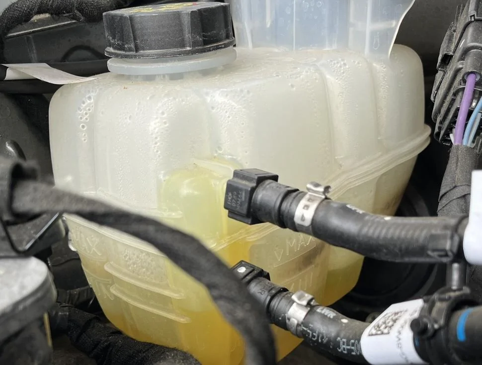

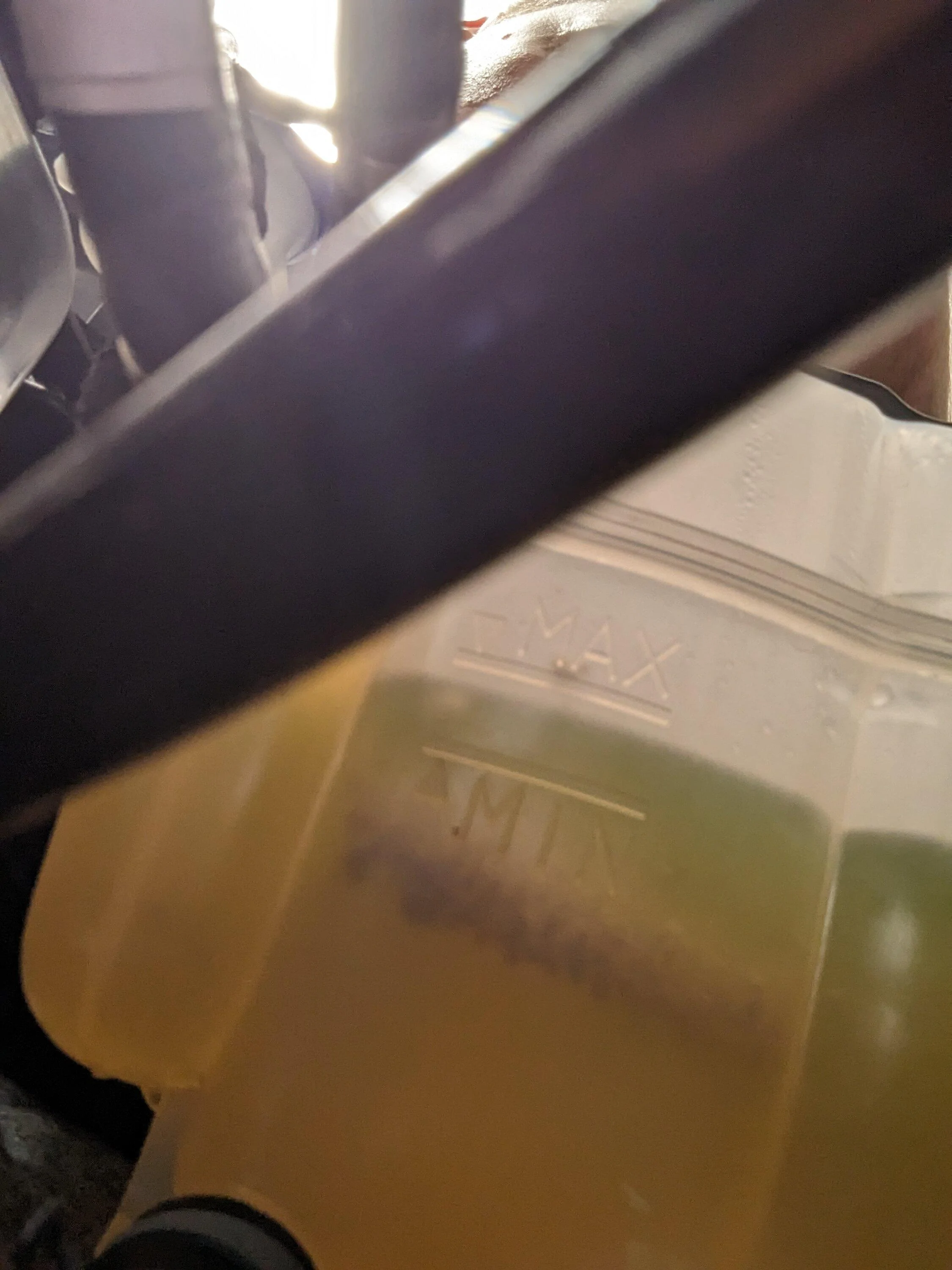

Anyone have any idea on what this could be inside the coolant reservoir? It was definitely on the low side when I noticed this, it is inside the reservoir.

I’ll bump this. Mine is the same. Noticed it looking for a leak as I could smell antifreeze and the coolant was low (which sounds like a ‘normal’ thing). Mine has 12k miles

Even though things are new, it doesn't surprise me if there is some leftover debris in the cooling circuit. Hell, Jeep had a lawsuite becuase they were leaving so much sand in their blocks, it was clogging up the heater cores (a $3,000 job).
My Bronco also seemed to be loosing AF, so I bought a jug of the premix and kept topping it off. 15k miles now and it seems to have settled....air pockets maybe?

Looks like a little oil stain? It doesn’t look big or pervasive - I don’t think it’s the sign of a bigger issue. My guess would be some part didn’t get perfectly clean on install and some of the oil from machining washed out

Coolants are getting complicated these days with lots of various types/colors which don't mix. You have to be careful about using the right type of coolant
For sure..and what is worse, the color doesn't mean squat! Not all Yellow/orange/rainbow Antifreeze means the same!
When in doubt use distilled water to top it off that 1st time..but after that, just buy the Motorcraft stuff so you know it is right.
The first dealer I took it to was not concerned and said there was no leak. I have been monitoring it for months and it has slowly been lowering. The second dealer indicated the water pump was leaking. Its getting fixed now hopefully.
What year is your Bronco? I started noticing the leaking anti freeze smell in my cabin a few weeks ago and it dawned on me to check the reservoir after cleaning an already clean Bronco top to bottom for the third time. Mine looks the same, but even lower…. I have an appointment scheduled with a local shop, and not the same shop where I purchased the Bronco, which told me there were no leaks (despite the antifreeze smell starting to develop).
