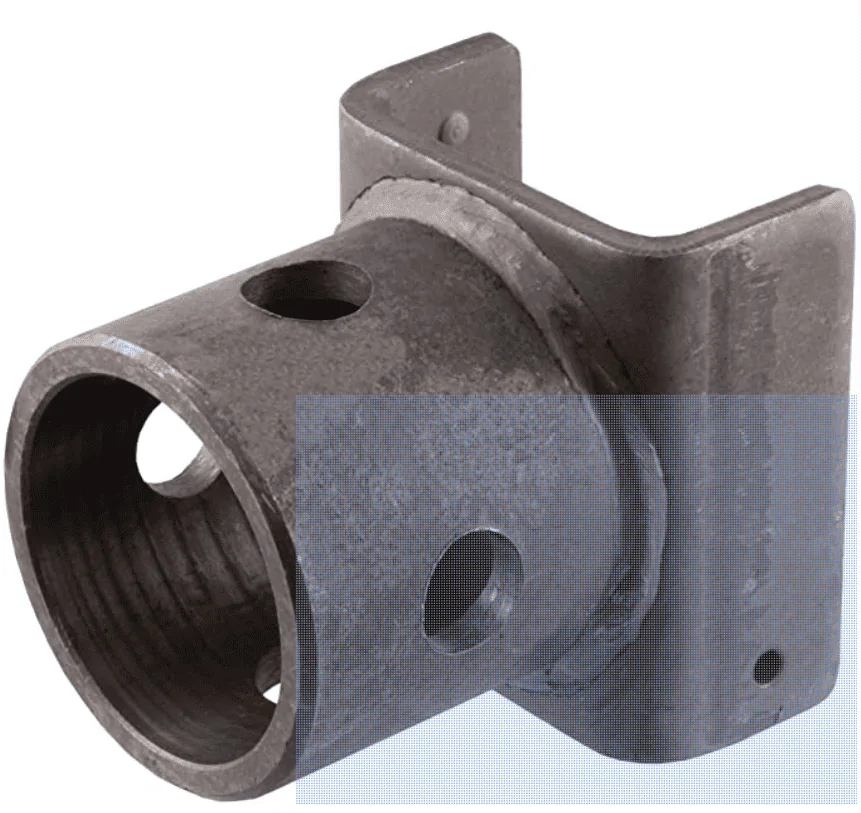

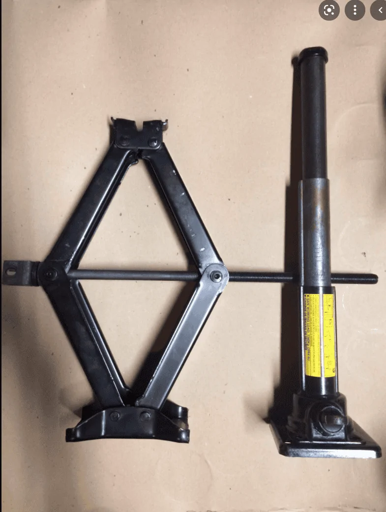

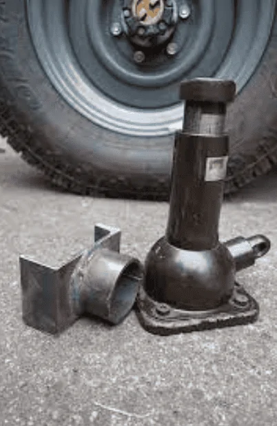

Instead, I'll be adding a geared bottle jack that uses the same crank as the scissor jack. They extend over 2ft, weigh almost nothing and take up very little space. Mine is rated for 1,800 kg (3,968 lbs). Get one from a wrecking yard, look in any the Toyota 4x4.
For the bottle jack, get a saddle or make your own, here's one for $12.
Amazon.com: CURT 28930 Replacement Swivel Jack Female Pipe Mount : Automotive

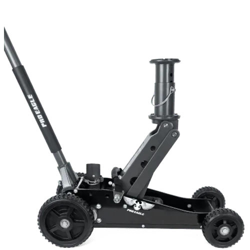

Most folks in the Raptor world, at least, view the Pro Eagle jacks as the ones to beat.
We use those for all our Raptor support vehicles... but the space they occupy is a lot, considering the limited storage space of the Bronco. Definitely a good option, but once you add the recovery gear and spares needed to support tours (which is our plan with our Broncos), space becomes a precious commodity!

The toyota jacks are geared so they never fail. I'll be keeping the factory jack but adding the bottle jack to stow under the seat with a lug wrench.
It's happened to me that I get a nail/screw and need to take off the wheel to plug the tire but the oem jack being under the cargo area I need to unload which is a pita. Happened last summer with my subaru and won't happen again!

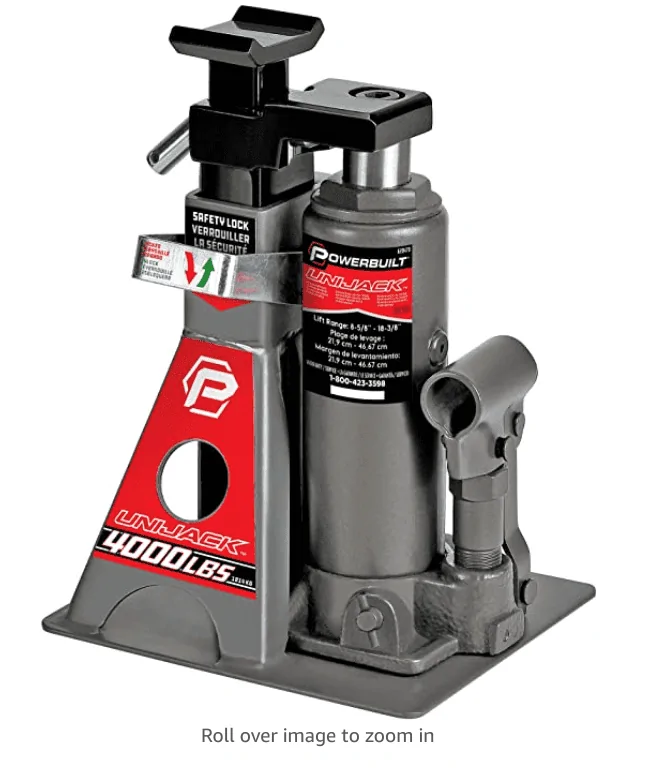

Those adapters wouldn't be safe for your floor jack.
Instead of a floor jack I'd suggest a unijack. It's safer for working under the vehicle.
You'd want to make sure which ever one you get fits under the frame. The 4,000 lb has a min height of 8 5/8". 6,000 lb has min height of 11".

I have been looking for a solid garage jack. But, do folks really hit the trail with one of those in their truck?
in Raptor with a mount in the bed...Yes. Would not do it in the Bronco. Way too big for the amount of room.
