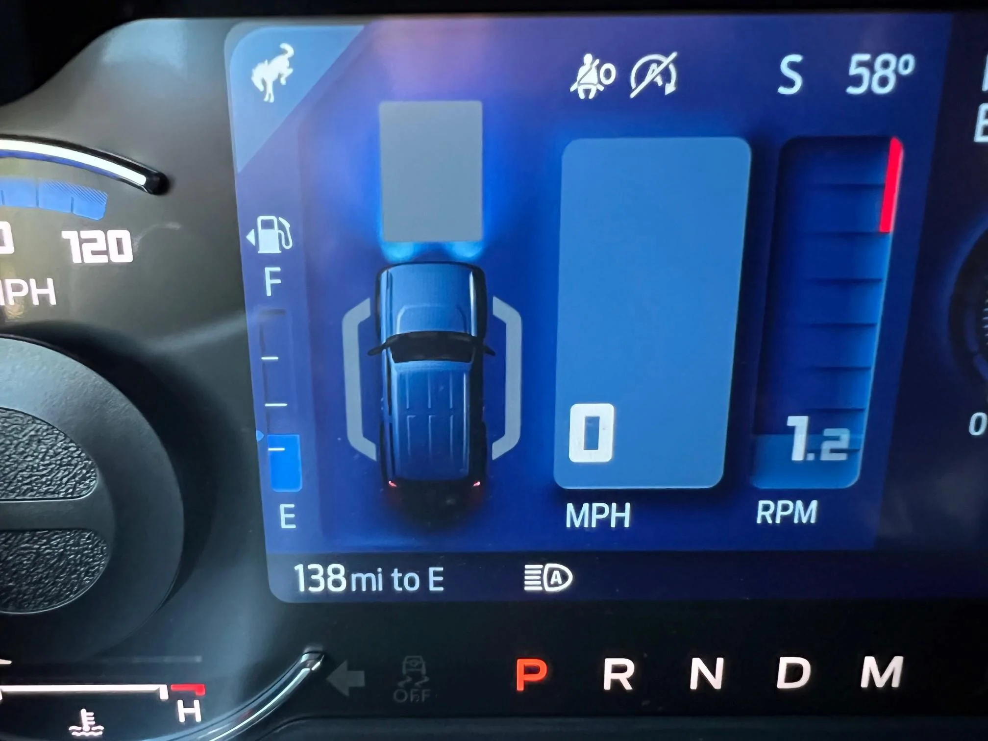

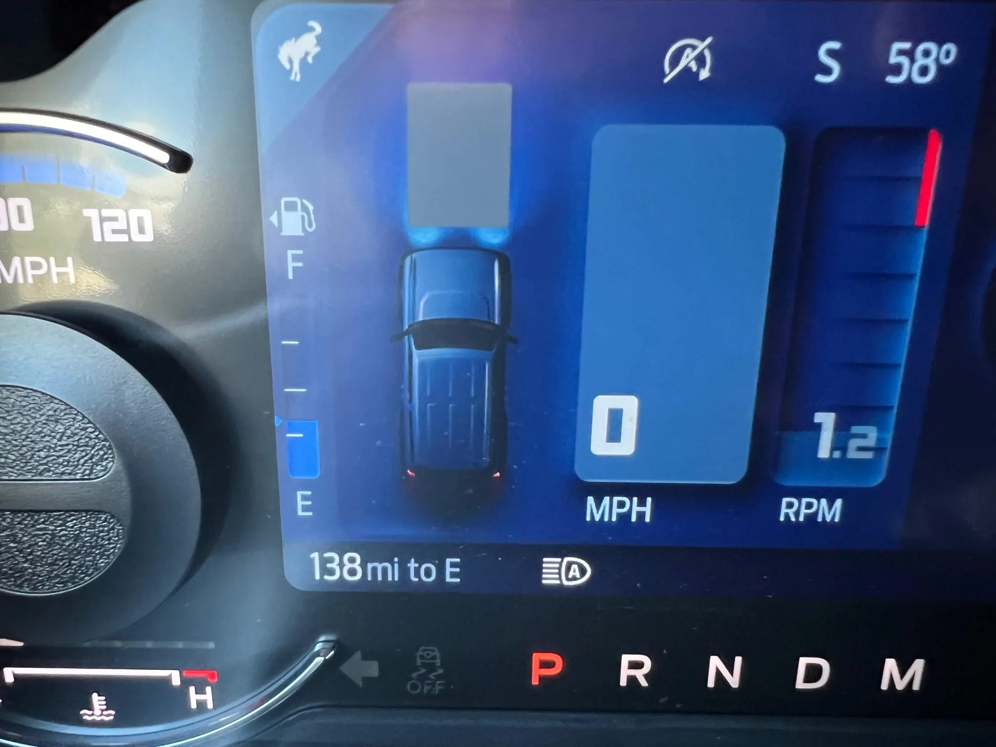

As mentioned the settings are in your sync4. I don't mean to insult, but I had to figure it out, the indicators on the dash [ ] helped me realize I had accidentally turned it off. The button next to cruise control is the on/off for lane keep. It will ding, vibrate, and gently move you back to your lane depending on how you have it setup.

Also, those [] need to FIRST recognize the lane markings by turning GREEN before theyll assist you.
Also, if it does recognize the lane markings and it turns red (which means its engaging the steering) and you hold the wheel and keep off-center, lane keep will temporarily DISENGAGE and stop working on that side. Just a heads up...
Probably not mentioned in the manual anywhere, but this is how it's designed. 👍🏻

@JaxGtc thank you! Was apparently user error. I had been selecting options using the Sync4 interface, but wasn’t aware there was a separate manual button on the steering wheel needed to actually engage the Lane Keep functionality. It works just fine now. Thanks again!
