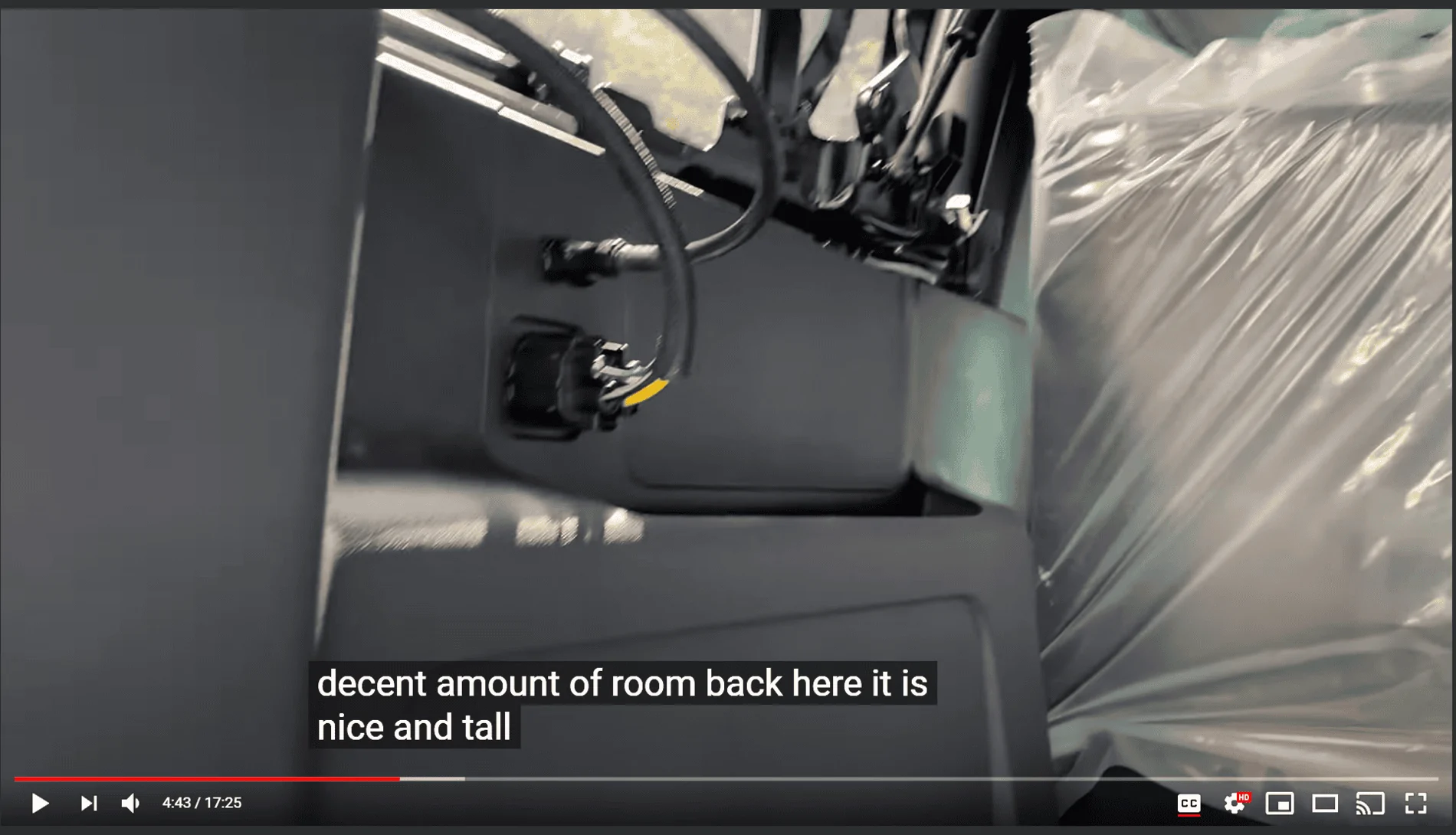

I was watching the video of the guy who got screwed by the dealer he used to work at for 19 years, and noticed these on the left side of the cargo area

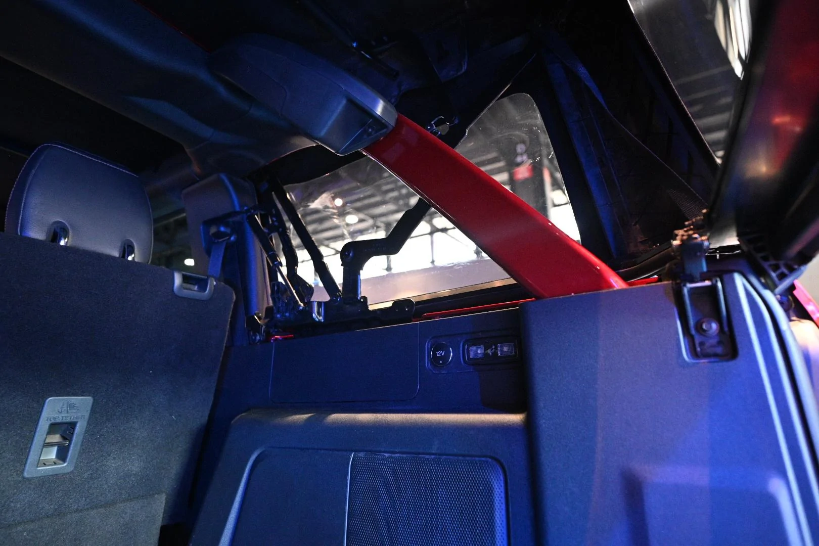

During the Chicago Auto show I crawled around the back of a soft top that was on display and dont remember seeing anything like that (pic below - didnt have a pic of that side of the cargo area - but i here is the other side). Pic for proof that i actually did - and who doesnt like pics anyway?
Anyone know what that stuff is on the first pic? Is it the HT prep kit?

Those are the electrical connection for the rear window wiper & defroster (lower connection with visible wires) and the hose for the rear window washer fluid (upper connector), plugged into the storage sockets on the side of the cargo bay, since the soft top is installed instead of the hard top. The entire hard top prep kit also includes the dash controls for those items.
