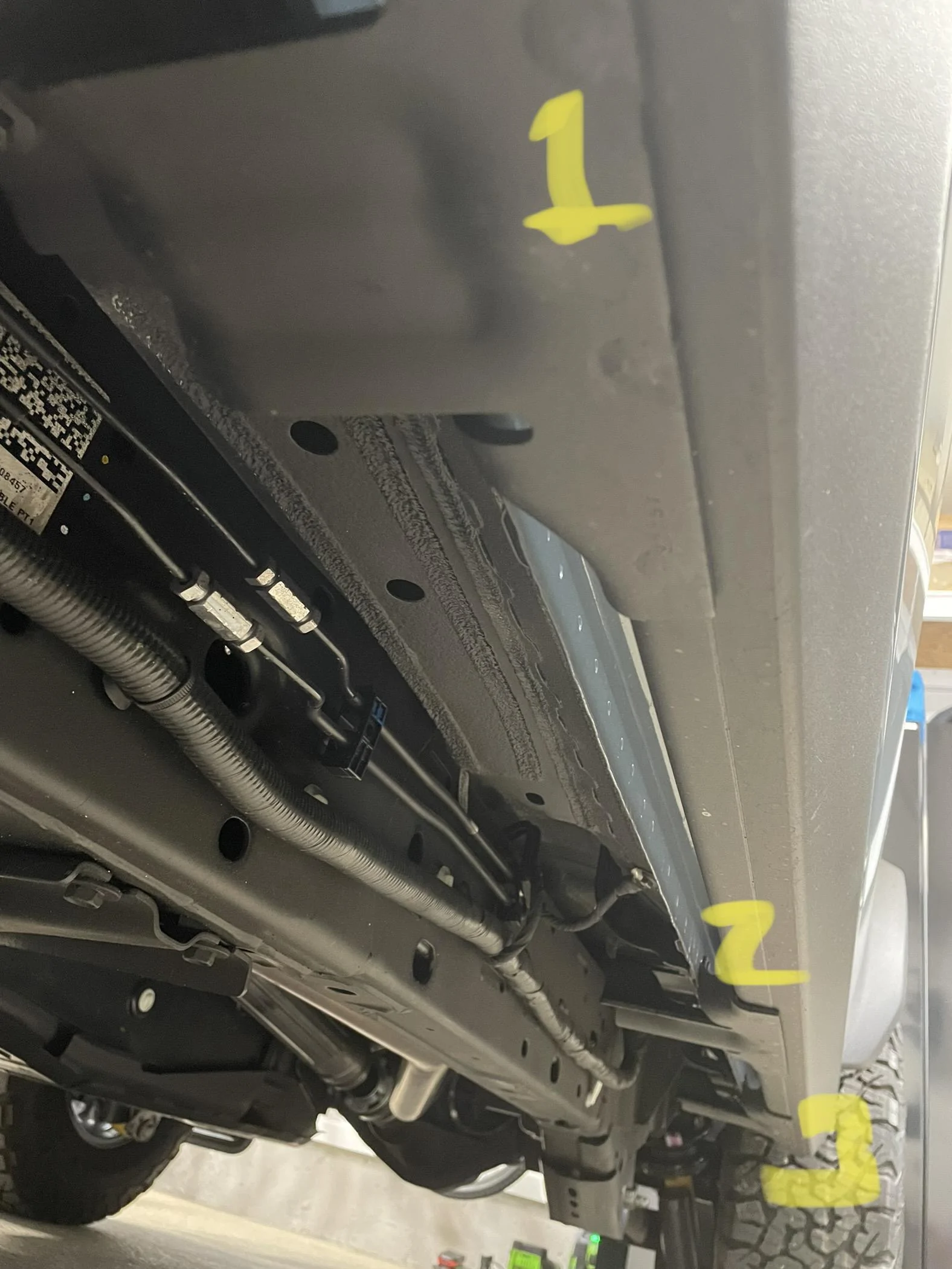

Hey, if you have a 4-door Bronco, then you’ll need three (3) brackets each side. (Attached a photo from my Badlands to show them.)
Ford Bronco Is this the correct brackets for Rock Rail? 9914F441-93D5-4486-B840-49996C9BE594
