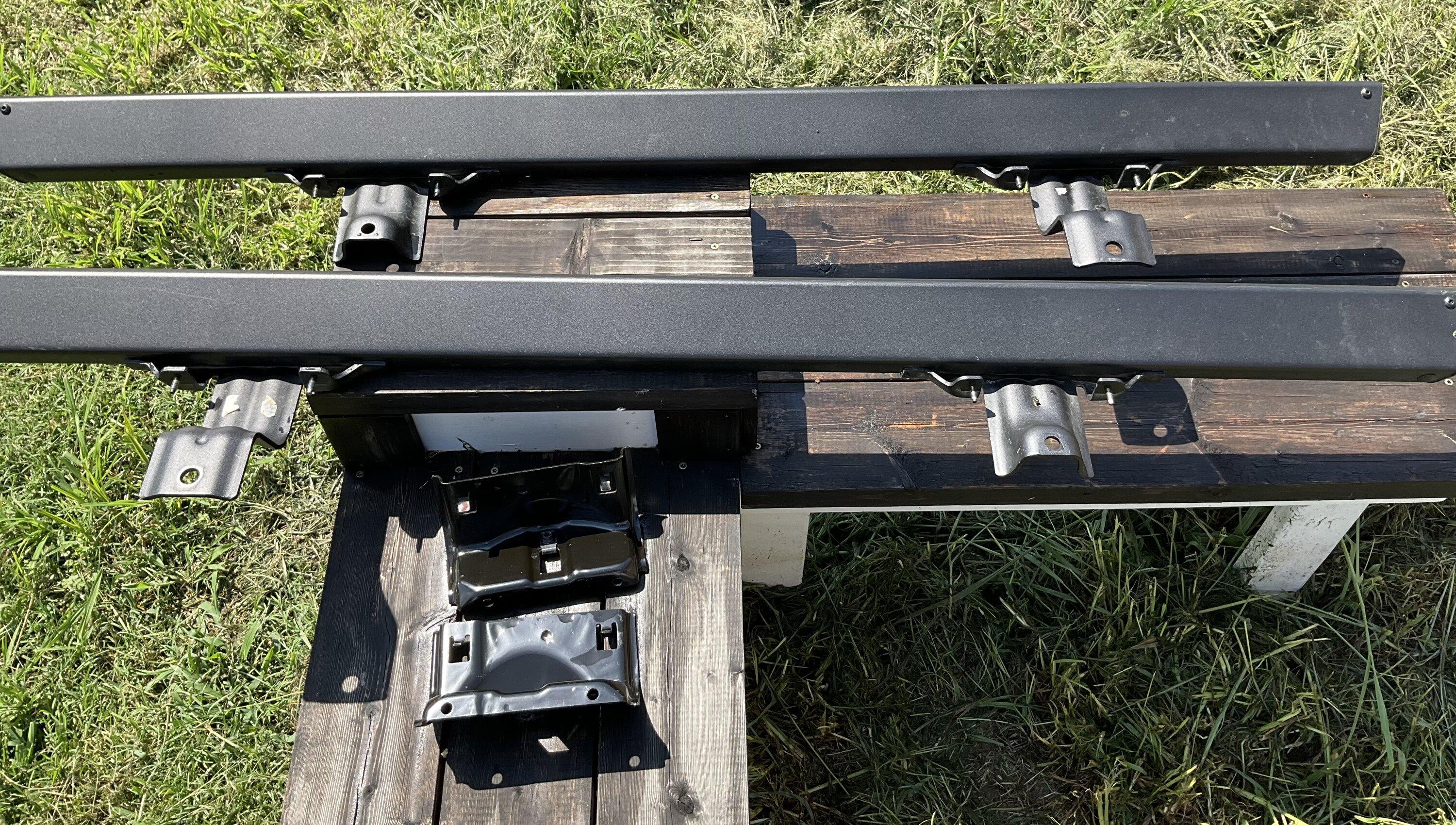

Hey, if you have a 4-door Bronco, then you’ll need three (3) brackets each side. (Attached a photo from my Badlands to show them.)
Ford Bronco Is this the correct brackets for Rock Rail? 9914F441-93D5-4486-B840-49996C9BE594

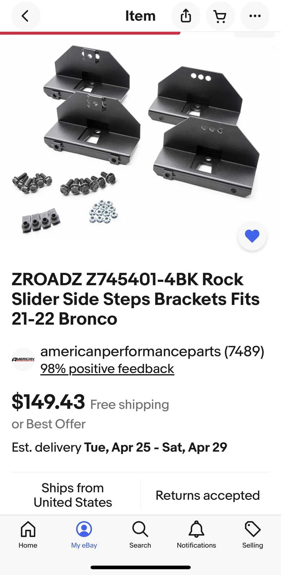

I received a set of Ford Rock Rails for my friend for my new bass bronco four-door. However it didn’t come with brackets.
Is this the right brackets to purchase?
Those should work, but I cant say for sure from my set up. I had hoop steps and ended up taking off a pair( one on each side- the rest was mounted on the pinch weld) vs the 2 or 3 on each side that come with the Badlands/Black Diamond rock rails. I installed the Zroadz rock sliders that I ordered and a set of four brackets with them. I'm pretty sure at some point I did see someone in a similar situation as you use or ask the same question about the Zroadz brackets in the last year on this forum. I would recommend checking Facebook market place first though, you can probably find them or a whole set sliders and brackets for $200.
