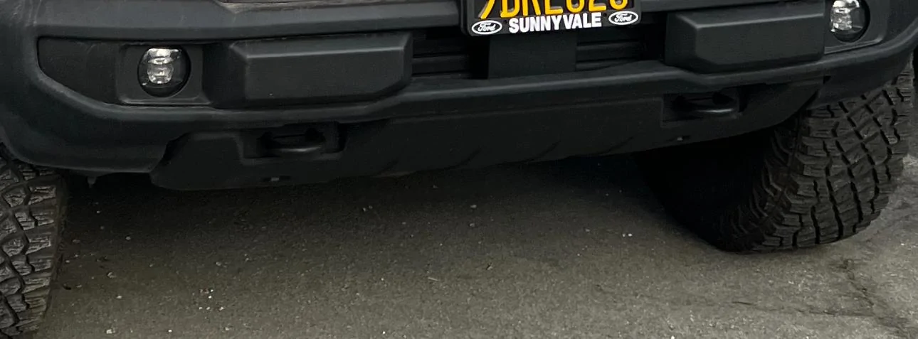

Here’s my bumper. Also I don’t see any sensors on it.

It's definitely possible to make the switch but you have to make sure you get all of the necessary mounting brackets. Not sure if he got an aftermarket bumper or what... but sometimes aftermarket bumpers have you re-use some of the factory brackets.
And also obviously you'll have holes where his sensors used to be.

It is pretty straightforward. Watch a video. Make sure you have the metal plate that replaces the plastic guard, and cut the tow hooks. 1-2 hrs max if you are taking your time. Also, mod bumper is way heavier, 2 person job.

I went from plastic bumper to a raptor bumper on my 2022 Wildtrak. I did a write up on this site. It was very straight forward. I ordered replacement supports so that I wouldn't have to cut the hoops off the existing supports.
An electric impact wrench and a someone to help you lift it in place, and you can do it in less than an hour, specially since you won't have to take the bumper apart to run the sensor wires.
