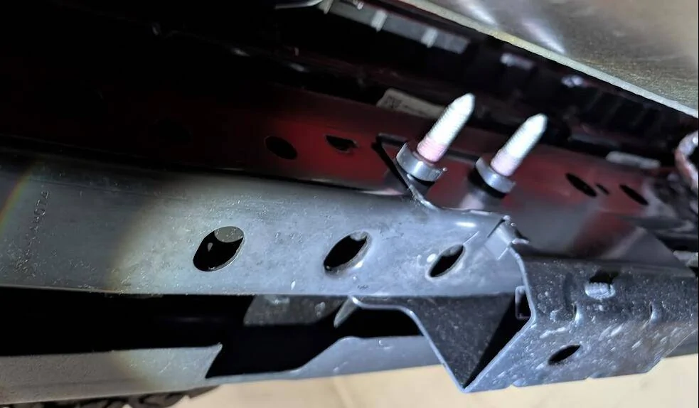

I JUST got my Curt hitch and went down to my garage with my tools and when I got underneath I was a bit surprised.
I knew the forum would have someone that ran into the same issue.
Thanks for the post!
To be clear, this is the problem right? It seems so excessive for just holding a harness. Also odd to have a harness and no hitch.
I have a 24 Badlands non-sasquatch
Yes sir. That’s exactly it. Take the bumper off and it will be way easier.
