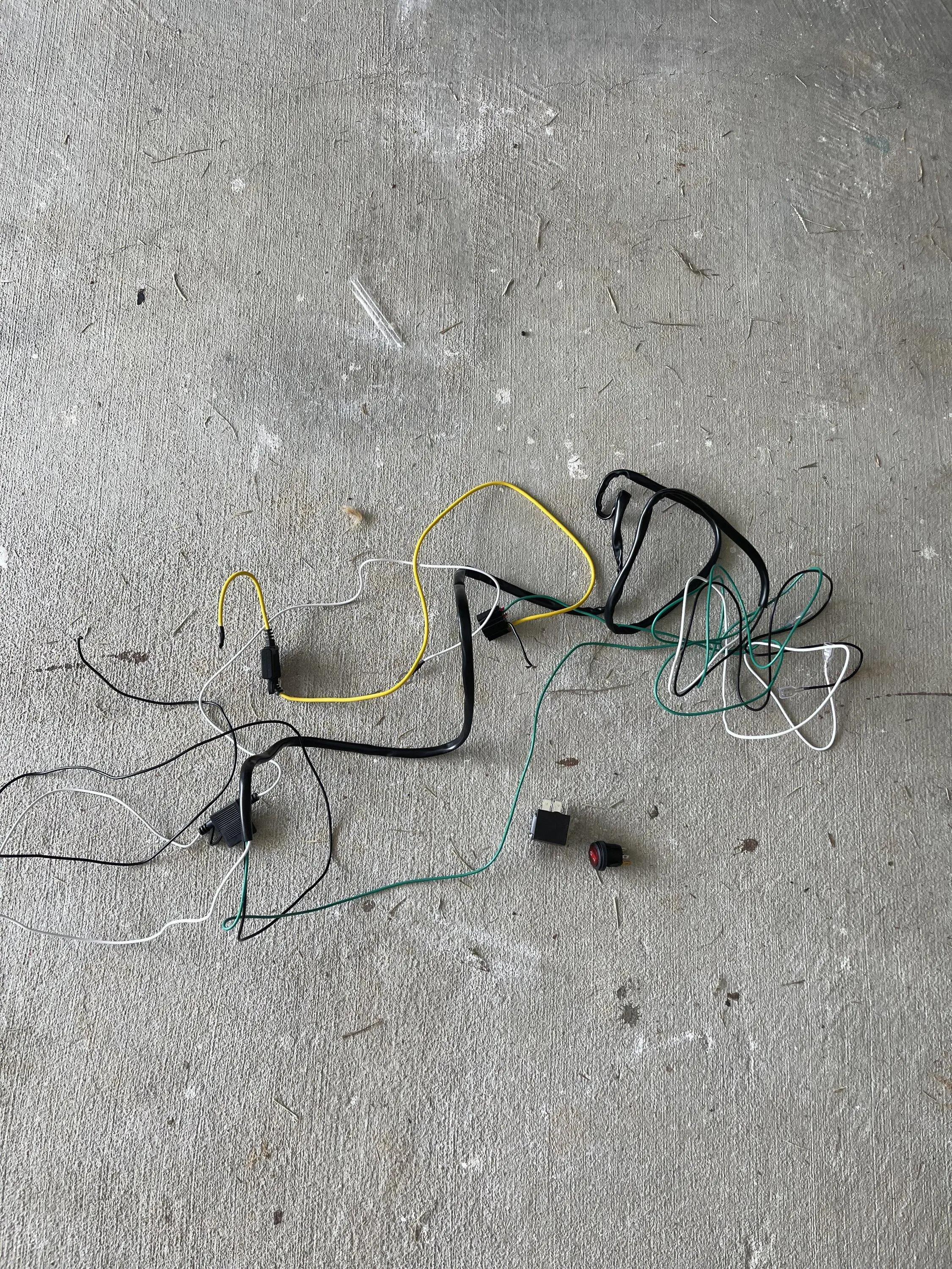

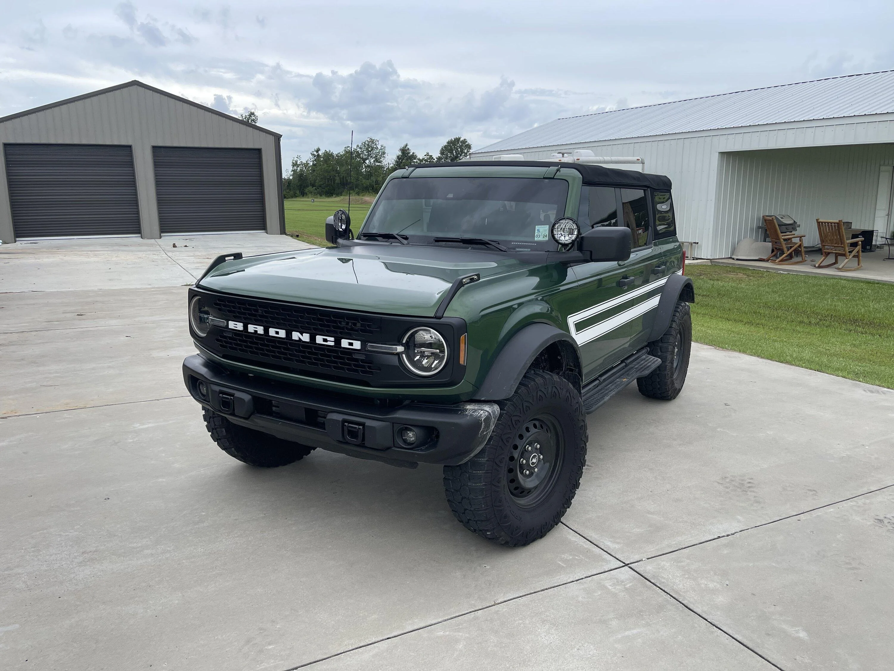

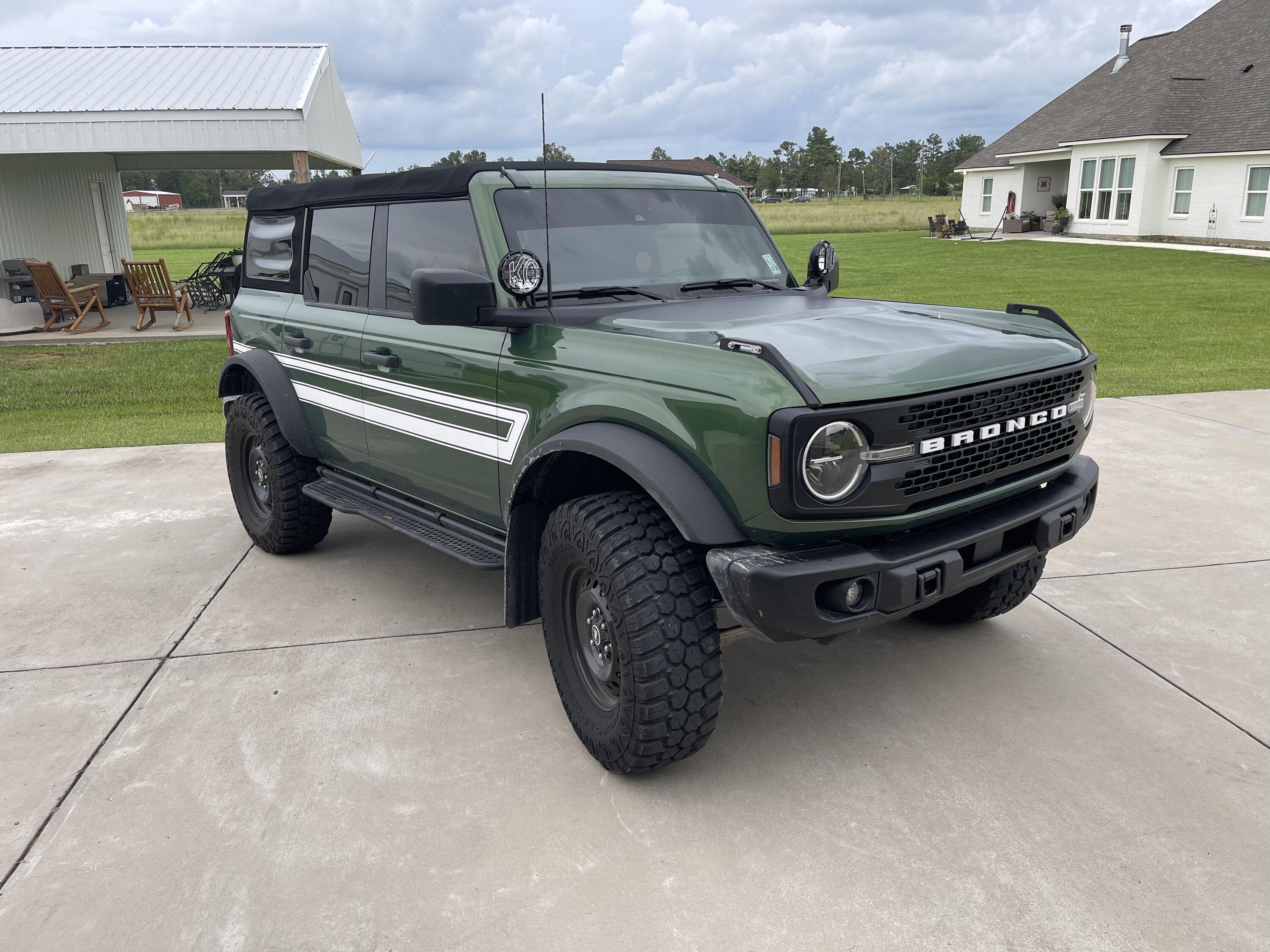

Incredibly simple using Bronco upfitter switches!
You literally cut off half of the wiring harness, and you don’t use the relay. Simply tie the 2 red positives together to the preferred aux switch wire by firewall; and attached ground to the point right next to it. So fast and easy! No fighting getting things through firewall is amazing.

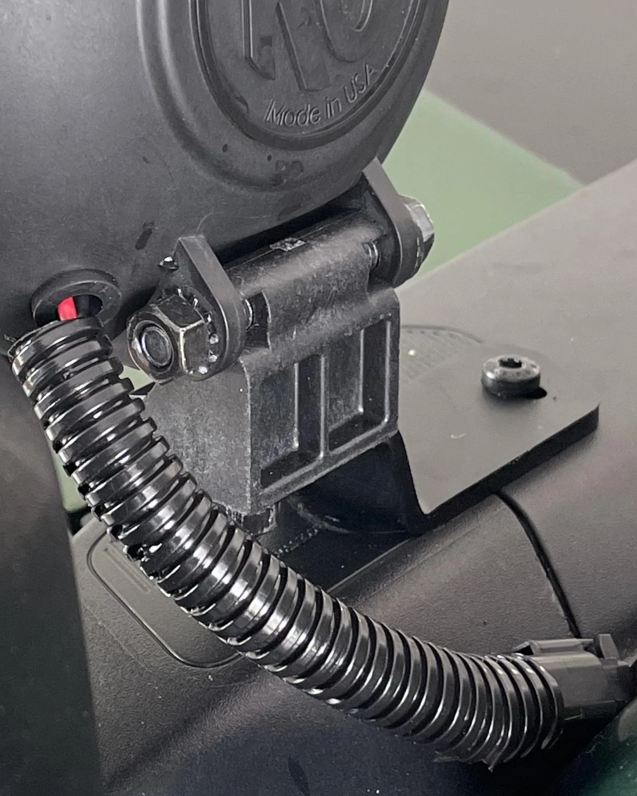

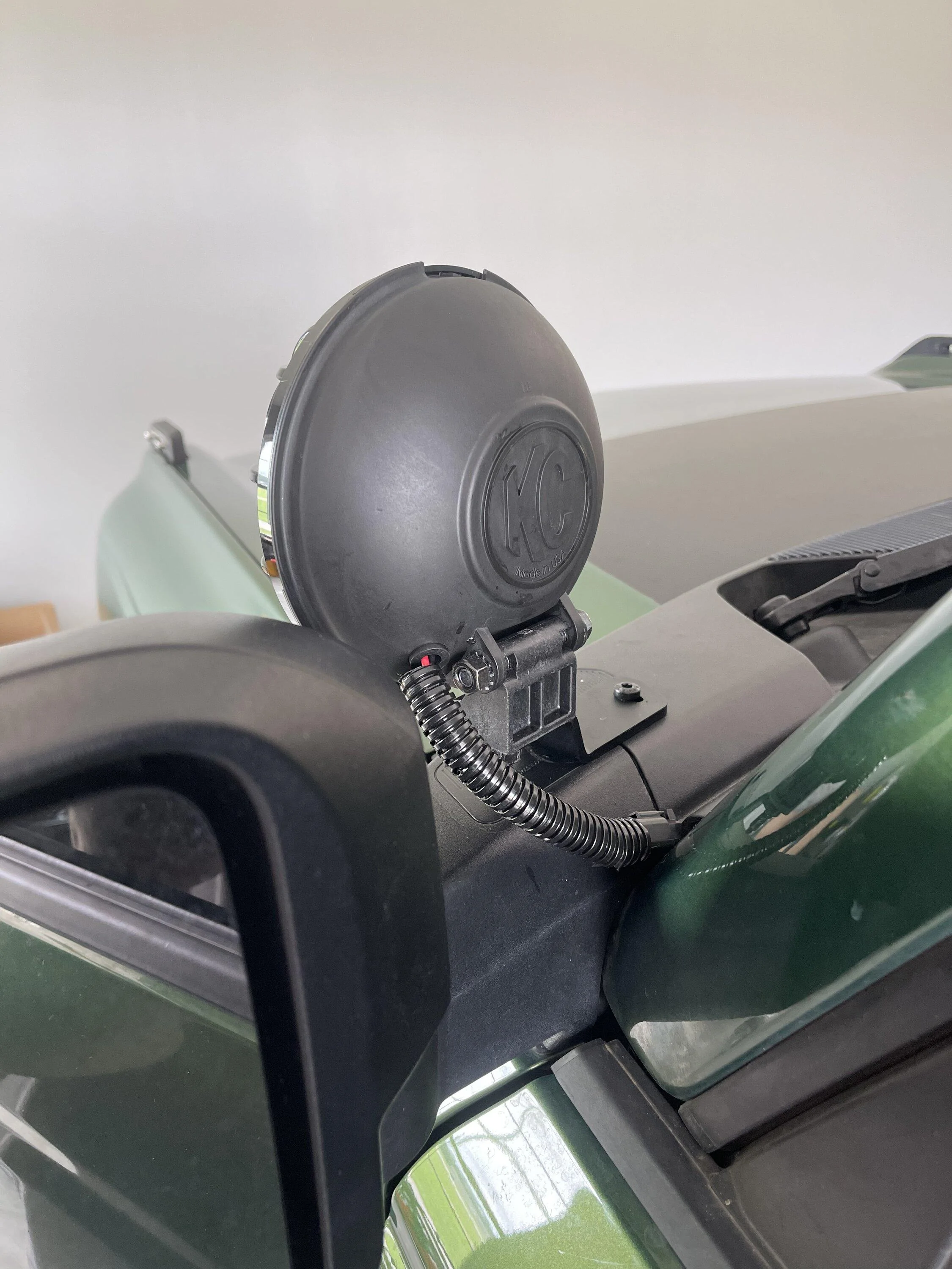

Had some wire cover laying around and covered the wires behind the lights with it and it turned out great!
Part of harness and parts I didn’t use above ^

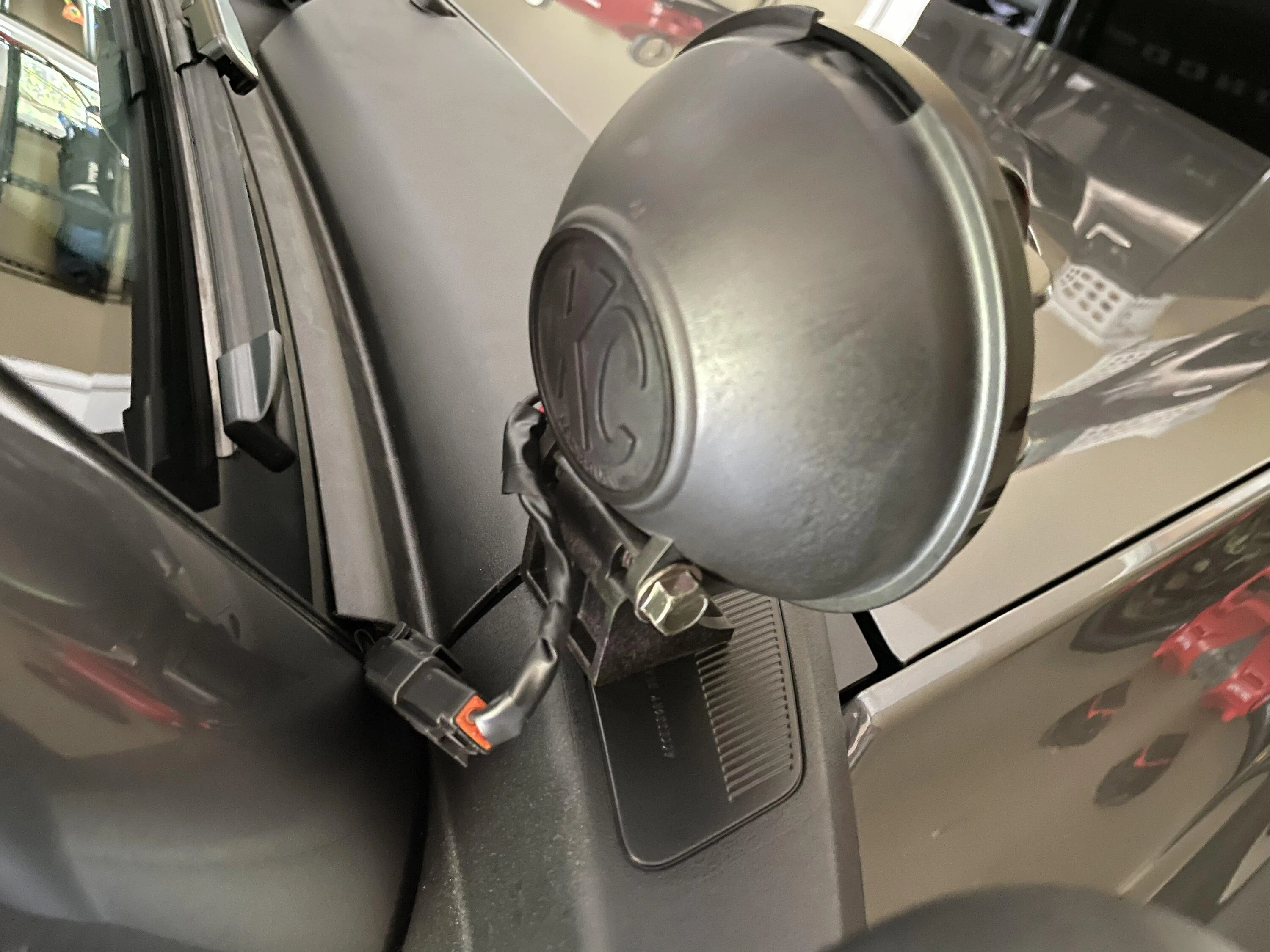

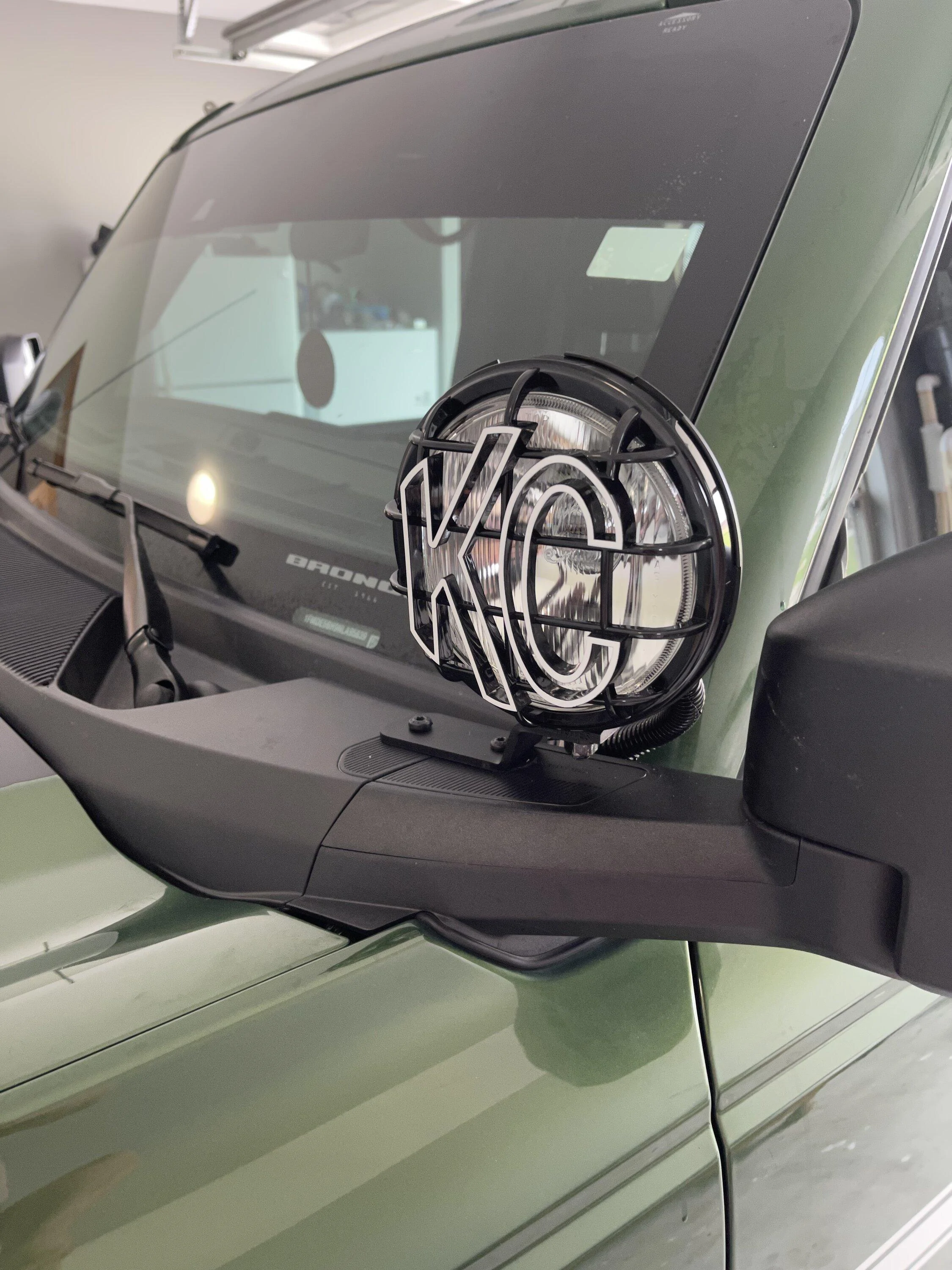

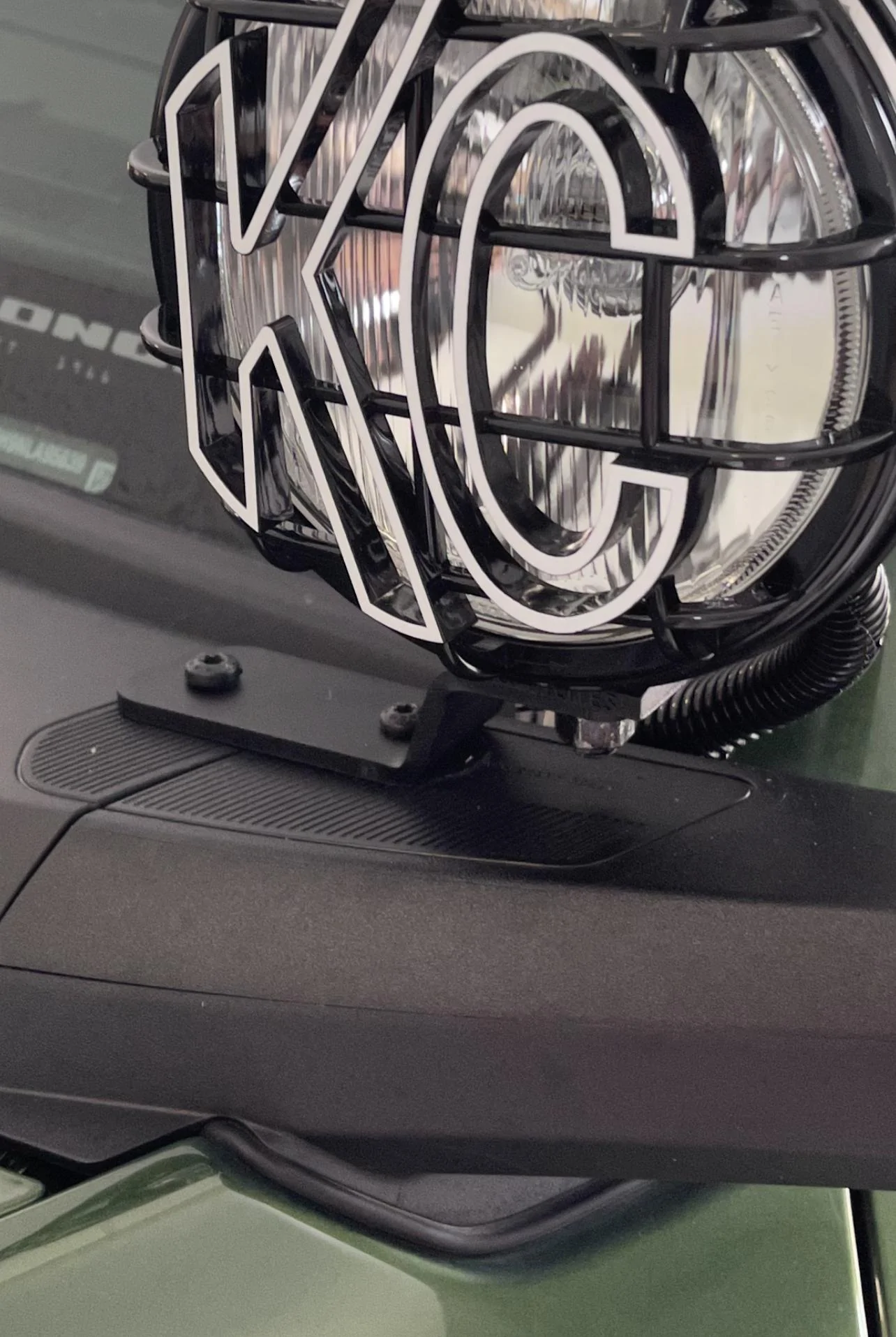

I just picked up these lights. What is that bracket mount? Light kit didn’t have one. Thank you!
Why remove the relay? I just got a set of lights that have their own switch with a relay and I’m trying to figure out how to only replace the switches.
Ditch mounts by KC. I actually still have a brand new set in the box I’m not using.
These lights didn’t require relay when in use with upfitter.
Thank you. Actually, after I asked you on here, I found them on Amazon priced at $60. I went to the hardware store and bought a $20 piece of steel and some paint and made my own pair.
Yeah I was gonna say 30 shipped they yours to get them out of my garage lol. Don’t even have a bronco anymore 😂
Ha! I appreciate the gesture man. The other night when I came home with the lights, my buddies were just like “why don’t we just make some brackets?” For what these things sell for at market value I gotta just start a bracket business lol.

Which aux did you plug it into? I tried to did the same thing and connect the two red wires to a 10 amp aux, but it seems to burn the fuse.
