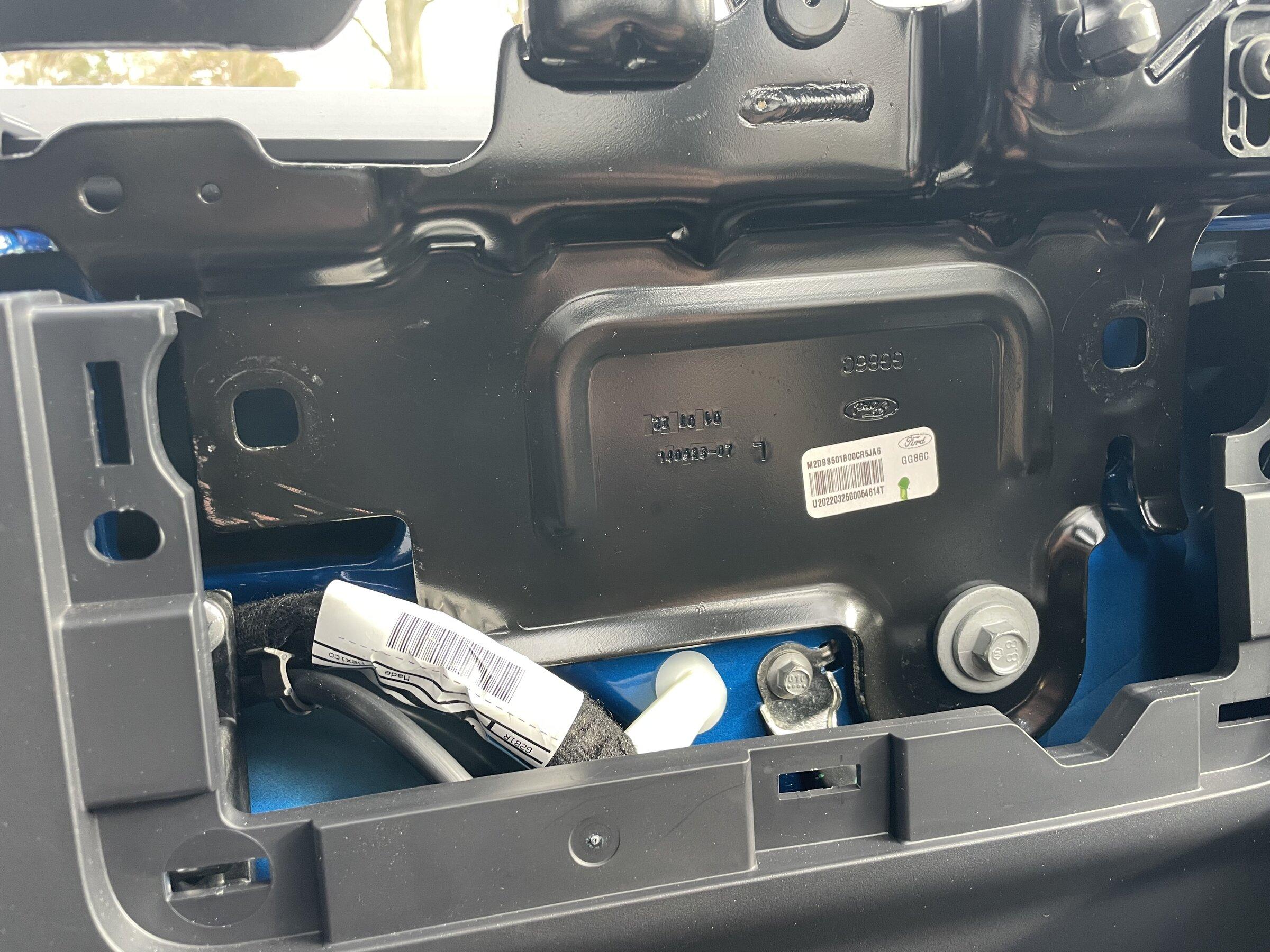

Trying to install a 2022 soft top on my 2021. On the rear mounting bracket on the soft top, there are supposed to be 3 bolts. There appears to be only one spot on each side. Am I missing a bracket?

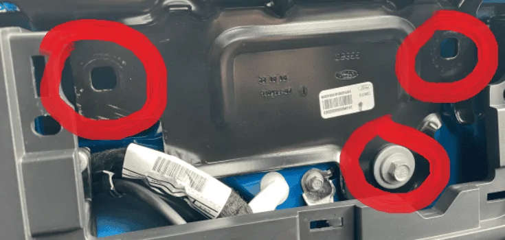

This where the bolts are on my 2021

Oh I don’t have any alignment pins here.

Yup your missing the brackets with the alignment pins. The top sets onto the pins and self aligns.

Also your trim panels won’t fit back on until you trim them down. And there are plastic trim parts that hold the side windows in that you need.
