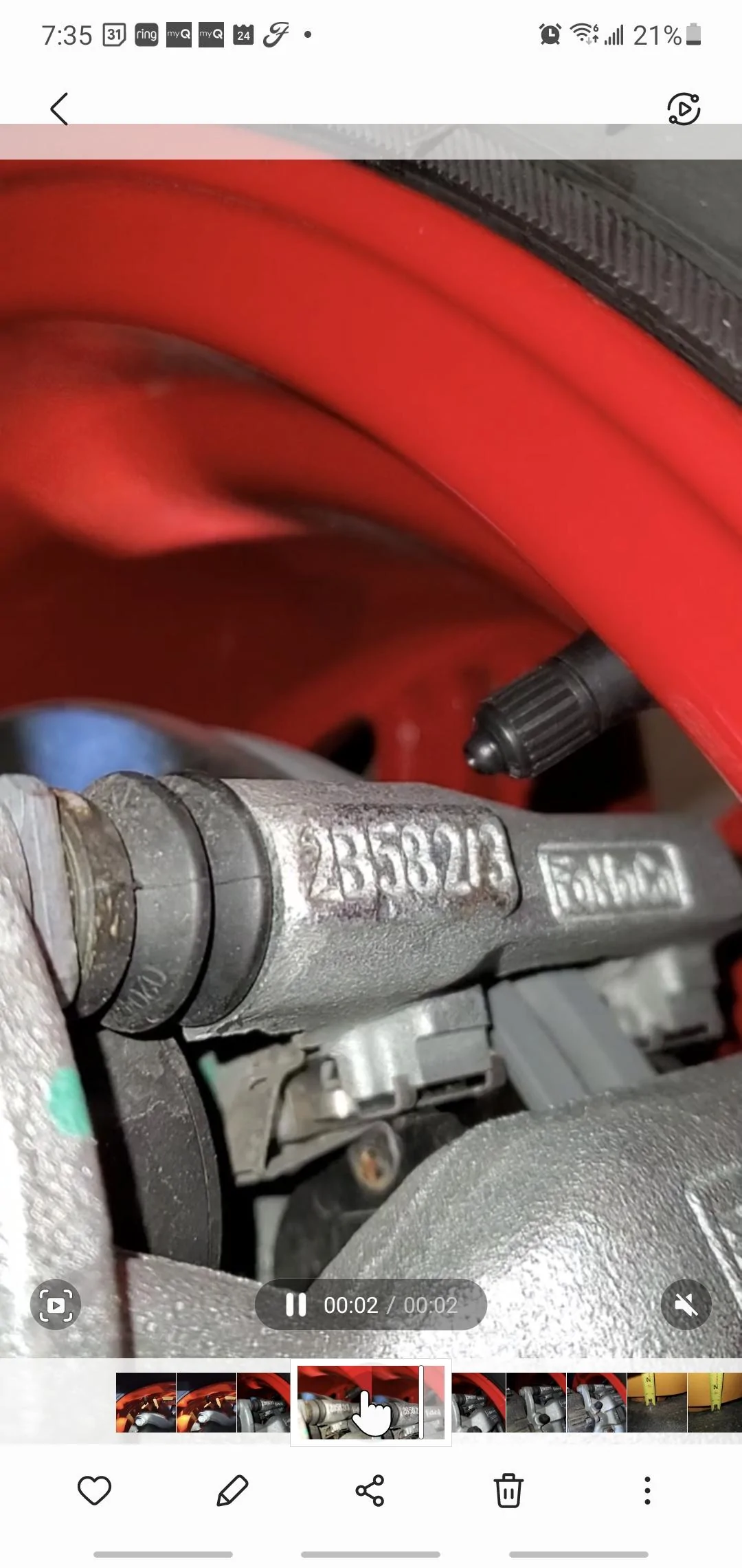

Does anyone face this problem when upgrading 17 inch wheels?
The Inner valve stems are hitting wheel calipers for 17x10 -12 offset.
This cause valve stem failed and tire flat
Fortunately discount tire has smaller valve that we can use and save the wheels.
But i think the gap may be too close.
I am afraid if the wheel alignment change or hitting pot hole, will this move caliper close to the valve stem and flat the tire again?
Is there any better valve to close this inner valve for good?
Here are some pictures for the gaps between calipers and valve stem
