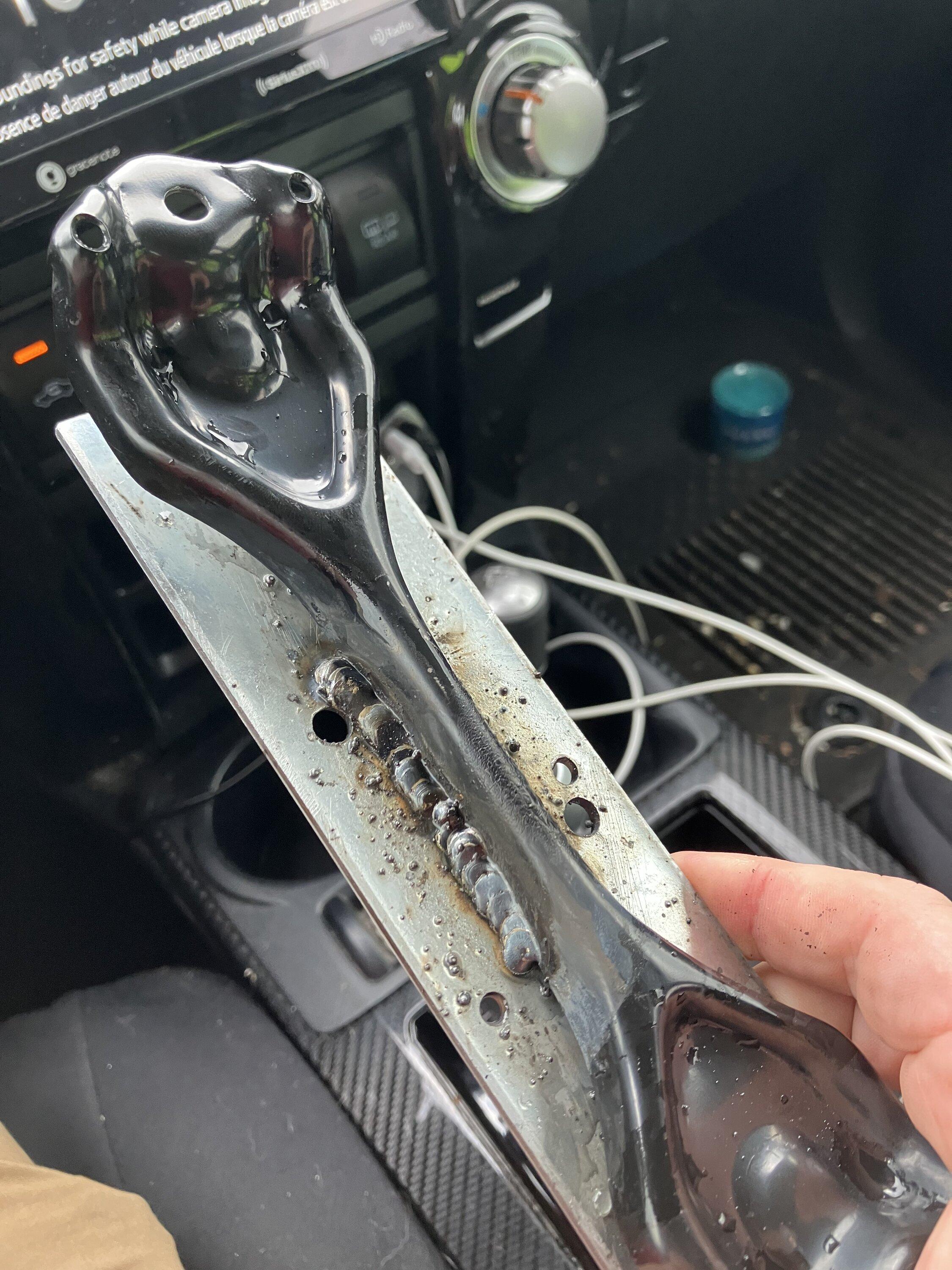

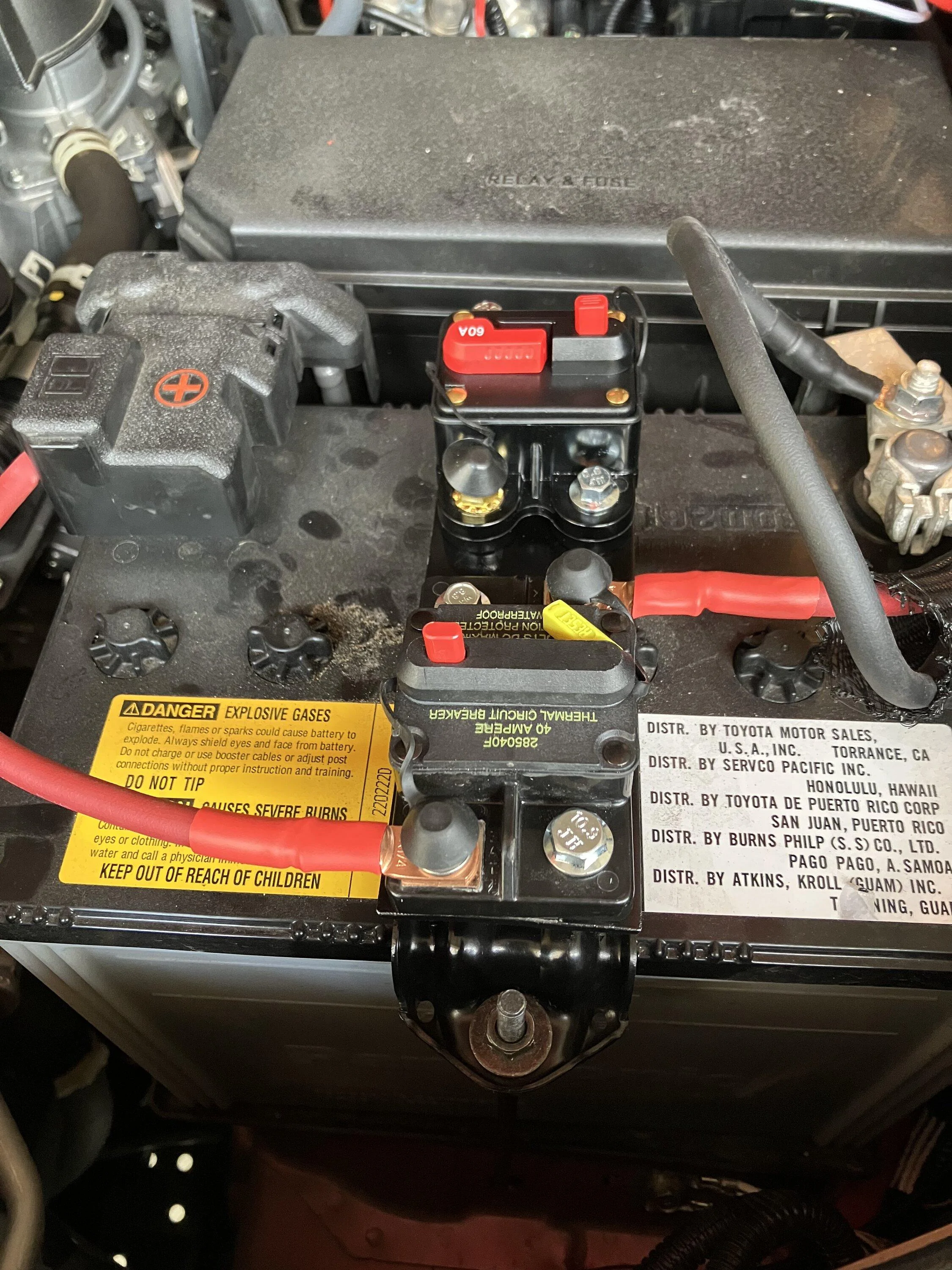

Get them. While I was able to get everything needed for under $200, it's still a pain in the ass doing it the right way.
60A breaker to an 8 gang fuse/relay distribution panel to the switches. Then a 40A breaker to a relay to another relay for the air compressor since the fuse/relay panel only had terminals up to 30A.
I don't fully hate it because I'm an electrician and I don't dabble much in small electronics like this so I'm learning, but I'd still rather not be sweating for half the day.

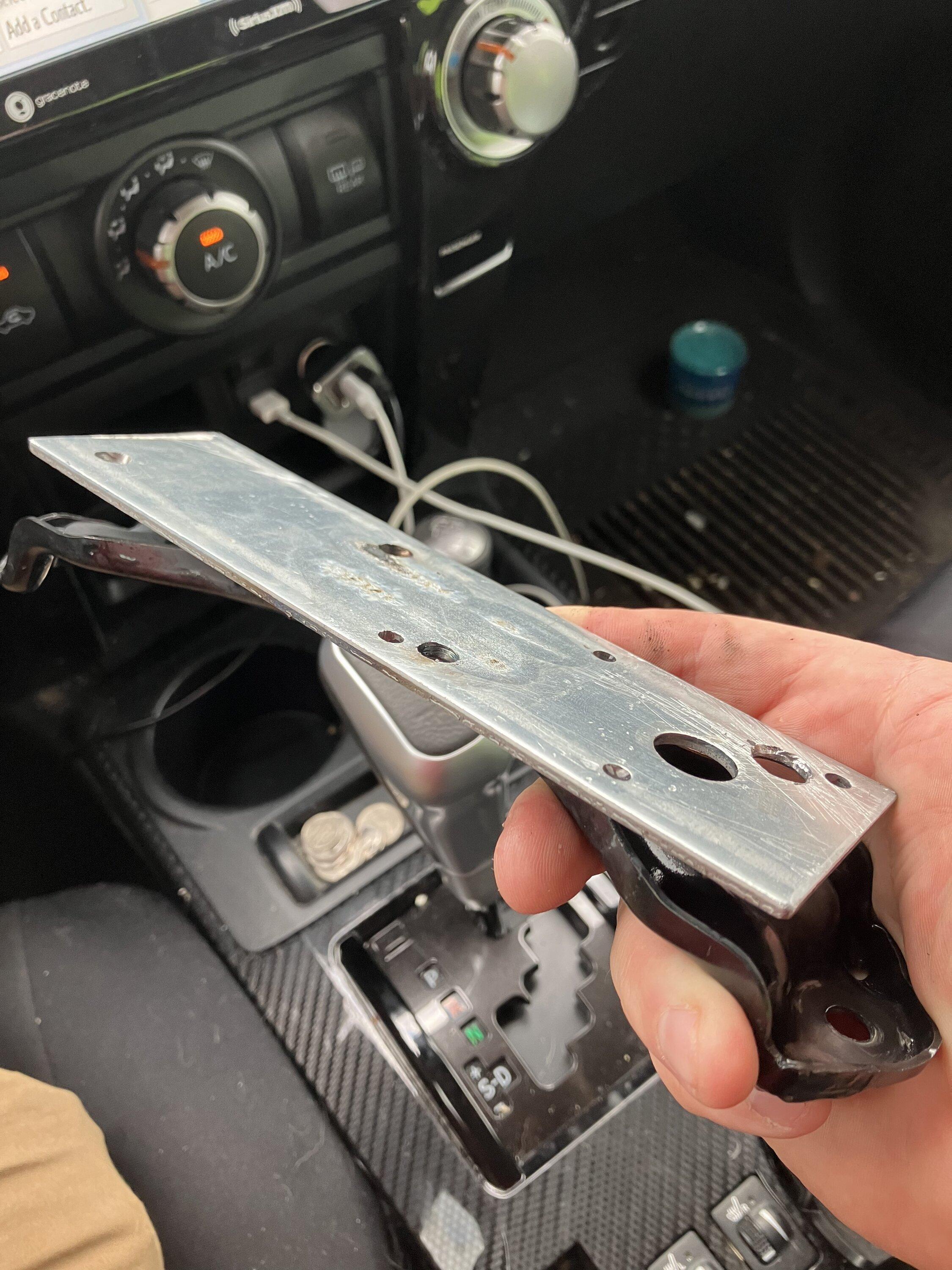

Oh and I took a flat piece of steel from a bracket and welded it to the top of the battery hold down, spray painted high temp paint, and it makes for an excellent mounting position for breakers. Before spending money on a nice aftermarket mount, consider this because it looks quite nice and is ideal in placement as it as close to the battery as possible.

Looks like he welded a piece of steel plate to the top of the battery tie down.
