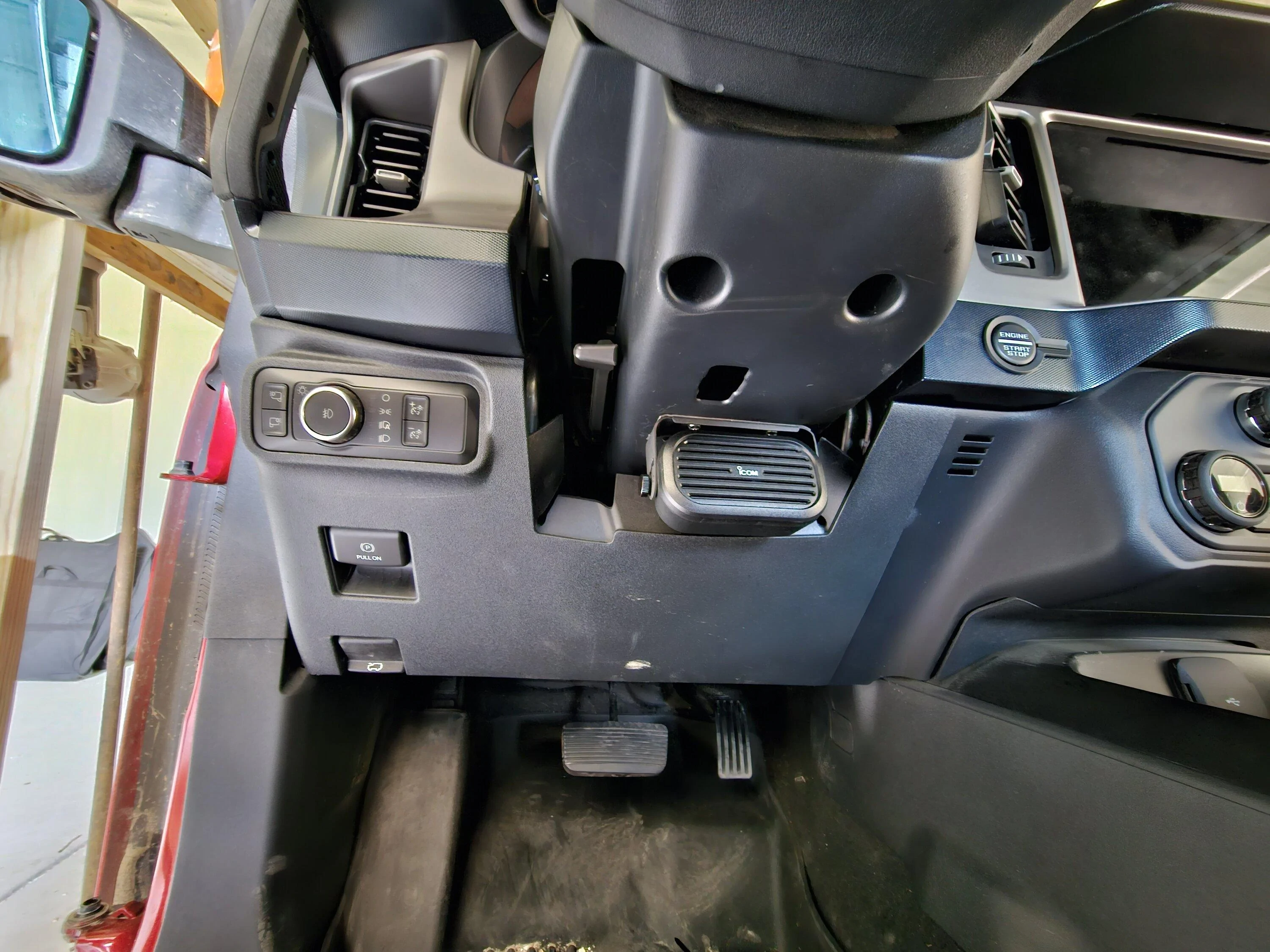

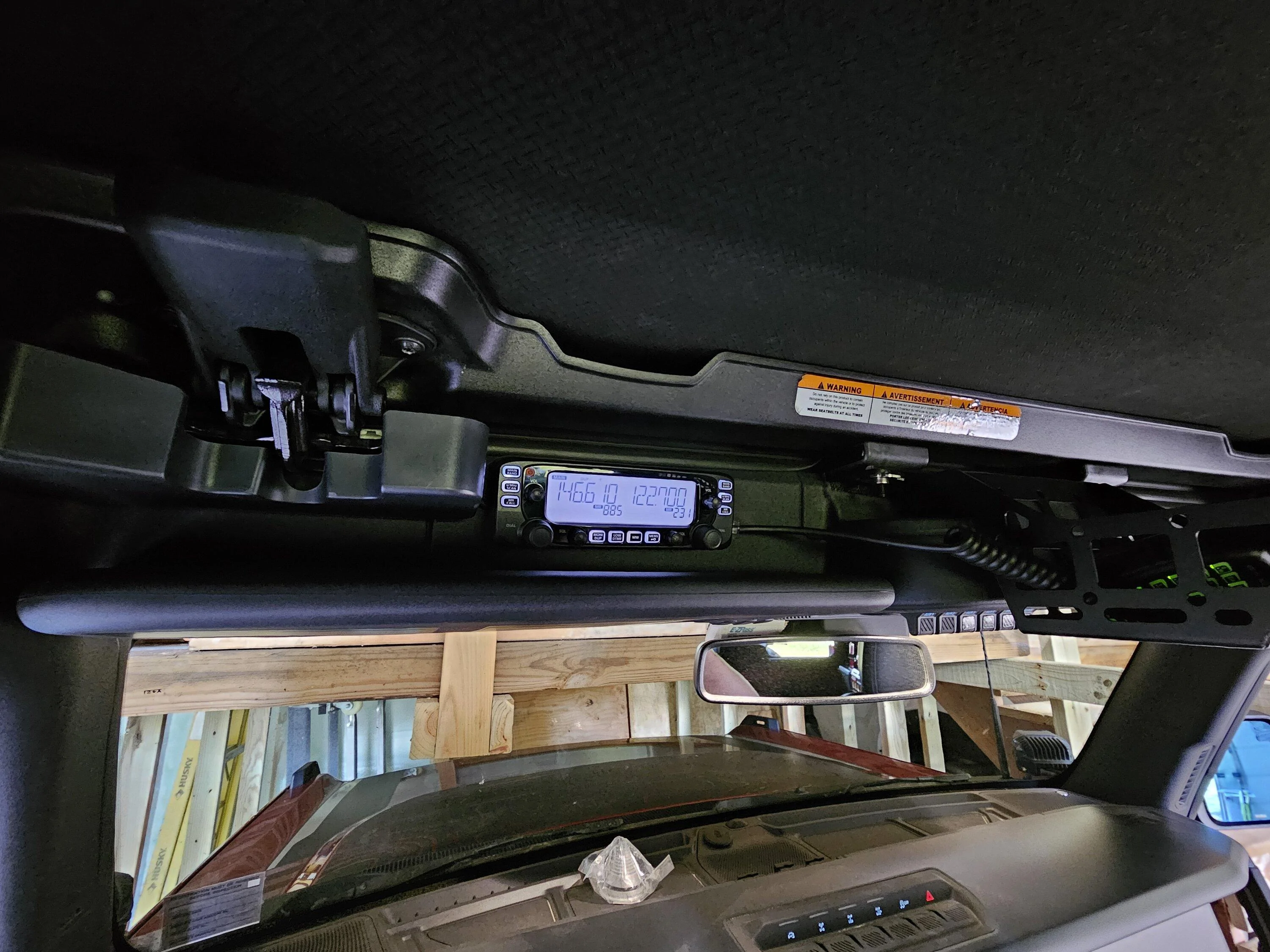

Just a thought, I mounted my 2730a above the Visor,
Ford Bronco Ideas for running a cable from the center dash accessory mount 20230423_154638
used the m2m radio mount to put the box above glive box (had to modify a little but works great there)
Ford Bronco Ideas for running a cable from the center dash accessory mount 20230318_145429
Ford Bronco Ideas for running a cable from the center dash accessory mount 20230318_145455
mounted a speaker dead center under the sterring wheel.
Ford Bronco Ideas for running a cable from the center dash accessory mount 20230423_154651
Really liked how it turned out.

That looks great! I bought the same speaker. I wasn’t sure where to mount it. I like your spot a lot. I’m sure you have no issues hearing it from there. How did you hide the wire from the head unit to the box?

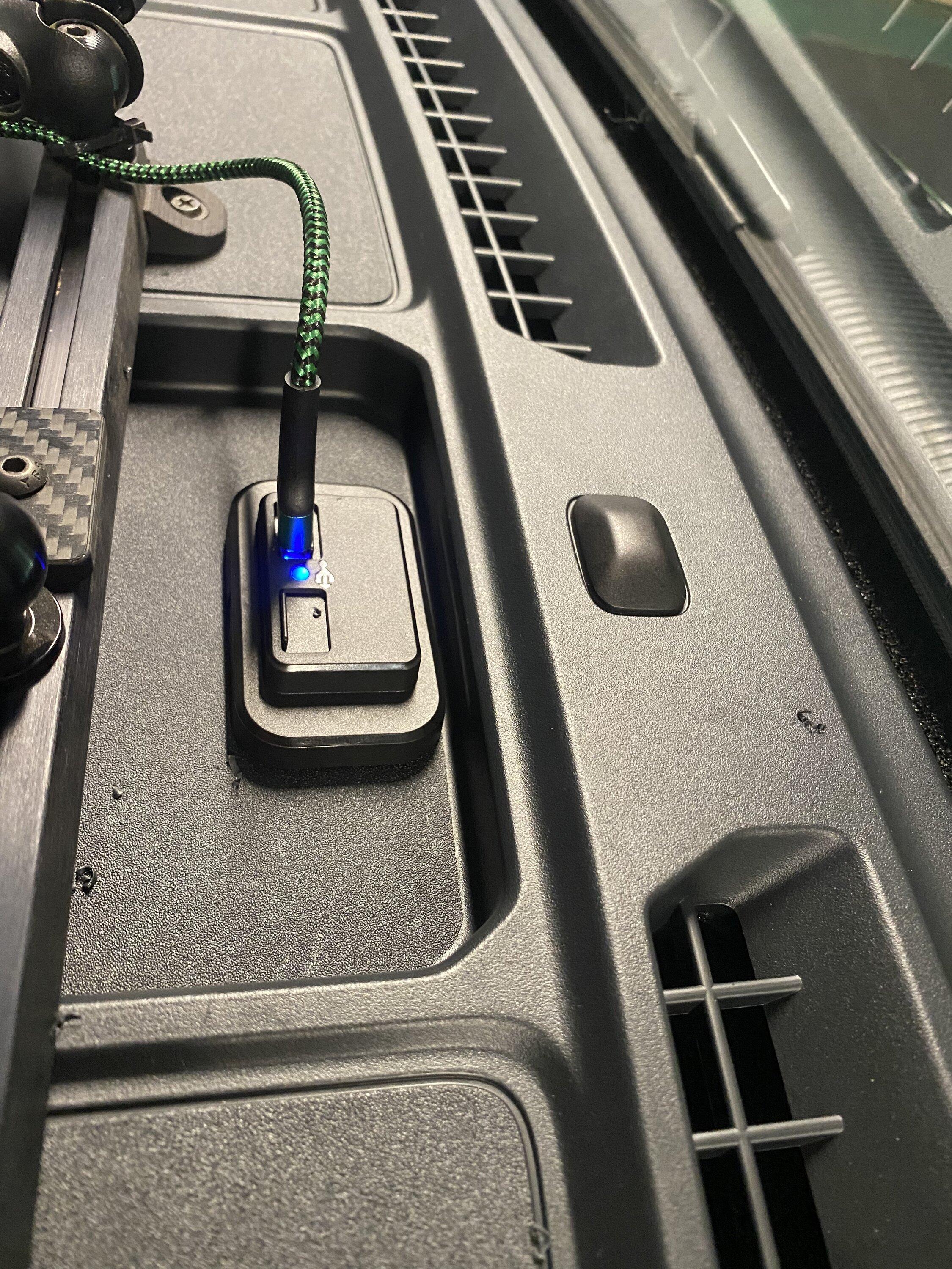

I’ve done this USB hub install on 3 different Broncos. There is a lot of space below where it’s mounted to drill and fish wire. When you fish it in aim slightly forward and toward the passenger side. It can take a little patience but you’ll get it into the glovebox eventually
Thanks for the advice. Your install looks great!
Speaker is in a great location, even for my bad ears!!
For the head unit to box i went down the A pillar. A little bit of a pain to fish but not to bad. If you get the instructions for the IAG lights https://iagoffroad.com/iag-4pc-inte...82mRXu8d-5jjJtZNz2Uyj9-ZqgpeMV7hoCyhsQAvD_BwE
it shows how to take it a part.
I also used M2M basket for the mic. Store it there and have the hook mounted in the side of the basket for when i am using it.
Let me know if you need anything else.

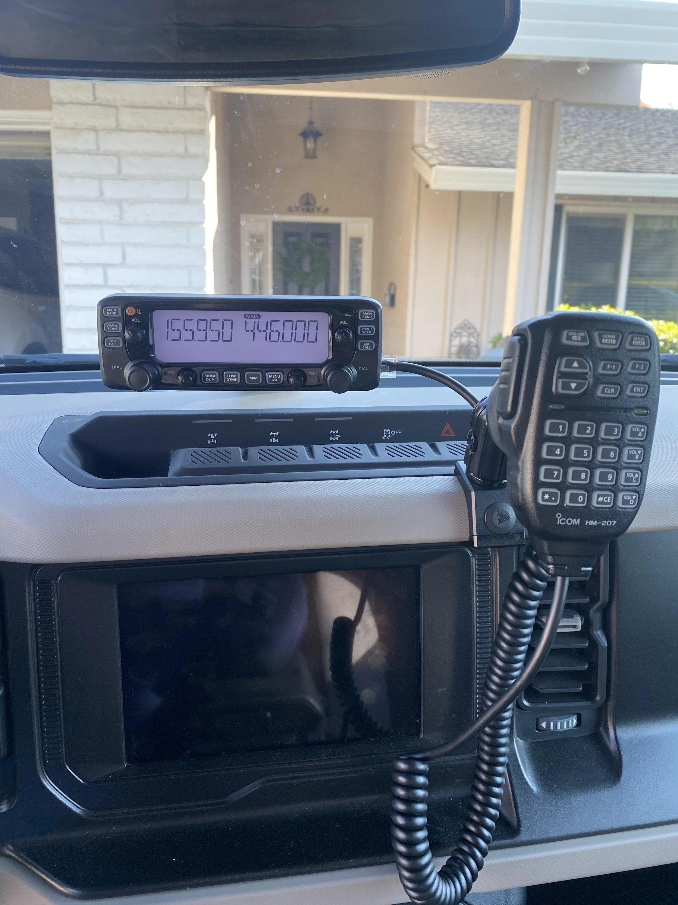

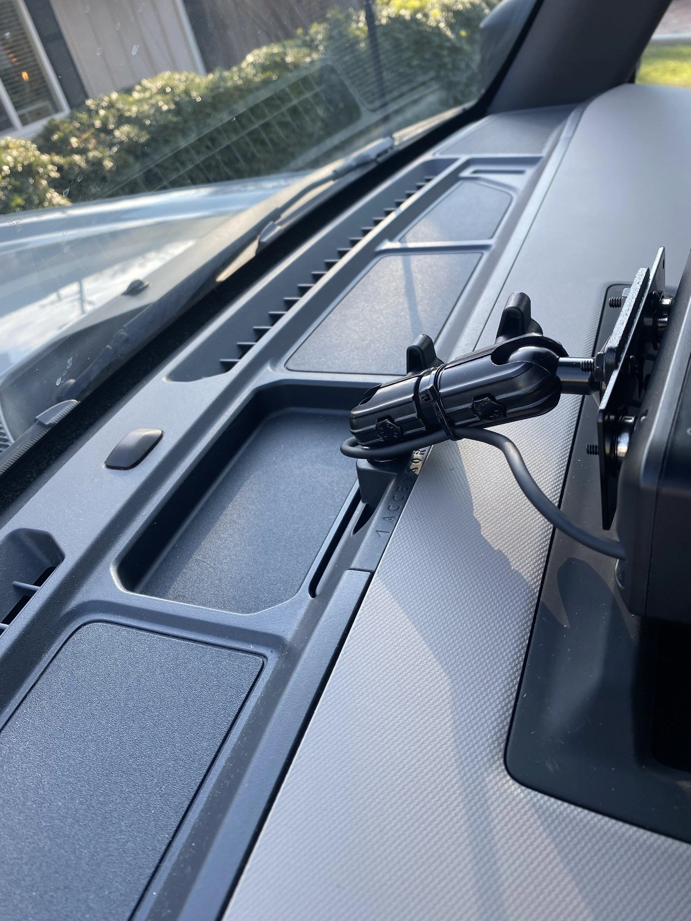

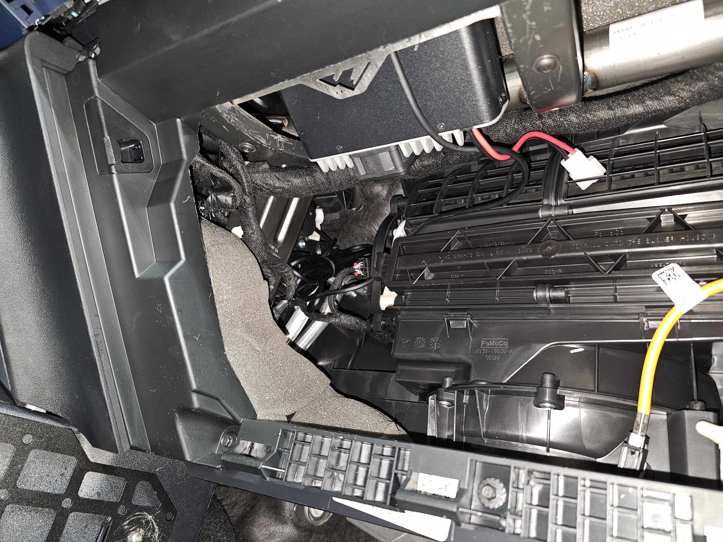

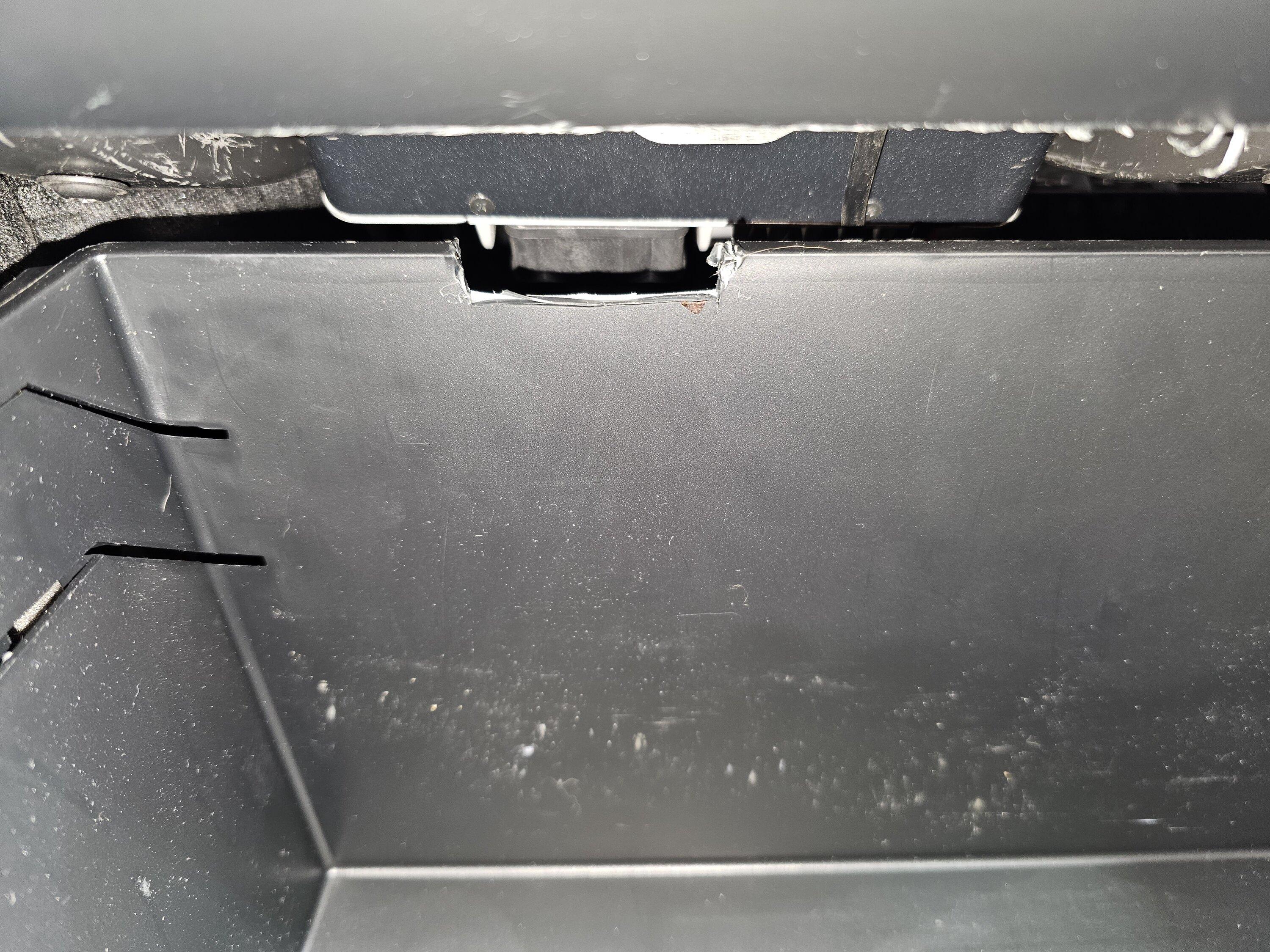

With much trial and error I was able to get the wire from the accessory ready area to behind the glove box. Everything turned out pretty nice. I drilled a hole in the plastic piece that can be removed and added a grommet. So no wires show. Here are some pics if anyone is interested.
Ford Bronco Ideas for running a cable from the center dash accessory mount IMG_1354
Ford Bronco Ideas for running a cable from the center dash accessory mount IMG_1355
Ford Bronco Ideas for running a cable from the center dash accessory mount IMG_1349
