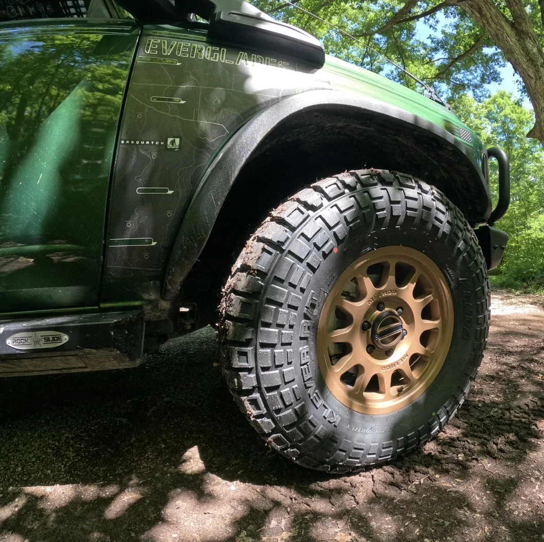

I use the Method/Ford Performance 703s that are hub centric and made for the Bronco.
Ford Bronco How to run Method 703s on a Bronco?? (also BORA spacers) IMG_0593

These are sold through Ford Performance it was a partnership with Method to make the wheel hub centric to the Bronco. It does limit your offset if you wanted a different offset.
https://www.ford.com/product/20212024-bronco-17-x-85-method-wheel-kit-bronze-p4000006554?gmcid=marketplace-gs-cta-accessories&searchid=20643481100|157311292289|pla-293946777986&fcid=pse_20643481100_google-pla&ef_id=CjwKCAjwgajSBhBEEiwASicJU3J-tZ7oQBeP85T8KJLoj0OVoFLgk5fpboEHLy0LZnZisddk9-yPNxoCw9AQAvD_BwE:G:s&s_kwcid=AL!2519!3!676763613569!!!g!293946777986!!20643481100!157311292289&gad_source=1&gad_campaignid=20643481100&gclid=CjwKCAjwgajSBhBEEiwASicJU3J-tZ7oQBeP85T8KJLoj0OVoFLgk5fpboEHLy0LZnZisddk9-yPNxoCw9AQAvD_BwE
edited to add they have Black, gray and white available as well through Ford.

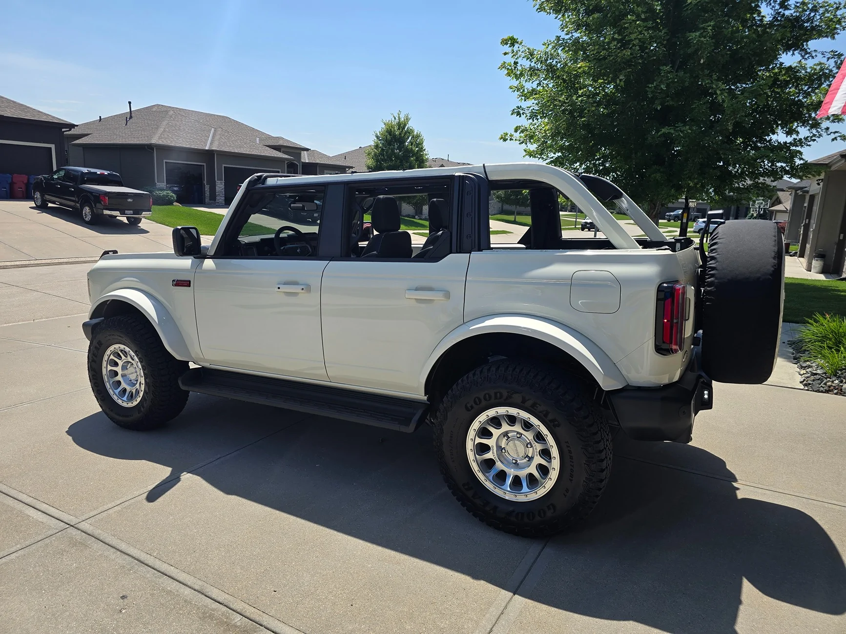

These are 709's with the 106.25 bore. we just installed the little sleave that comes with the wheels, zero issues, drives nice and smooth at 75+ mph down the highway. Personally I'd find the offset that gives you the look you are chasing and ditch the spacers.

Mine are 0 offset, sasquatch flares, sits flush with them. 17x8.5 rim, no spacers

Factory tires, sasquatch goodyear 315's
You're way more particular than I was, 🤣

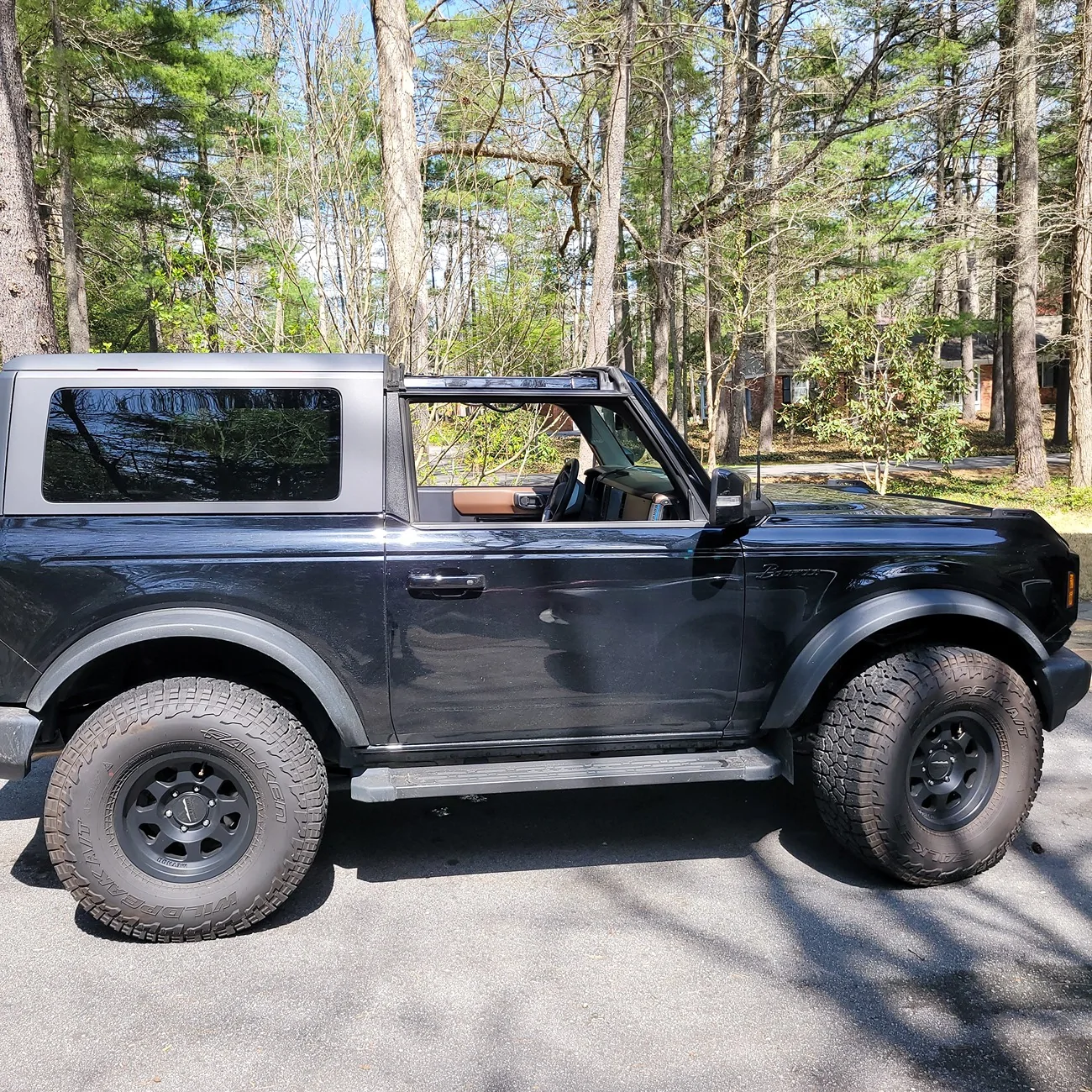

I ran method's on my last bronco, had to use a spacer in there. Had one tech leave it on the tire they rotated to the spare. Didn't take a few seconds driving down the street to realize something was wrong. Vibration hell.
Ford Bronco How to run Method 703s on a Bronco?? (also BORA spacers) 20230326_142824
