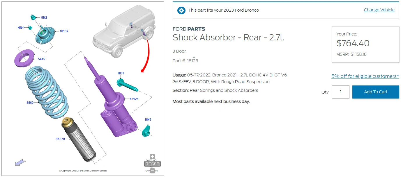

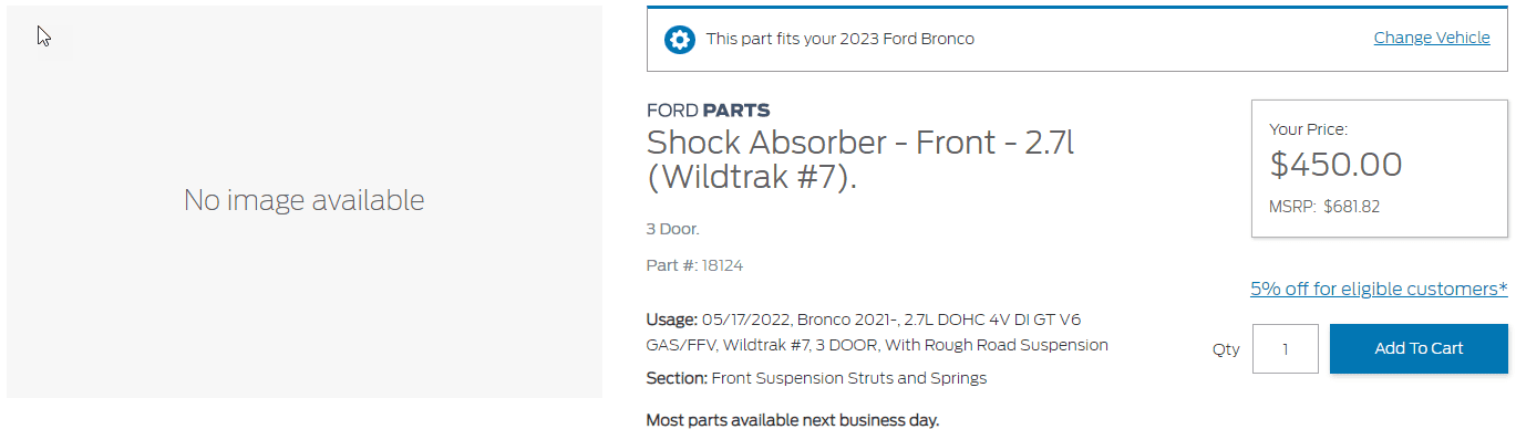

Here's what I found from Lakeland Ford's Parts website search by the VIN above:
@flip,
Are there any additional components that you can see needed for this swap? Like the spring perch and mounting plates pictured above?
My parts department didn't seem too knowledgeable when it came to swapping these parts. He did confirm the part numbers I brought in to him based on vin #'s were correct. The description for the struts says "shock absorber assembly", which I just assumed meant it was the complete assembly minus the spring.
