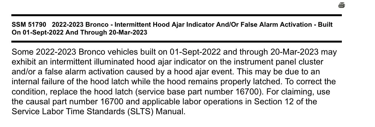

Also, here is the SSM for the hood ajar alarm
This is helpful. Mine was built in Nov 22 as a 23 and I took delivery in Feb 23 and mine has done it a ton. I record the alert from Ford Pass each time and it’s well over a dozen since I took ownership. It’s annoying, but doesn’t cause much harm. Next oil change I’ll try to get my dealership to just replace the sensor.
