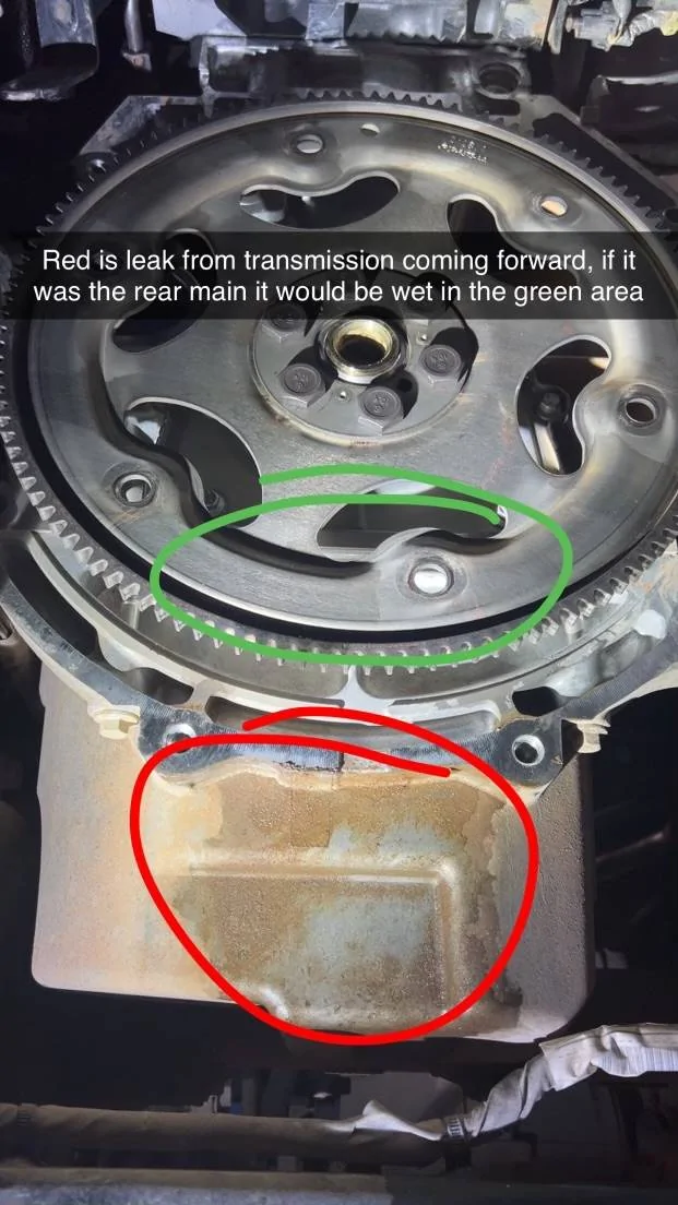

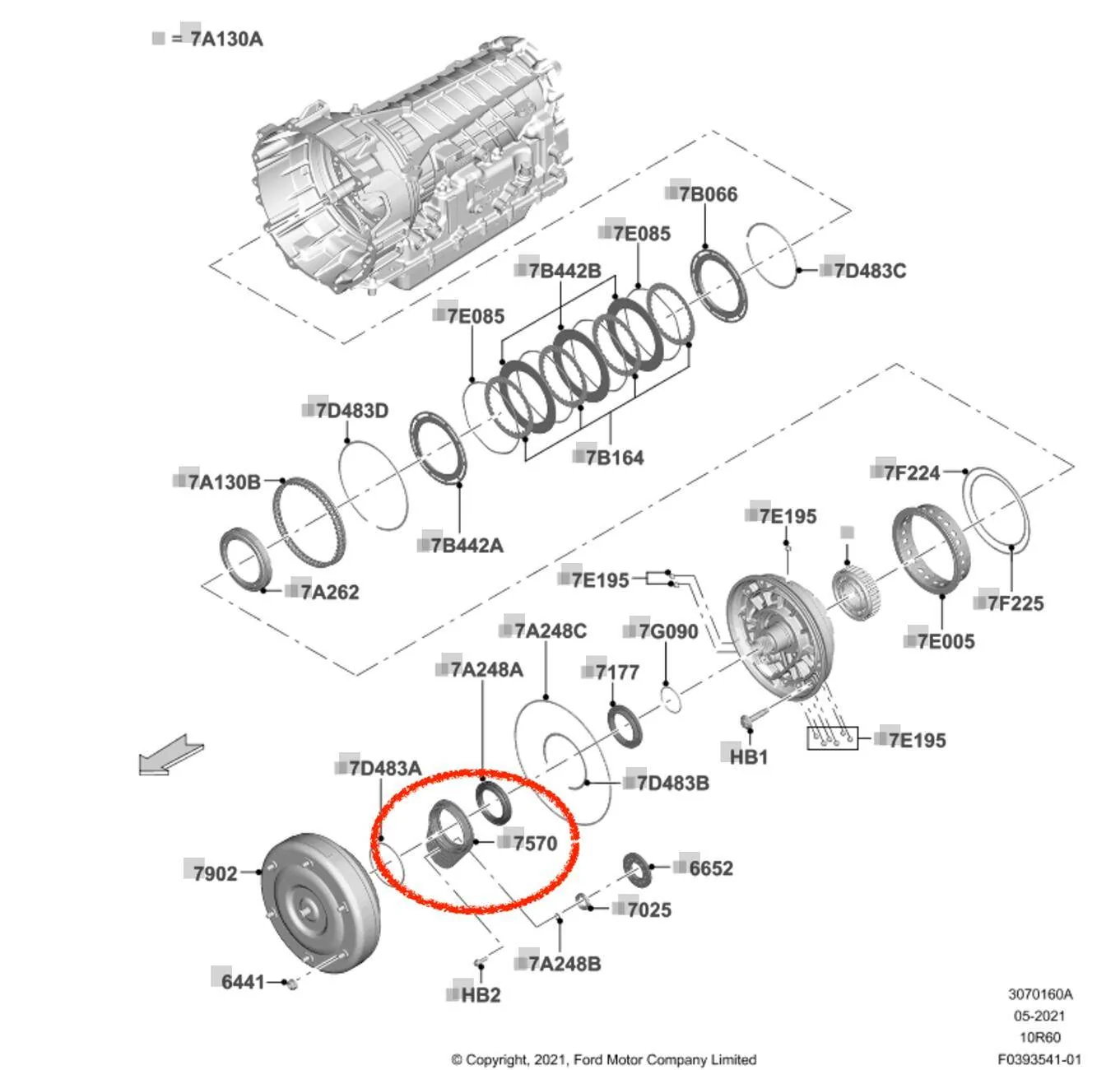

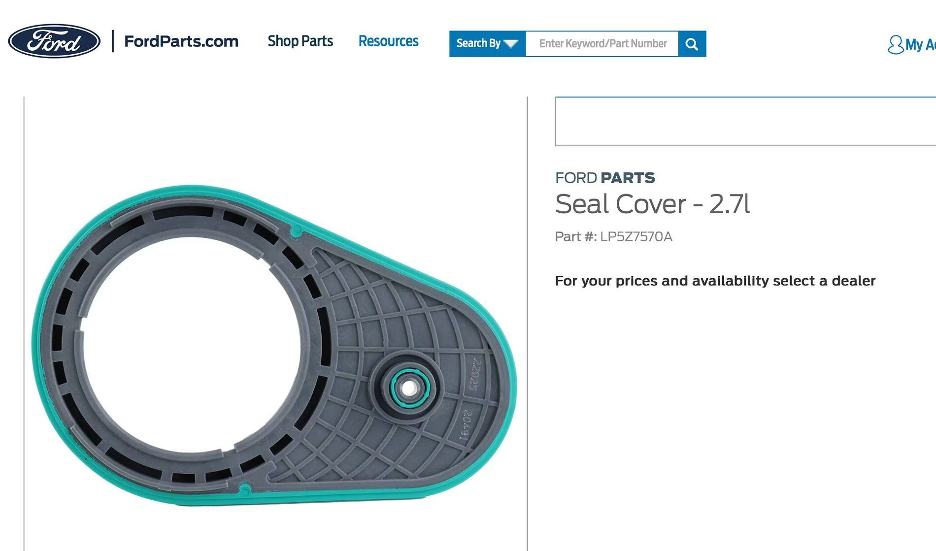

I haven't seen any prevalence of this one yet. My 2021 2.3 Badlands AT with 46k miles is in Ford service repairing a transmission fluid leak that the oil change tech noticed. They pulled the transmission and it's a cheap seal, but obviously a ton of labor to repair under warranty. I dropped it off Monday and the part should be in today and hopefully done by tomorrow.
