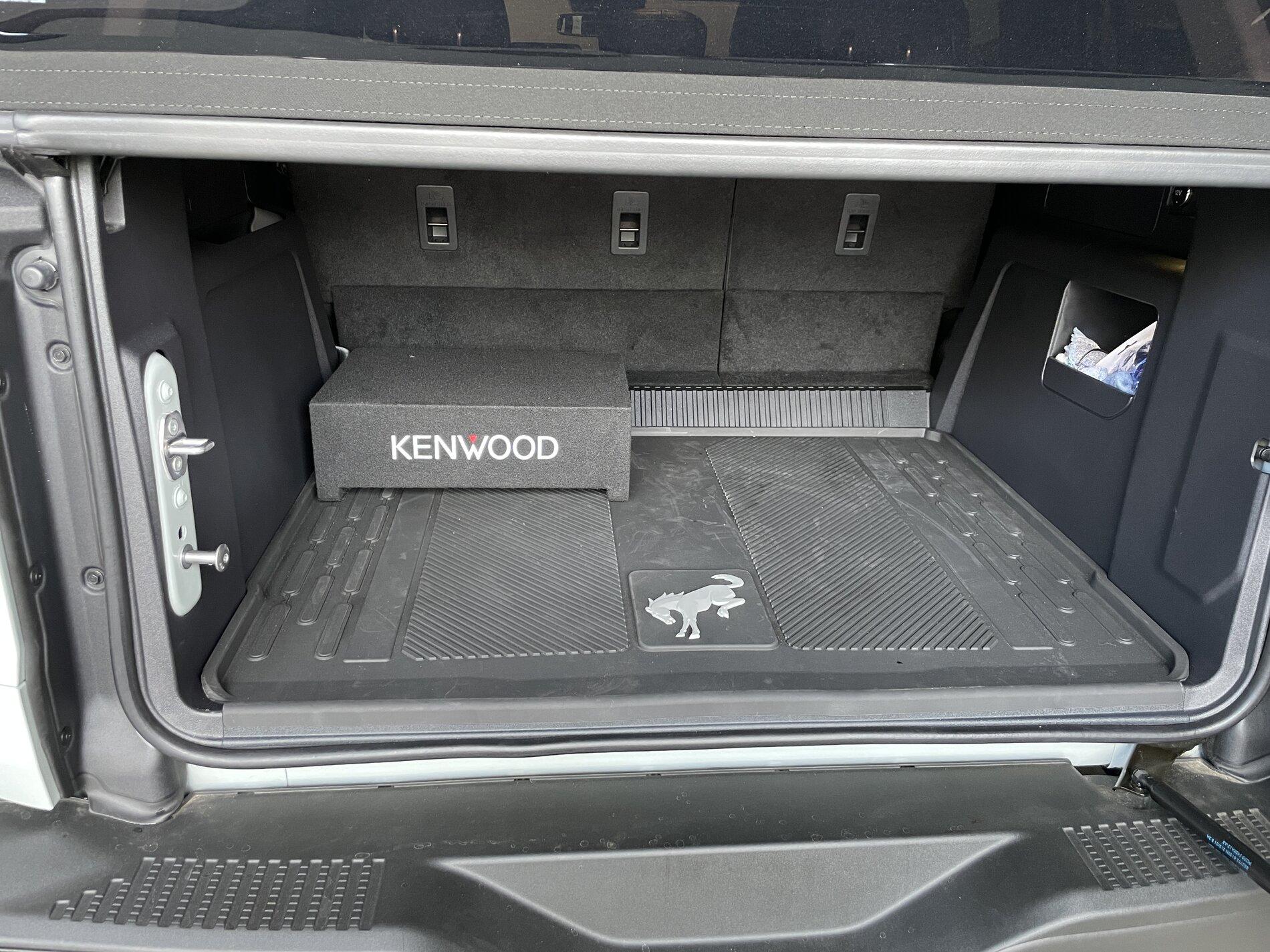

The reality is there isn't really many places in the bronco. Nothing can go under the back seats if you ever want to fold them down. I couldn't even put a snow scraper under there without jamming the seats up when I went to put them down.
Your best bet is to just replace the speakers and then go with a powered sub so there's no need for an amp. This is what I did with mine. It't not going to rattle your neighbors windows, but it makes a world of difference in overall sound quality.

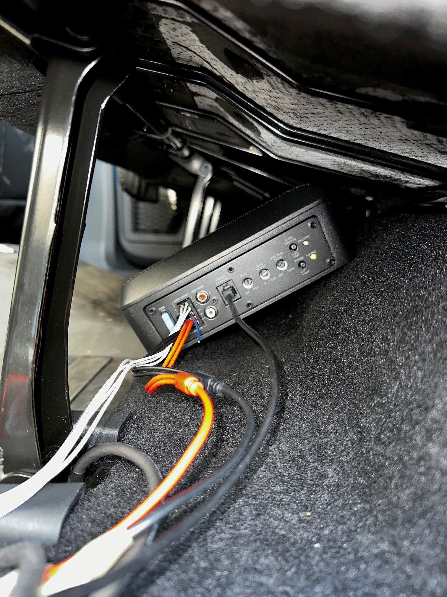

OP....I have the same seat setup as you (leather with heated seats), so my solution was to find a compact powered sub and put it under the back seat at an angle. I went with the JBL BassPro Nano. It puts out amazing bass for it's size, and is well built. In order to fit it under the backseat, I had to put it at an angle, but no degradation of bass in my opinion installed like this. I attached it with heavy duty velcro on the bottom edges and it's very secure and not going anywhere.
The only negative is I have to remove it to fold the seats down, but I currently have two kids car seats back there anyway, so my seats aren't getting folded down anytime soon without a major process as it is. I cleaned up the cabling a bit after I took these pics, but I'm very very happy with this.
