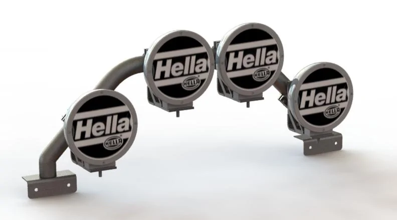

Is there a mount available for attaching traditional lights to the brush guard already on the market? Not interested in LED light bars. I know lots of companies make universal roll bar light mounts, but I haven't found anything that could support a set of Hellas.
Ford Bronco Hella Mount for Brush Guard Rallye4000Mounts3

I've been looking all over for something similar to this and have so far come up empty. If someone made some similar brackets that would fit the bull bar I'd be a buyer. What would make it even better is if they could adjust the offset as to not obstruct the camera.

if there really isn't something available then I'm going to try to have one made. the rendering is from a quick prototype I mocked up but I wanted to make sure there wasn't an alternative available before I went through with it.

Probably just best to go to a fab shop and ask for one made.

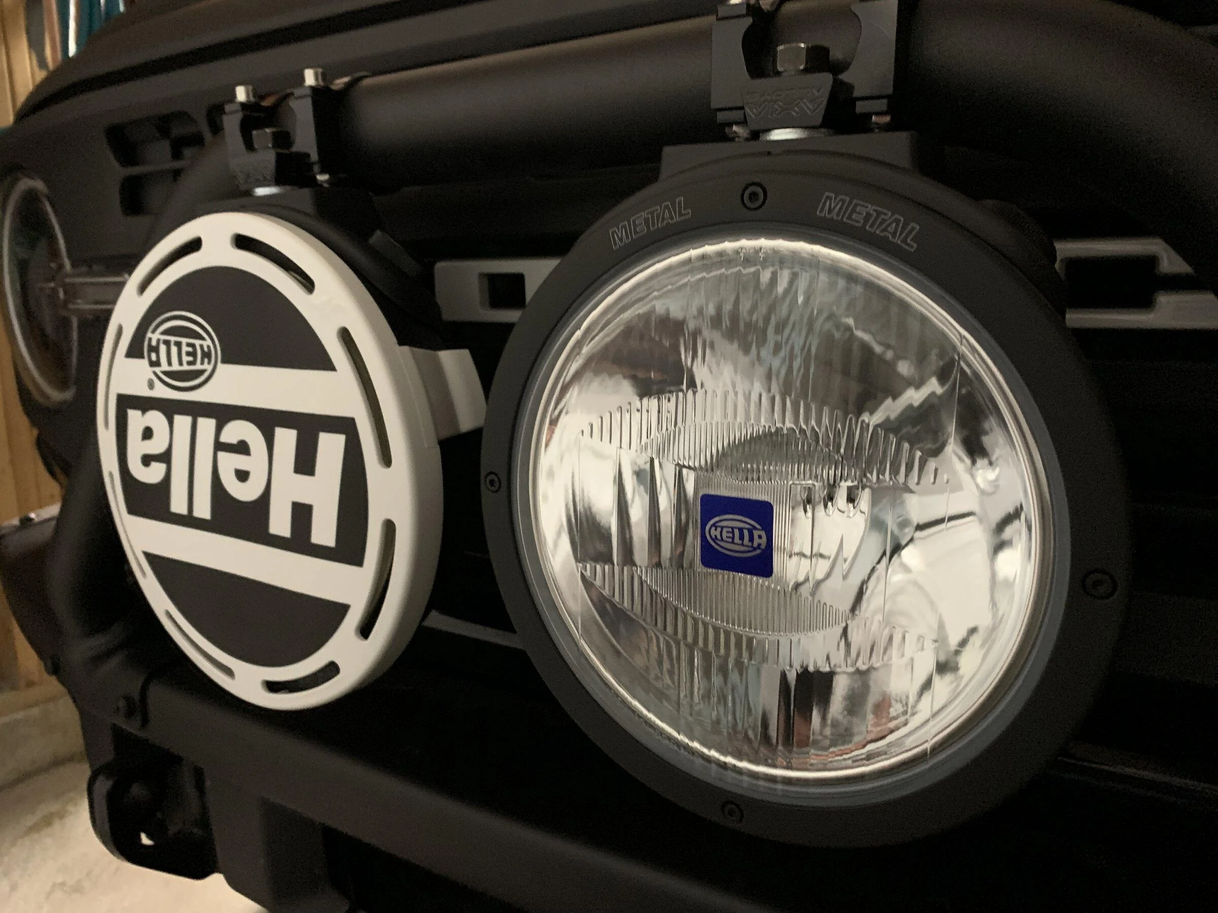

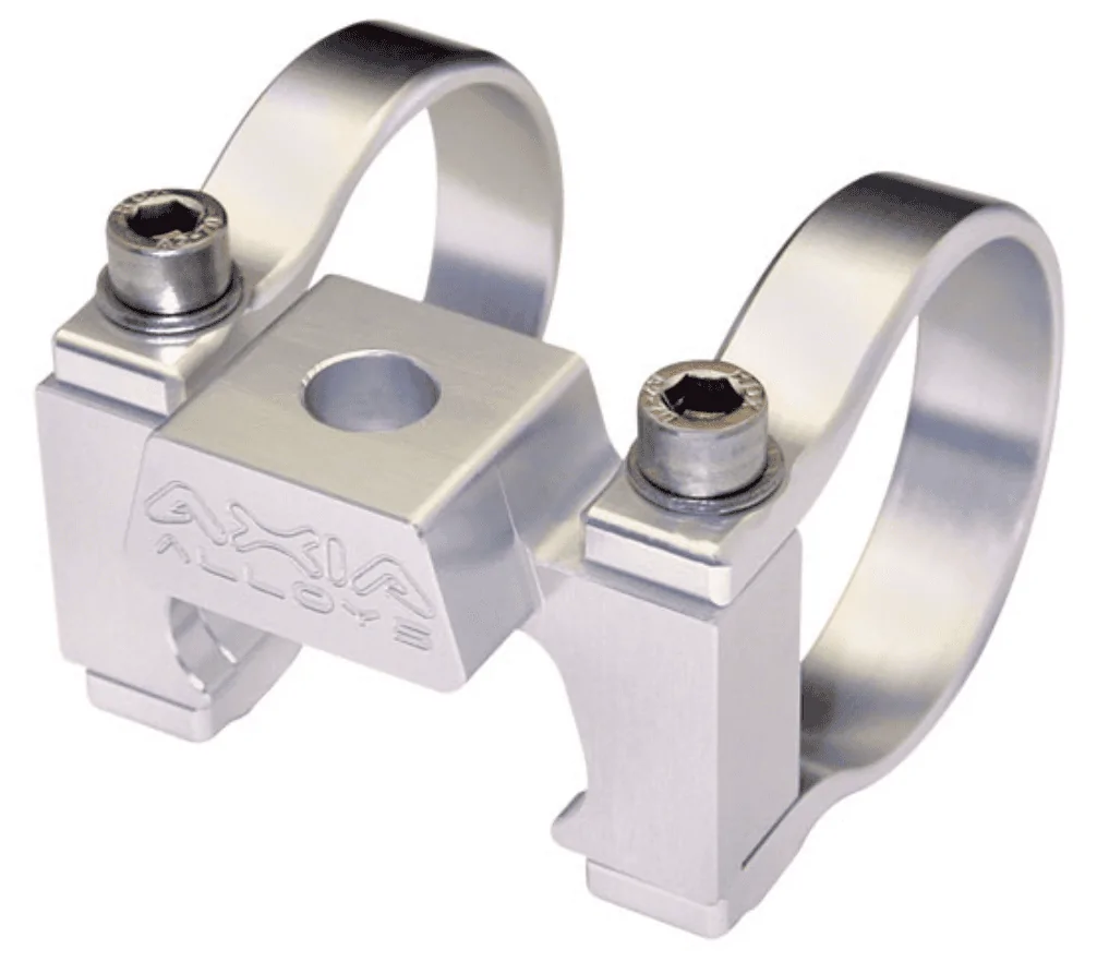

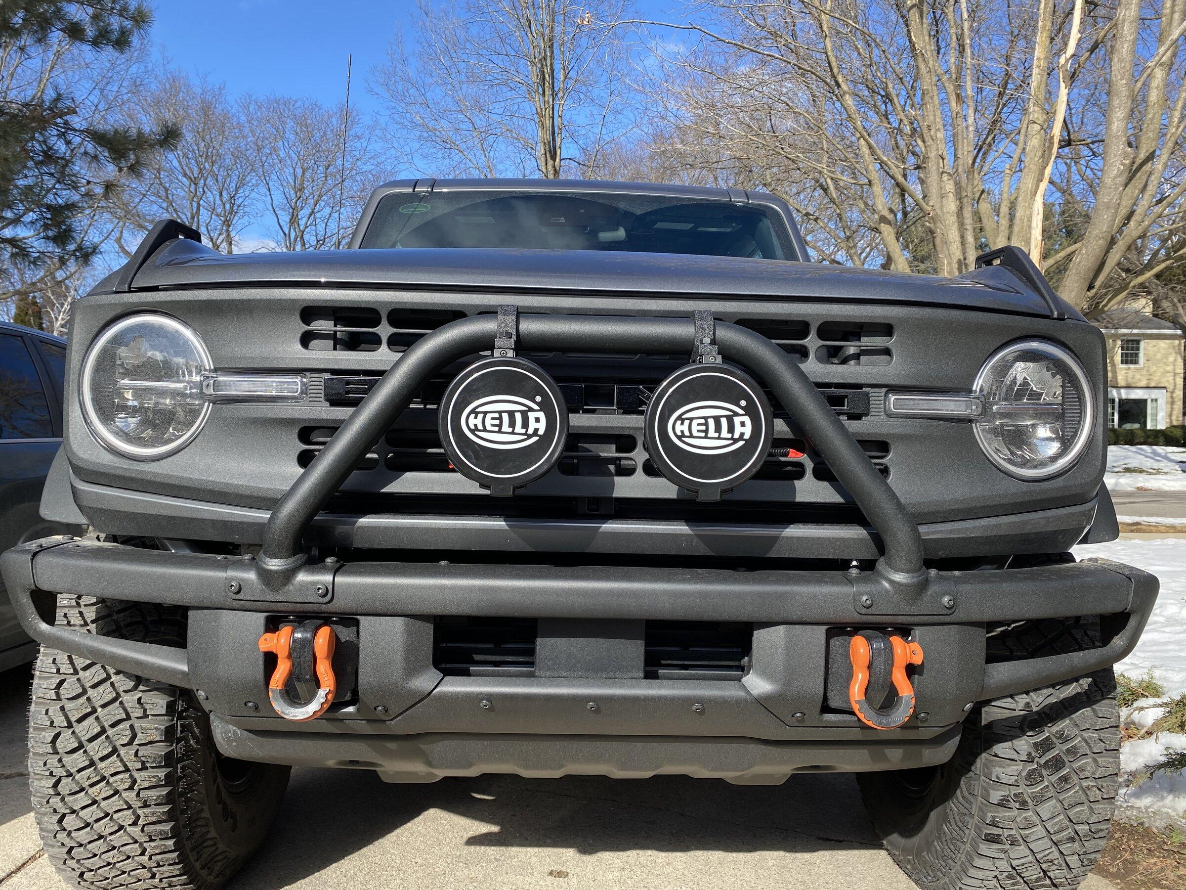

I used those for some Hella Rallye 4000 and it is very tight between the back of the bulbs and the grill. I put some thin rubber on the back of the bulb to keep it from vibrating. I also flipped the bulb itself (not just the lens) so that “Top” is up. I may drill a small drain hole at the bottom but these aren’t sealed lamps so it may not be needed.
I wish I had the option for the capable bumper.
