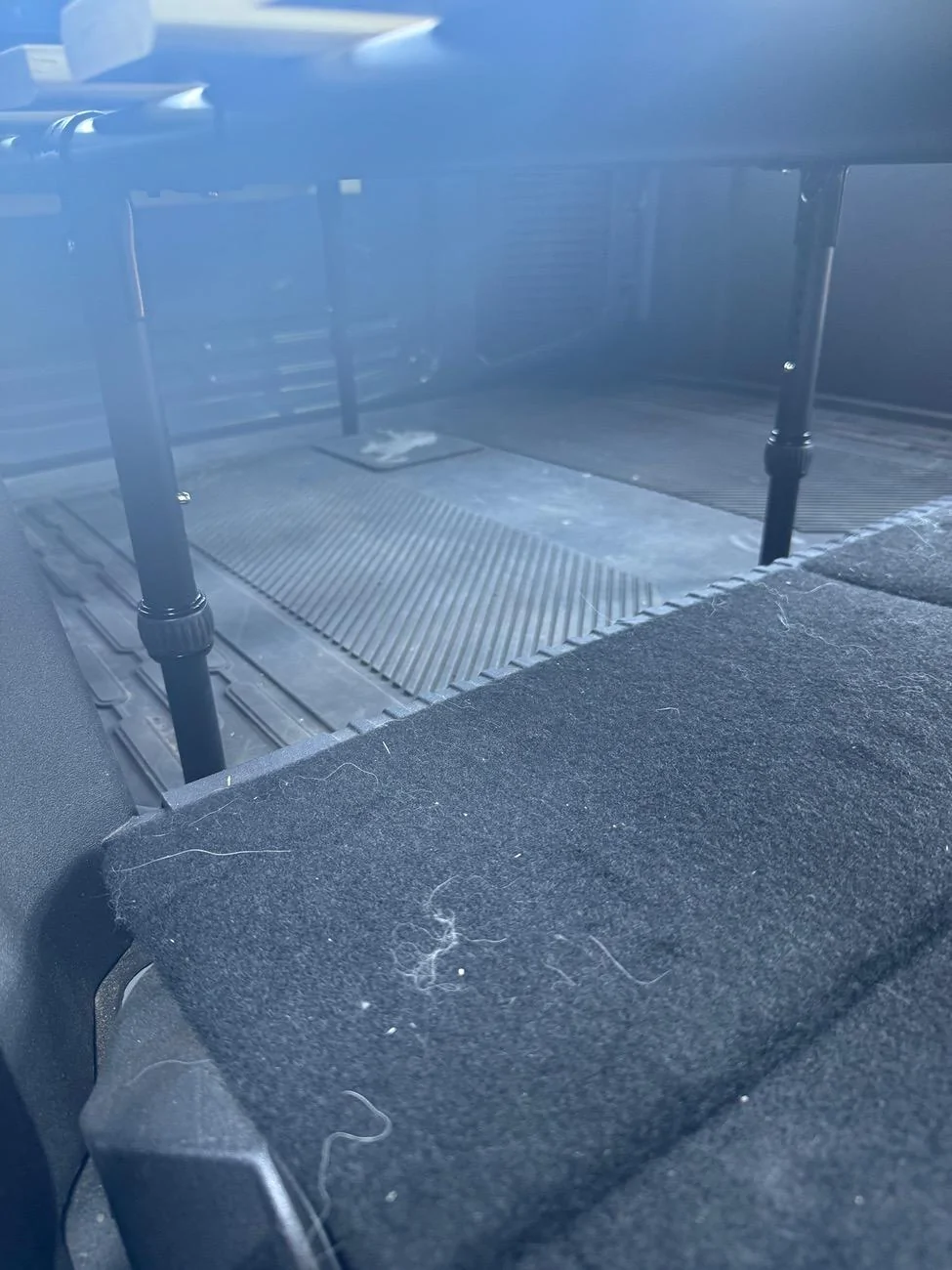

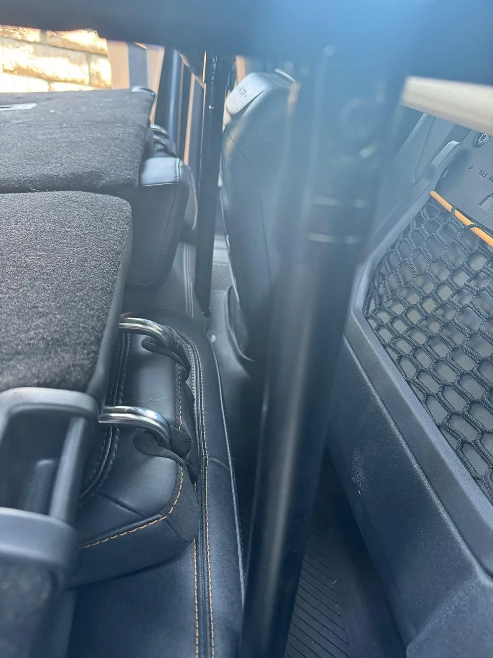

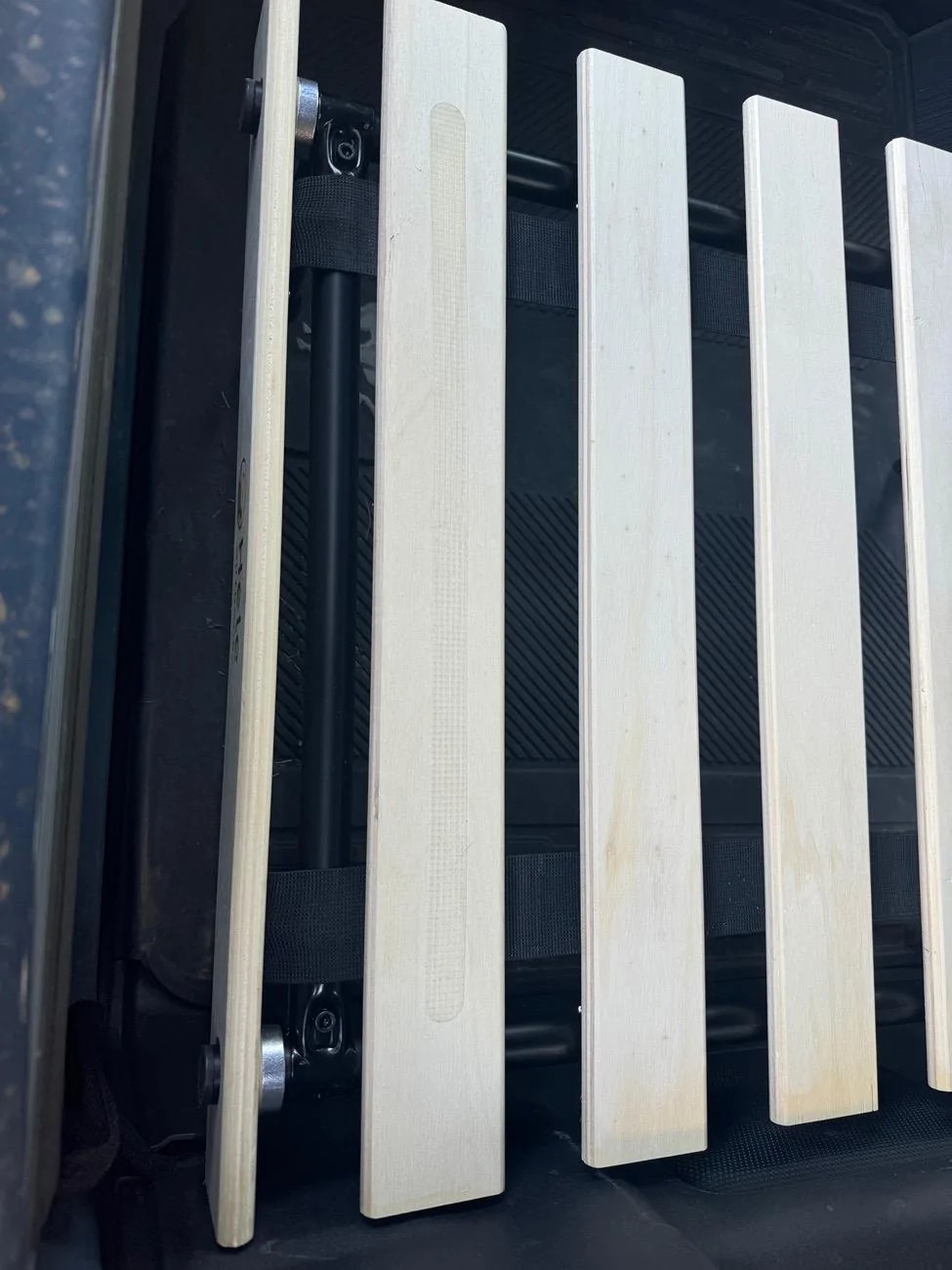

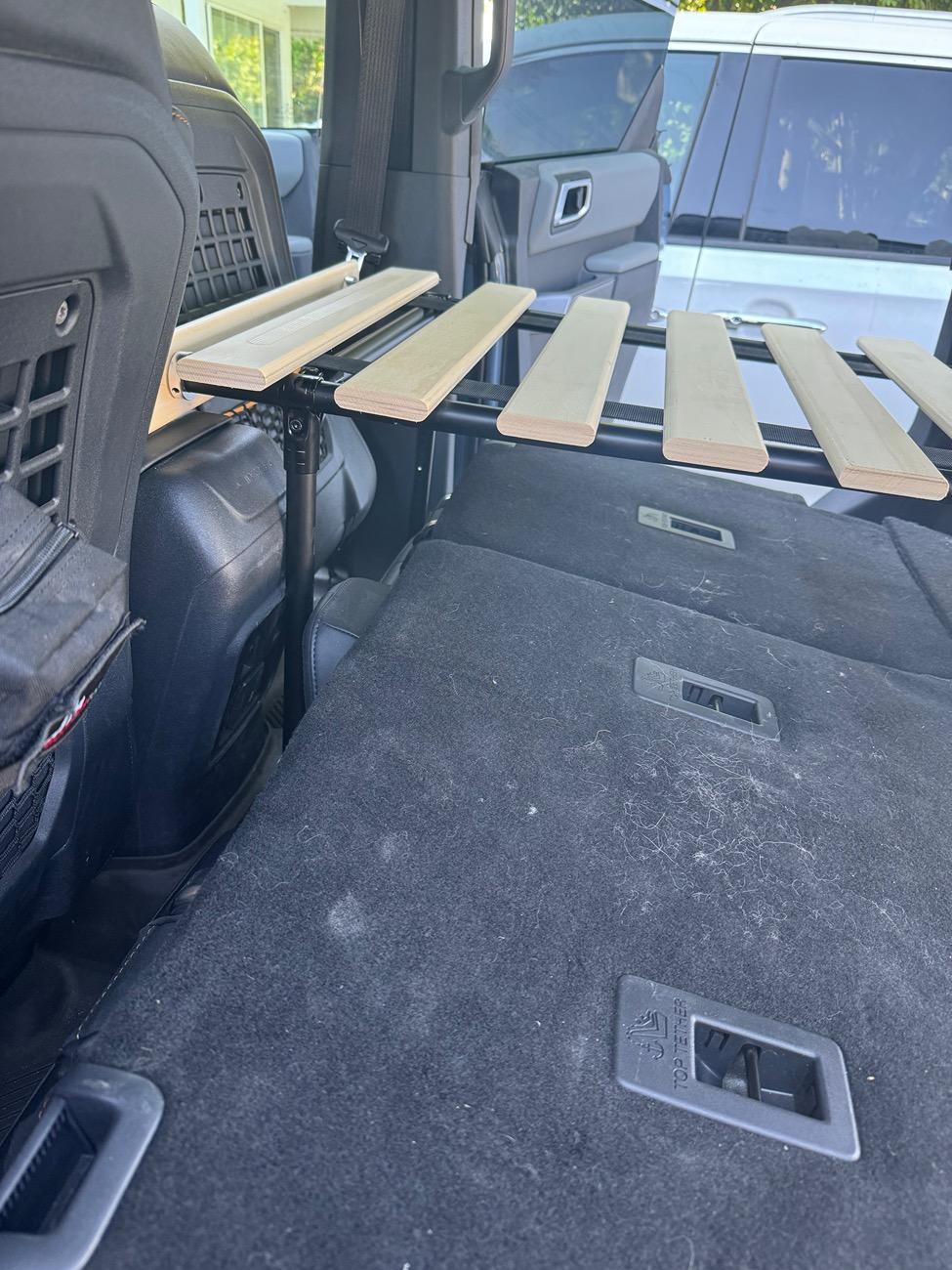

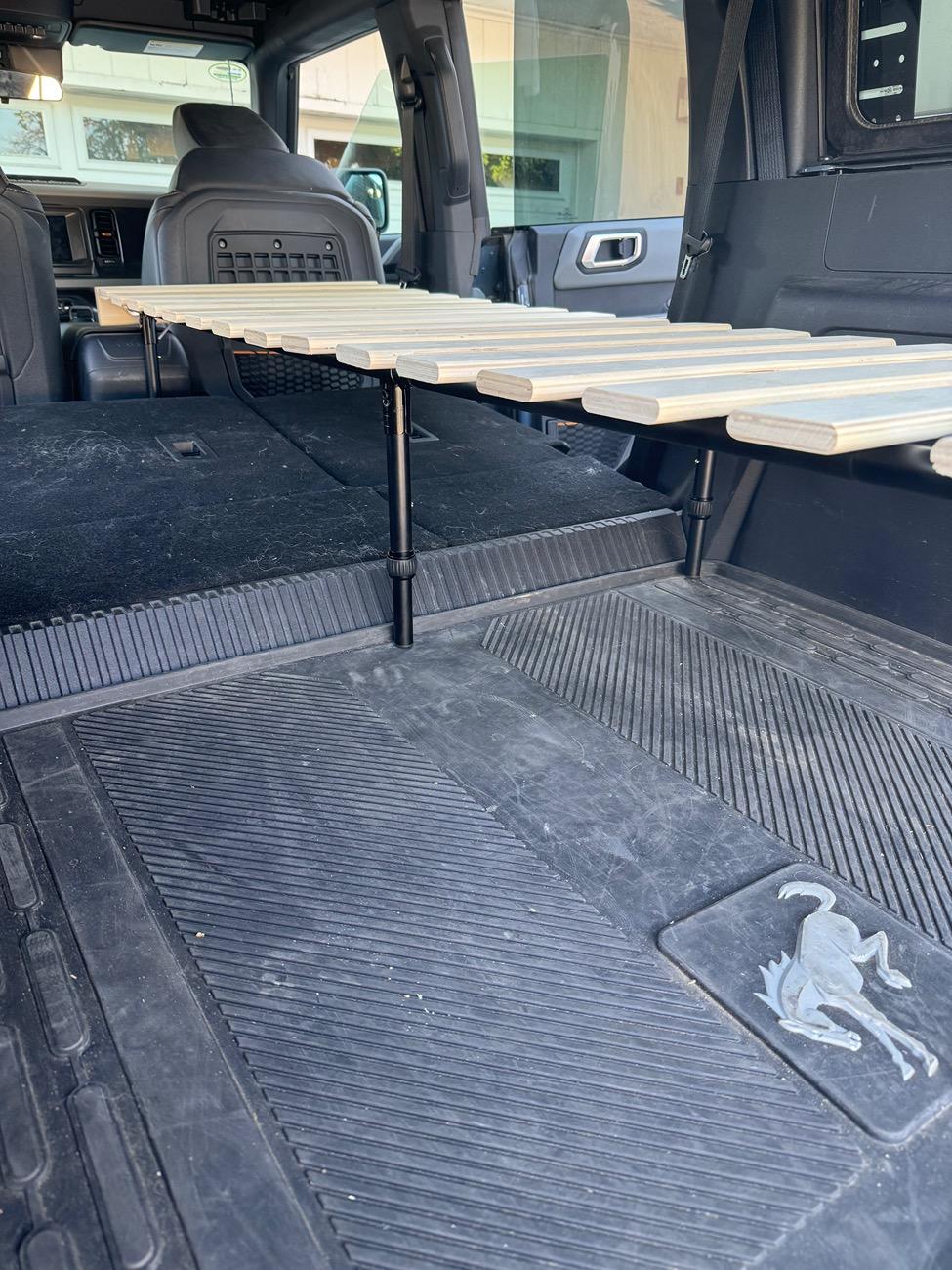

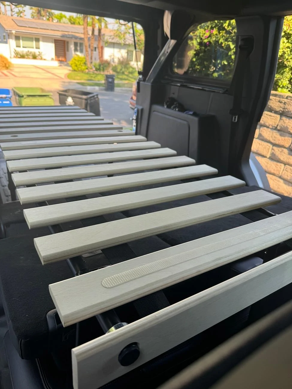

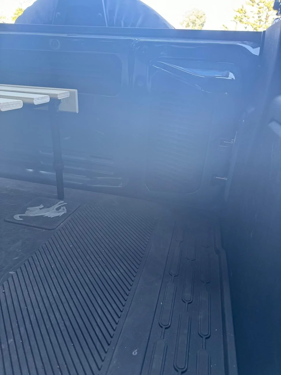

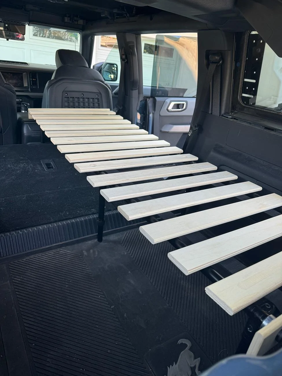

I added some more pics from a bunch of different angles with the mattress off. Some interesting discoveries:
1. It wont fit on the drivers side because of the big chunk of tailgate the insert into the trunk. There isn’t enough room on that side. As such, you can’t have this in place with one seat up because the passenger side seat area isn’t wide enough to accommodate this with the drivers side seat up.
2. There should be enough room if you have a table attached to the tailgate as long as it’s not too thick when folded up. There are a few inches available there.

So unfortunately I had to put it on the passenger side. The reason is that the tailgate has that part that's much thicker on the driver side and the Hele box wouldn't quite fit there. When I use this I put both seats down in the rear. I am able to keep the driver seat in the upright position, but the front passenger seat definitely needs to be slid up to accommodate it. I stick all sorts of stuff under the Hele box when I have it in place and it's nice having the space available next to it for whatever other gear you've got.
I have a foldout table on the tailgate and it's not an issue. I just made sure I didn't get one that was too thick when folded up. This is the table I use: https://turnoffroad.com/products/2021-ford-bronco-fold-out-trail-table. I'm sure there are fancier ones but I like this one just fine and it doesn't interfere with the Hele box.
