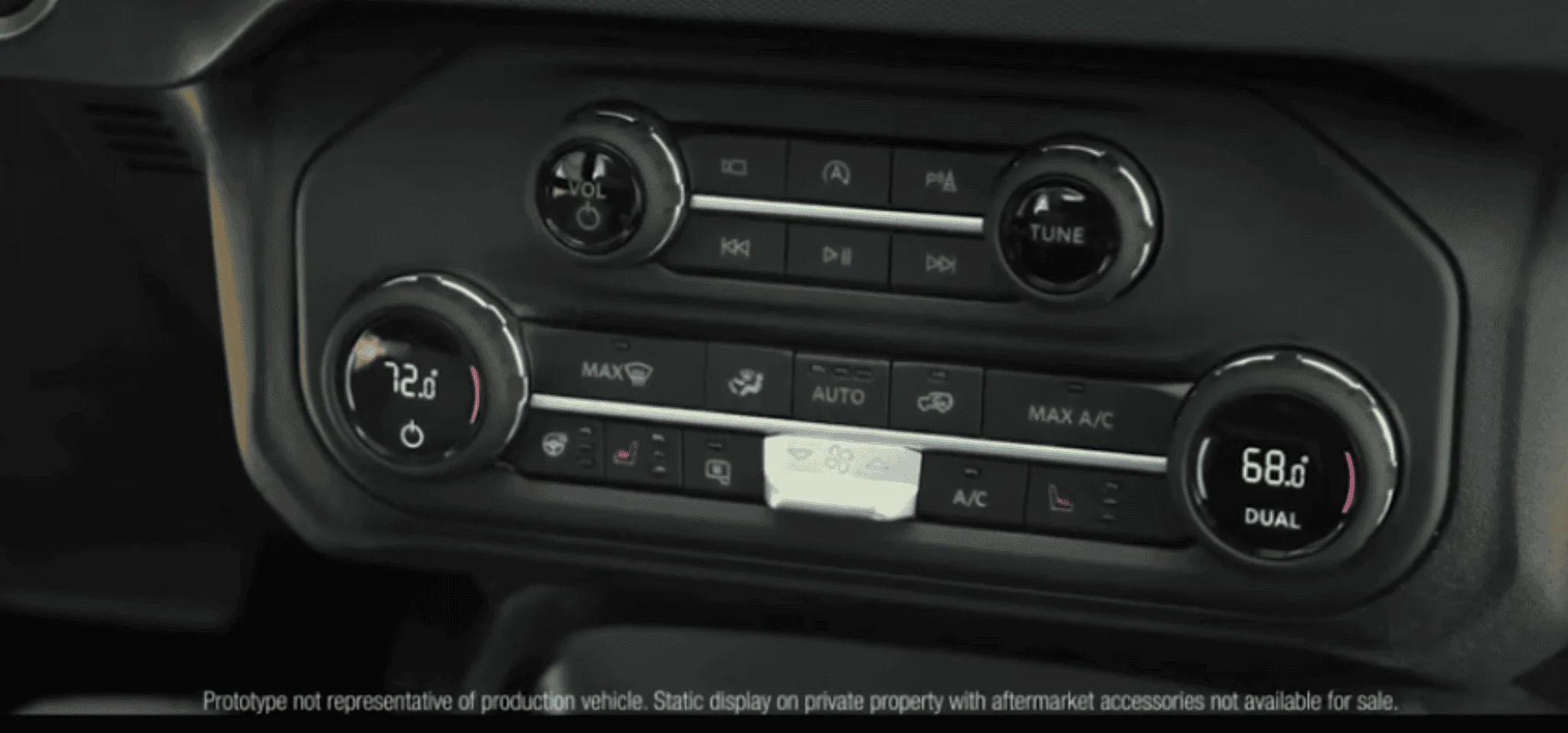

Looks like the Bronco no longer has a dedicated HSWM anymore and temperature is stored in PSCM -- default is 35°C / 95°F. It really doesn't seem that high. I'm going to try 37°C / 98.6°F
What's interesting is on the older setup, the value is repeated three times in your AsBuilt and the cactus grey/white interior preproduction Bronco showed a heated wheel button with 3 indicator lights. I'm not aware of any Ford offering three temperature levels. The older HSWM method had the raw temperatures stored in AsBuilt, the new method used on the Bronco seems to just have 16 predefined values baked in.
