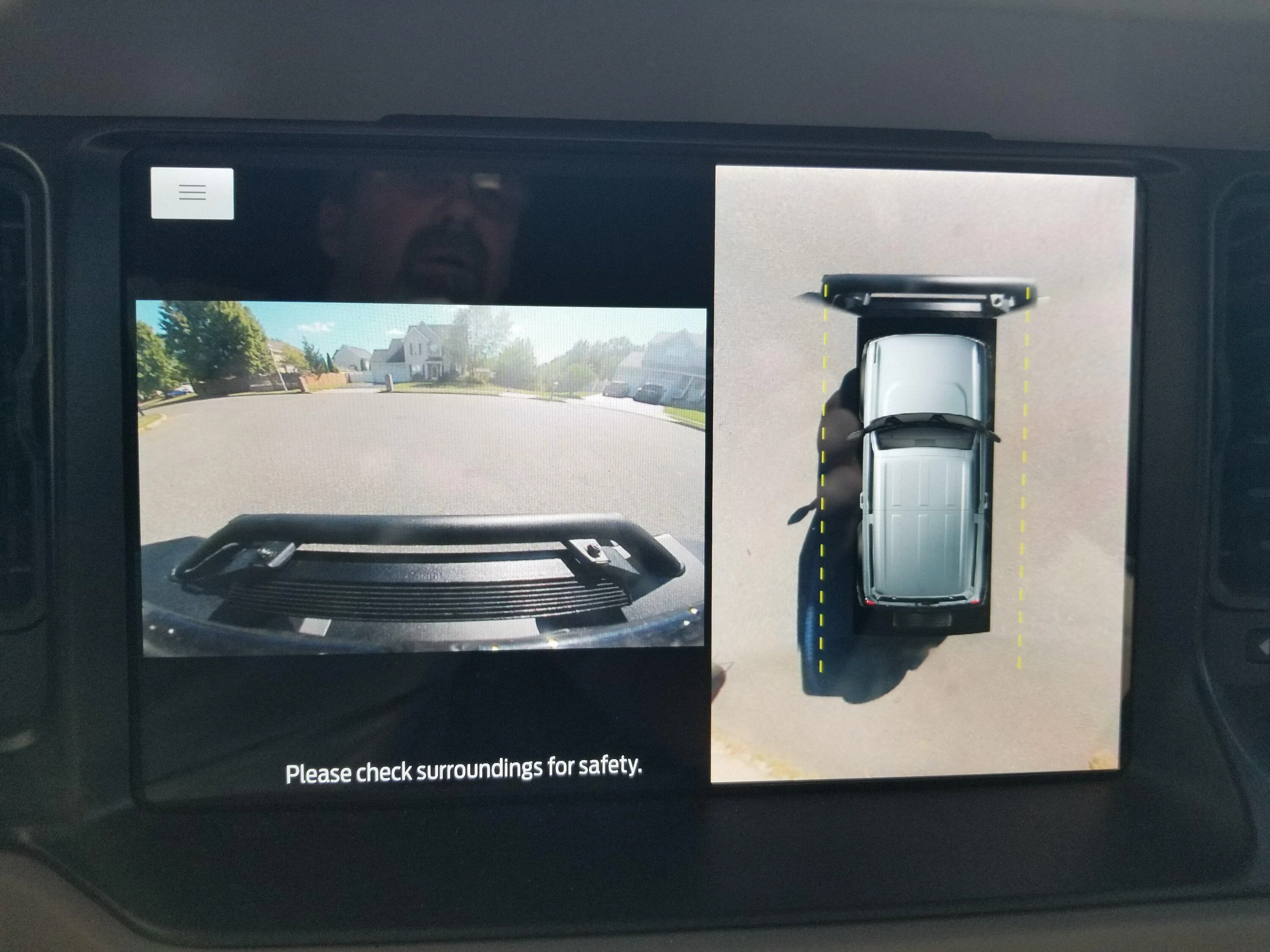

Thanks... I'll take a picture n send tomorrow.
Interesting thing... the park assist (overhead view) shows new bumper. 🤔
Camera view, not bad, seen worse....
