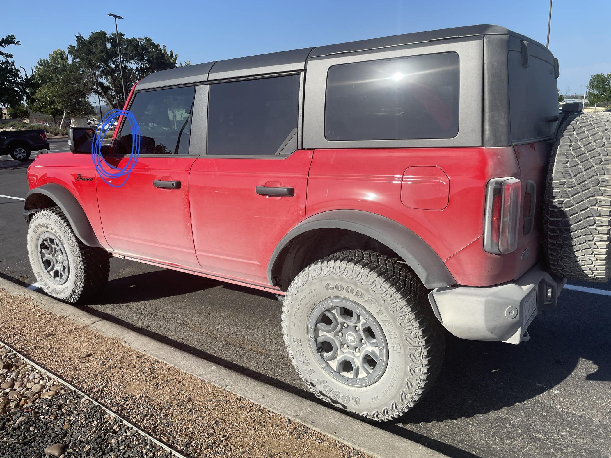

I had a soft top when a dealer friend of mine had a deal fall through. Sold it when I got my wildtrack with a hard top. The sound difference between the 2 is nominal at best. What I thought was hard top wind noise is actually noise coming from the windows. There is a little black rubber flap that is at the front part of the window. When driving highway speeds if you press on that flap to seal it against the window better the wind noise seems to drop significantly. Has anyone else noticed this? Maybe something the dealer can adjust?

Do you have a picture of where it's coming from. Just had mine at the dealer they agreed the wind noise was not normal. Ford had them change the from gasket that is above the windshield for some reason but I just picked it up and it's no better.
