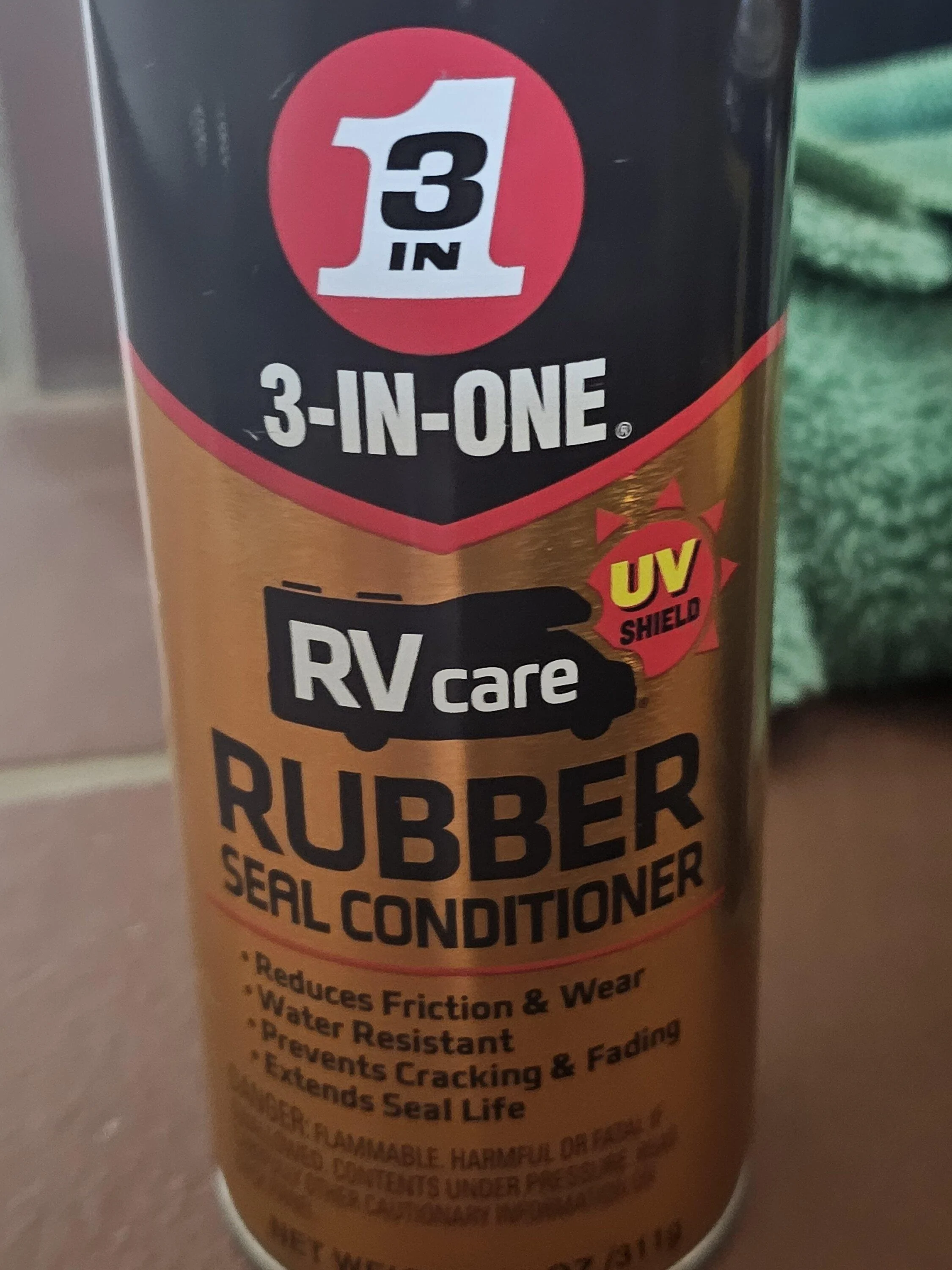

After a couple trail runs my hard top has started making a lot of creaking noises as well. Seems to me worse in the mornings when its cooler - once that Arizona temp gets up there seem to be not as noticeable. I may try this 3M Rubber conditioner when I take the top off for the "fall" season.
