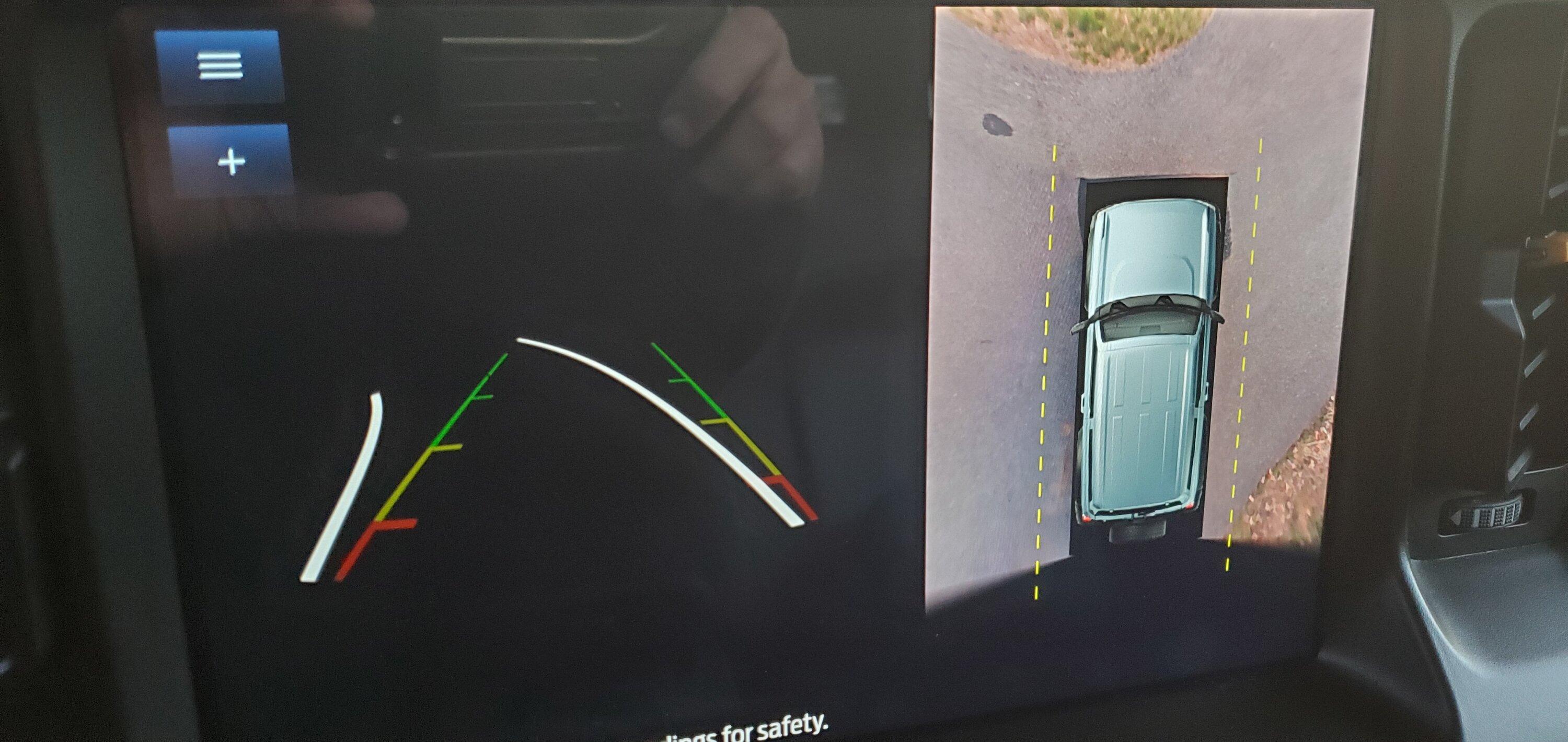

Almost every day when backing out of my driveway (with like 6 kids in the house across the street who play on the road), my backup camera keeps glitching. It freezes on a frame, flashes black, and eventually fixes itself. But it's at such a critical moment... the issue during these seconds are asking for an accident.
I'm obviously using mirrors and turning around for full awareness but I can guarantee you there's people who don't and if this is more widespread - could lead to accidents.
Mine does this 4 or 5 times a week. Shutting off and restarting does not clear it, it will just randomly start to work again.

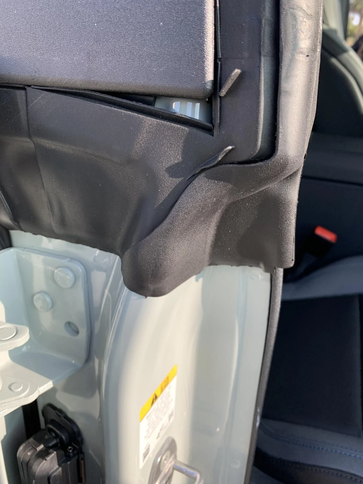

I think I saw others with this issue: Rear Doors rubbing on the bottom nearest to the wheel well on the 4-door. They're little chips now but I know they'll rust eventually
