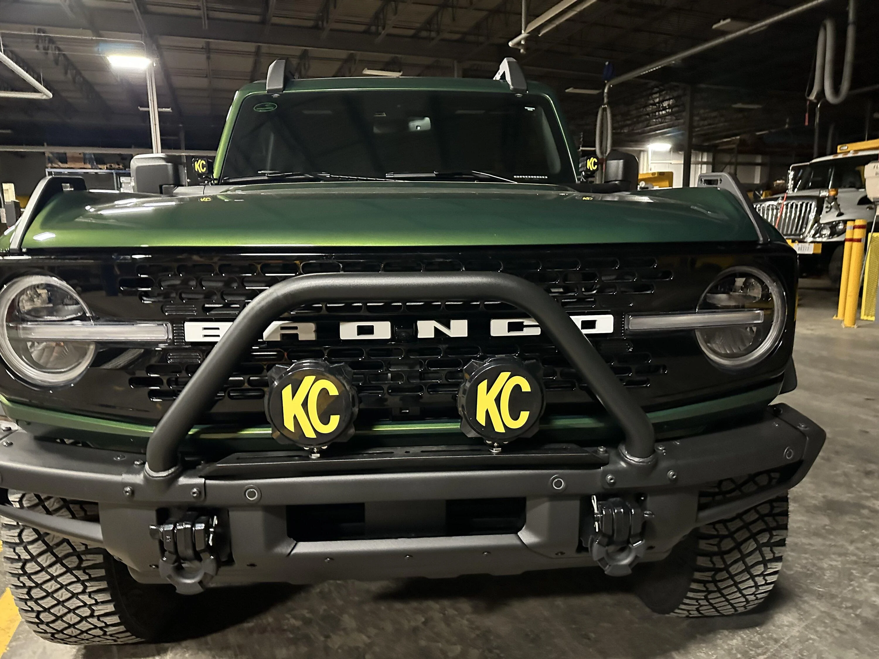

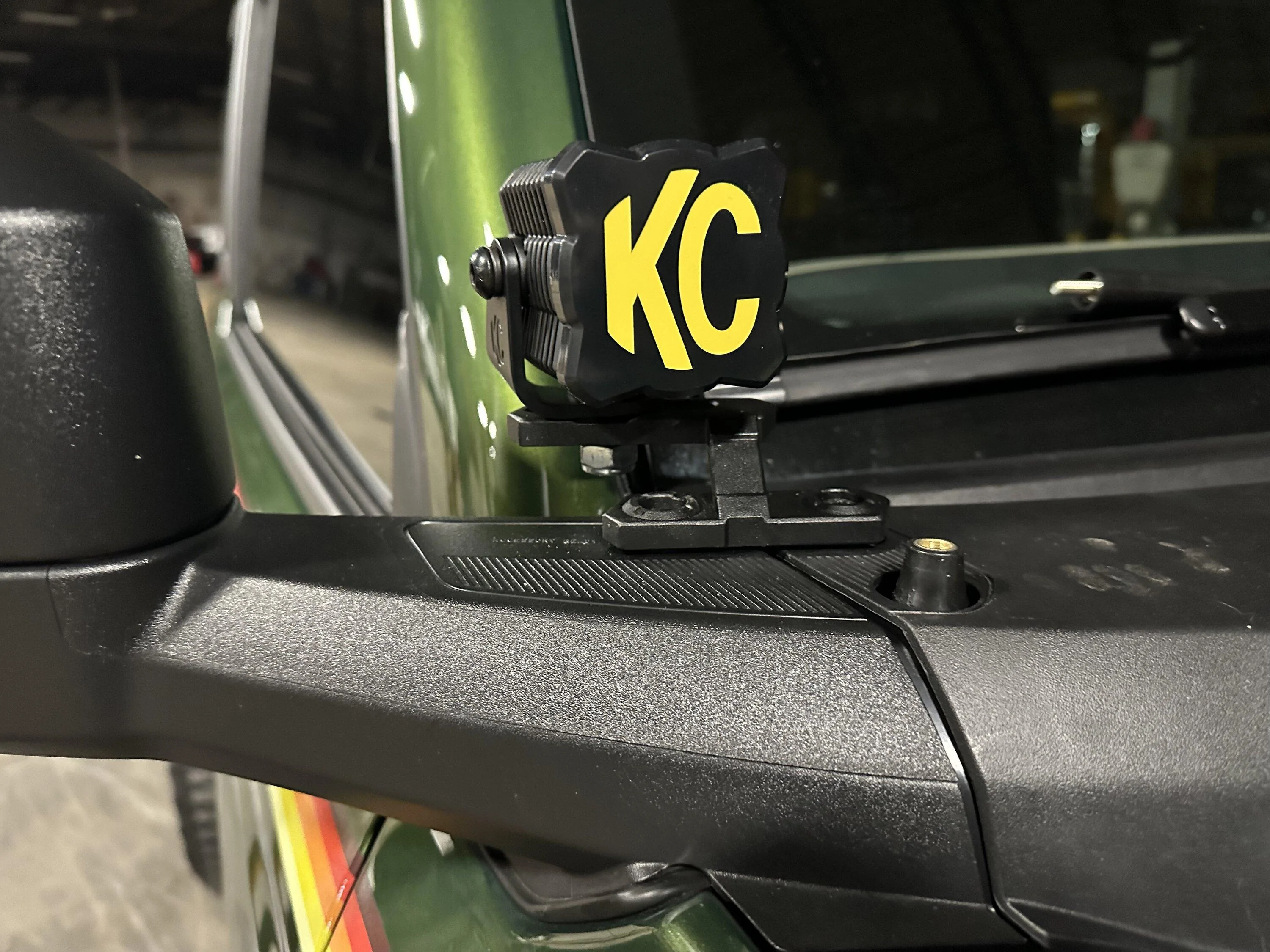

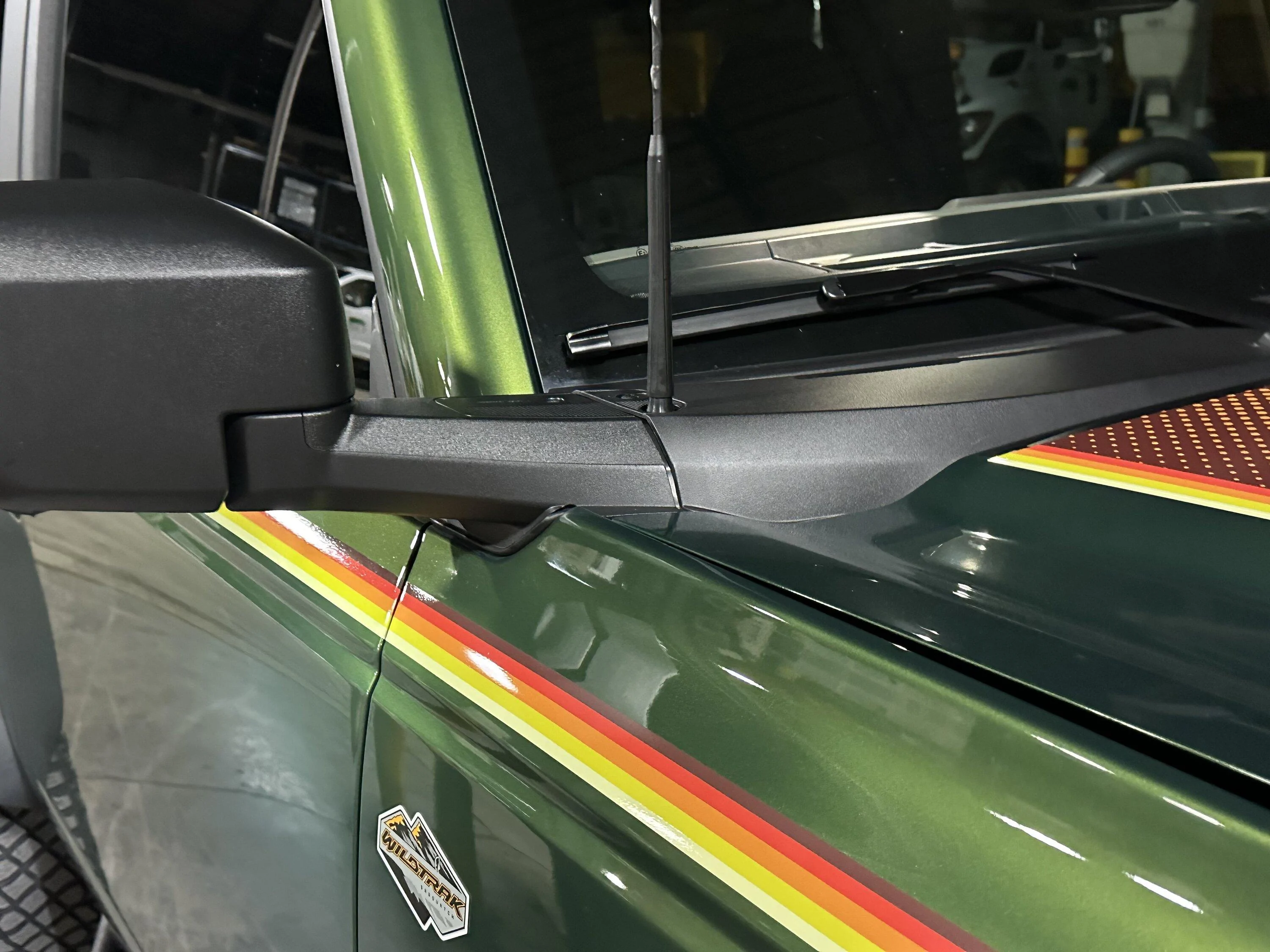

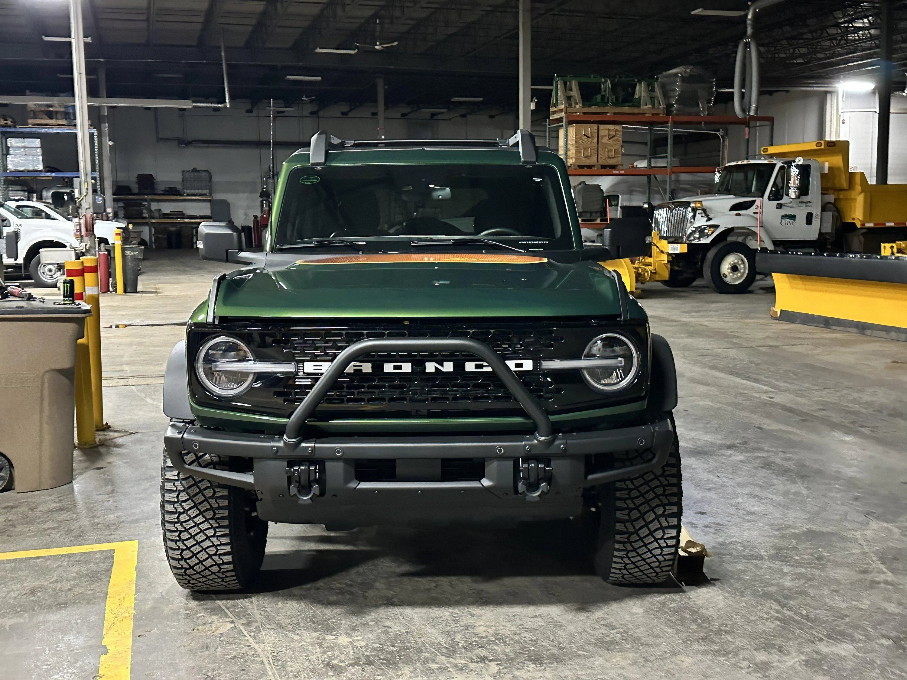

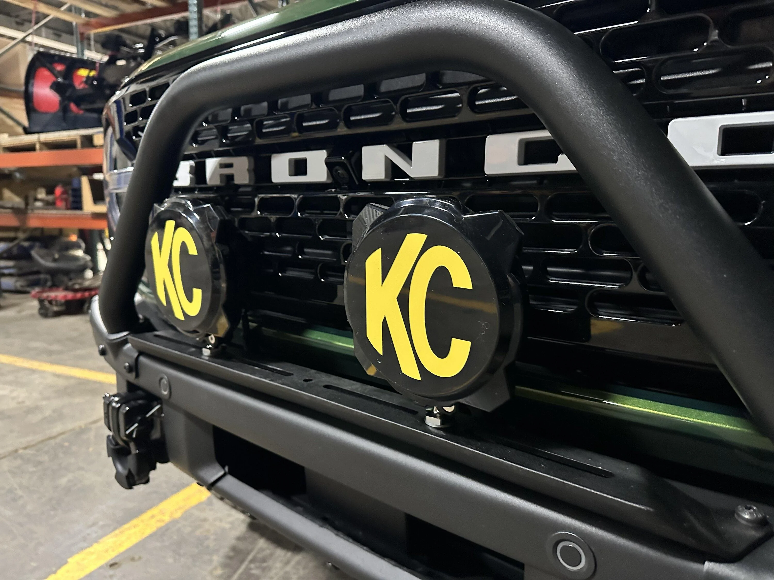

Installed a couple PRO6 spots on bumper and ERA 1 pods ditch lights. Decided on KC Hilites because I wanted that retro look. Spent about 4 hours with the mock up and wire routing.
used a Texas Complete mount on the bumper. bolt hole/bumper match was perfect. It’s easier if you pre mount the lights. Pods were mounted on sevensparta super easy install once your wiring is installed. KC hilites were great plus online videos on how t trim the wiring for aux switches. Anyway here are my pictures.

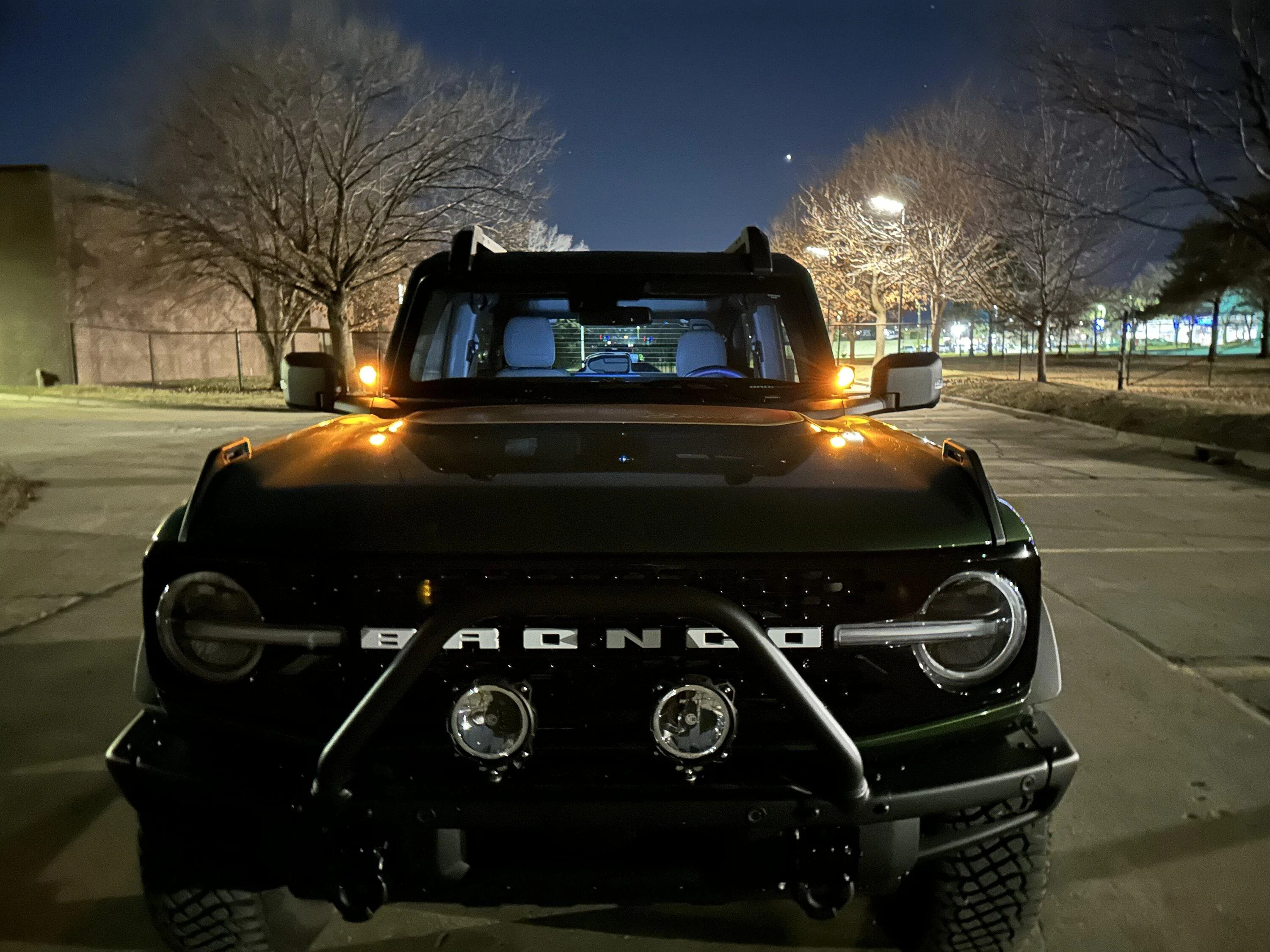

I will try and get a few shots tonight in the dark. The wiring was straightforward. They had videos on the Upfitter switches, which was awesome.

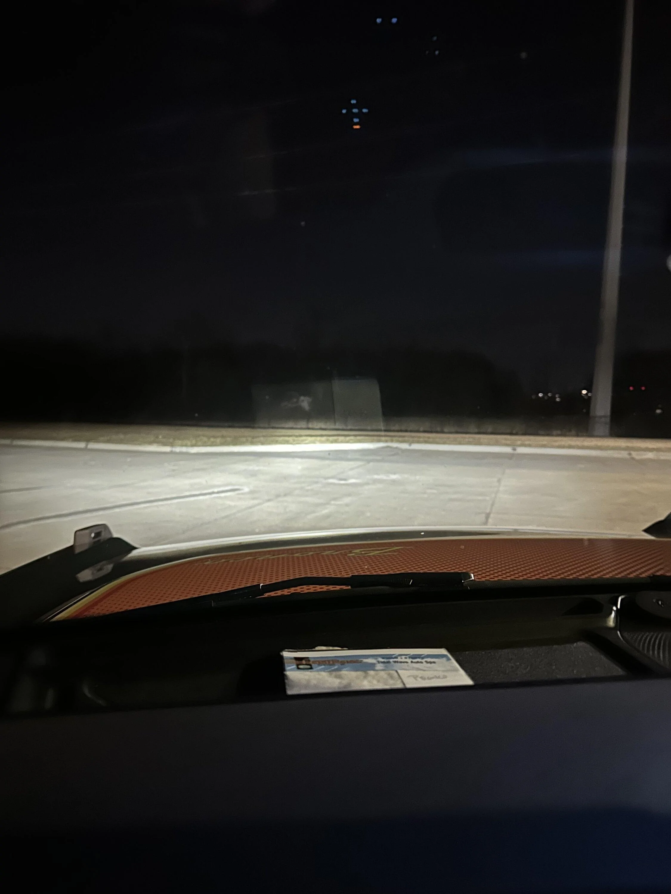

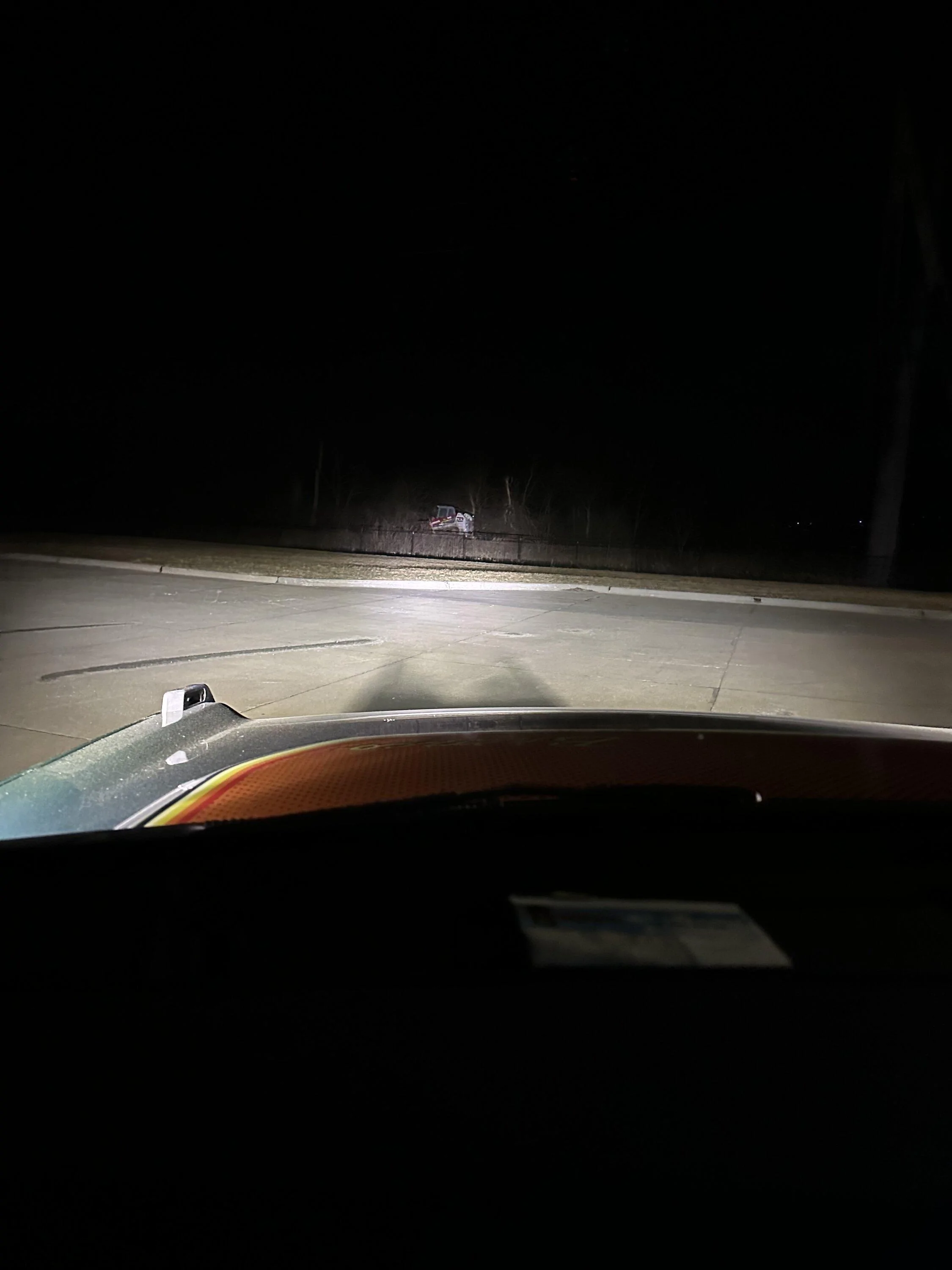

update on lights. One of files is too large to load up. So last are normal high beam and then bumper mounted spots.

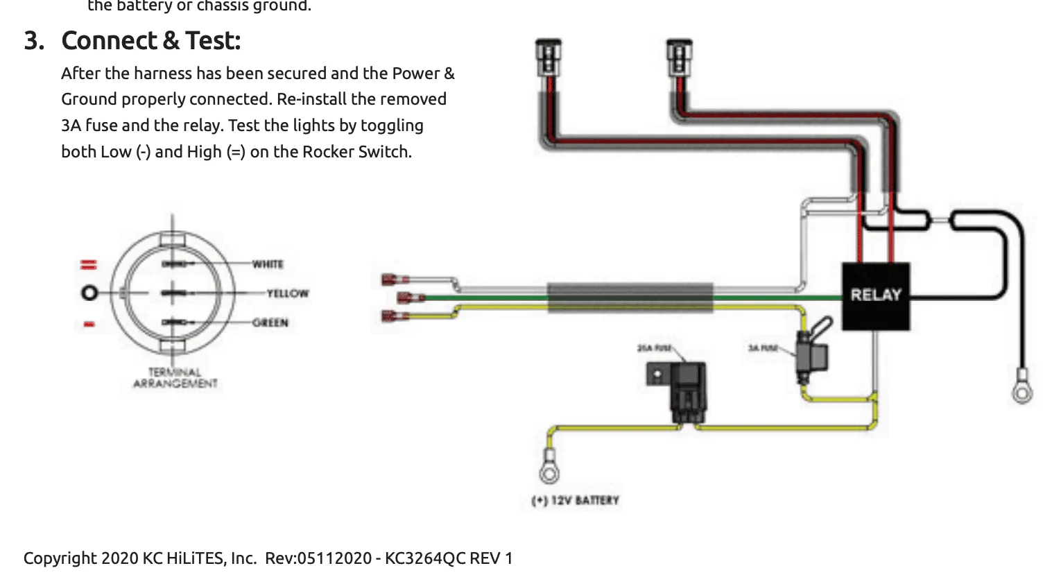

I just bought the FLEX ERA® 1 - 2-Light Master Kit and even after watching the Upfitter switch video I'm still confused which wires to cut. As the video showcases a harness without the relay. I've attached a photo of the harness diagram.
Any help on this would be fantastic, how did you install the Era 1's ditch lights on your bronco upfitter switches?

You cut them down to the red/white and black wires. So the relay is not part of the circuit (doing this will change how it operates with the KC switch). Attach the ground to a existing body ground for easy point. then verify the white and red power cables with a quick test to see which is the back light and hook it up to A6 wire (i also hooked my grill clearance lights to it). I hook the lights up to A3 in my case as the big spots and driving lights are on A1 and A2 as they have more power. the wiring diagram is on the site here as well. There are a few you tube videos as well I watched and helped me too.

Thanks for the help, I figured it out now. I found a really good video as well, that helped. For anyone else having any issues checkout these videos for installing the Flex Era 4's which is very similiar.
Also reached out to KC and they suggested this video:
