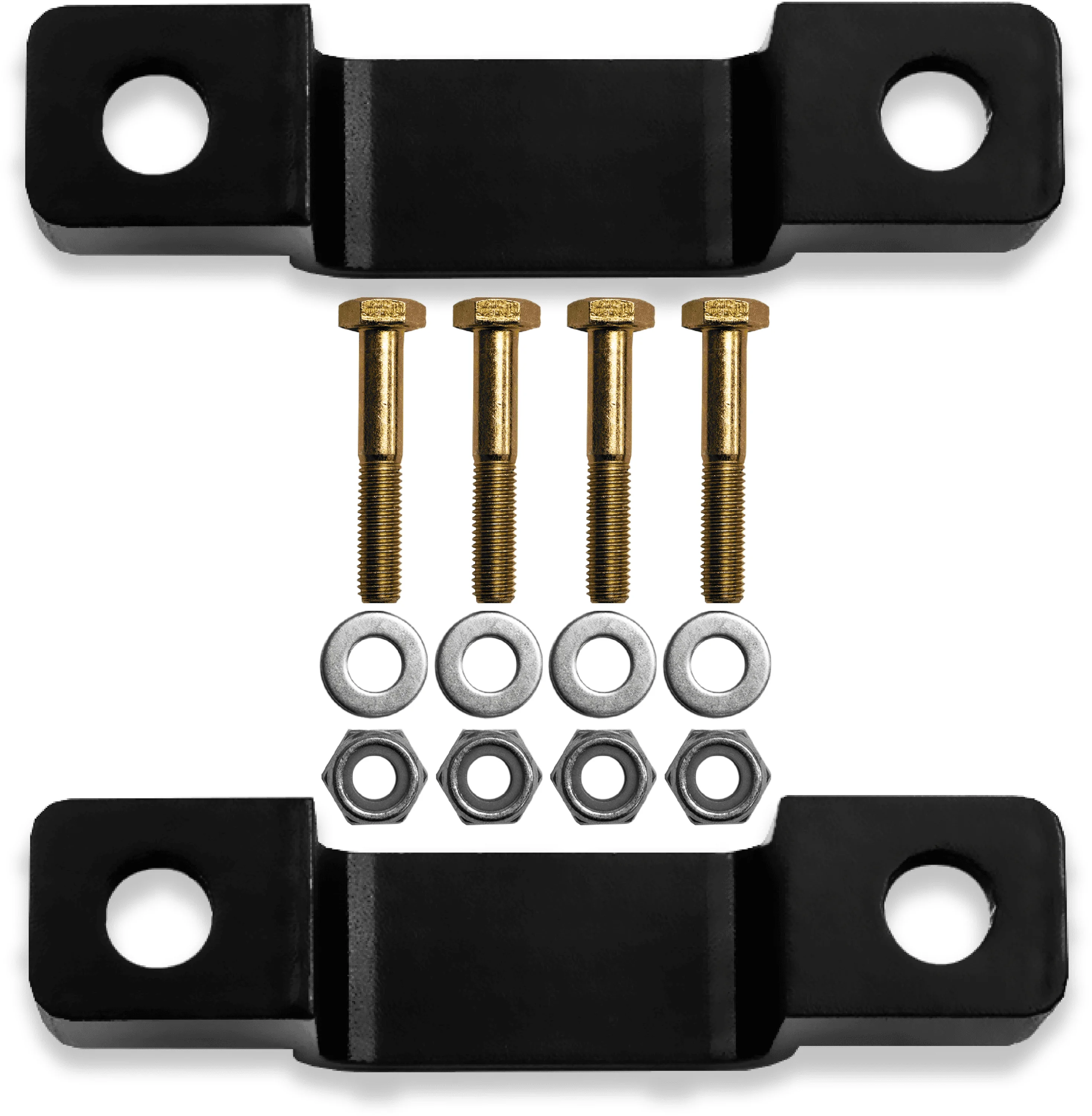

A while ago I purchased the Rock Krawler 1" front spacer lift to get back the spring sag the winch created. The appeal of this method was that it didn't seem to involve dropping the LCA's or removing the shocks. From what I have been reading it seems that I still have to remove the shocks in order to use a press to remove the press fit bolts on the lower shocks.
Has anyone managed to remove these bolts without removing the shocks?
Here is a link to the spacer lift in question https://rockkrawler.com/bronco-1-0-inch-adventure-system/

Was thinking about doing some sort of C-press to push them through. The next thing will be if I get them out will I be able to get the spacer in between the shock and the LCA. Perhaps a spring compressor is the solution for that part.
You wont need a spring compressor for that part. The LCA flexes down more than far enough (with weight off of it). Worst case if you separate the upper ball joint it drops way down...probly dont even need to do that tho
