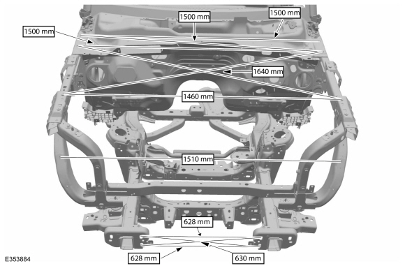

Under Hood Dimensions
NOTE:
All dimensions are on center unless otherwise indicted.
Ford Bronco {thread} {filename}

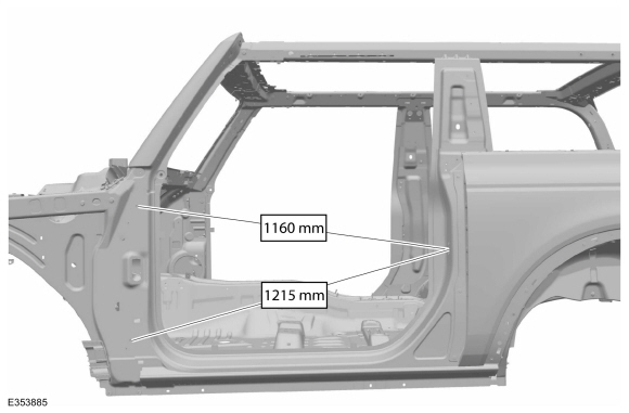

Front Door Opening Dimensions 3 Door
NOTE:

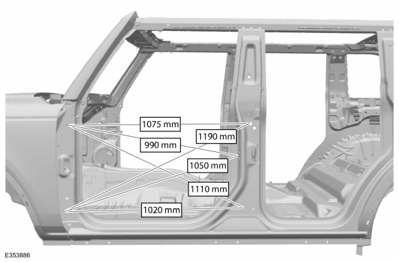

Front Door Opening Dimensions 5 Door
NOTE:

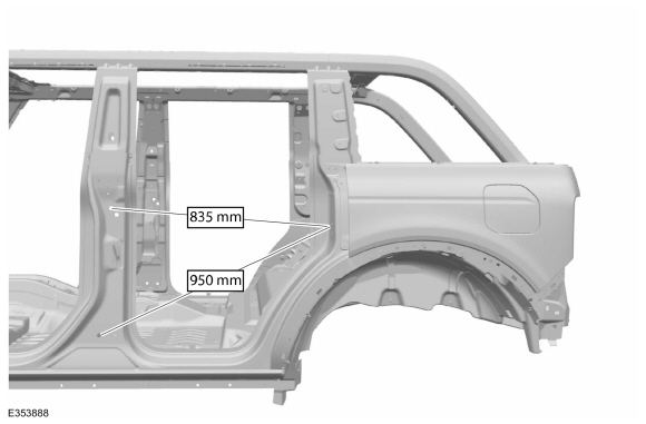

Rear Door Opening Dimensions 5 Door
NOTE:

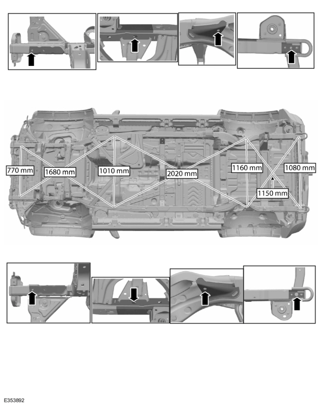

Under Body Dimensions 5 Door
NOTE:
NOTE:
NOTE:
NOTE:
NOTE:
NOTE:
