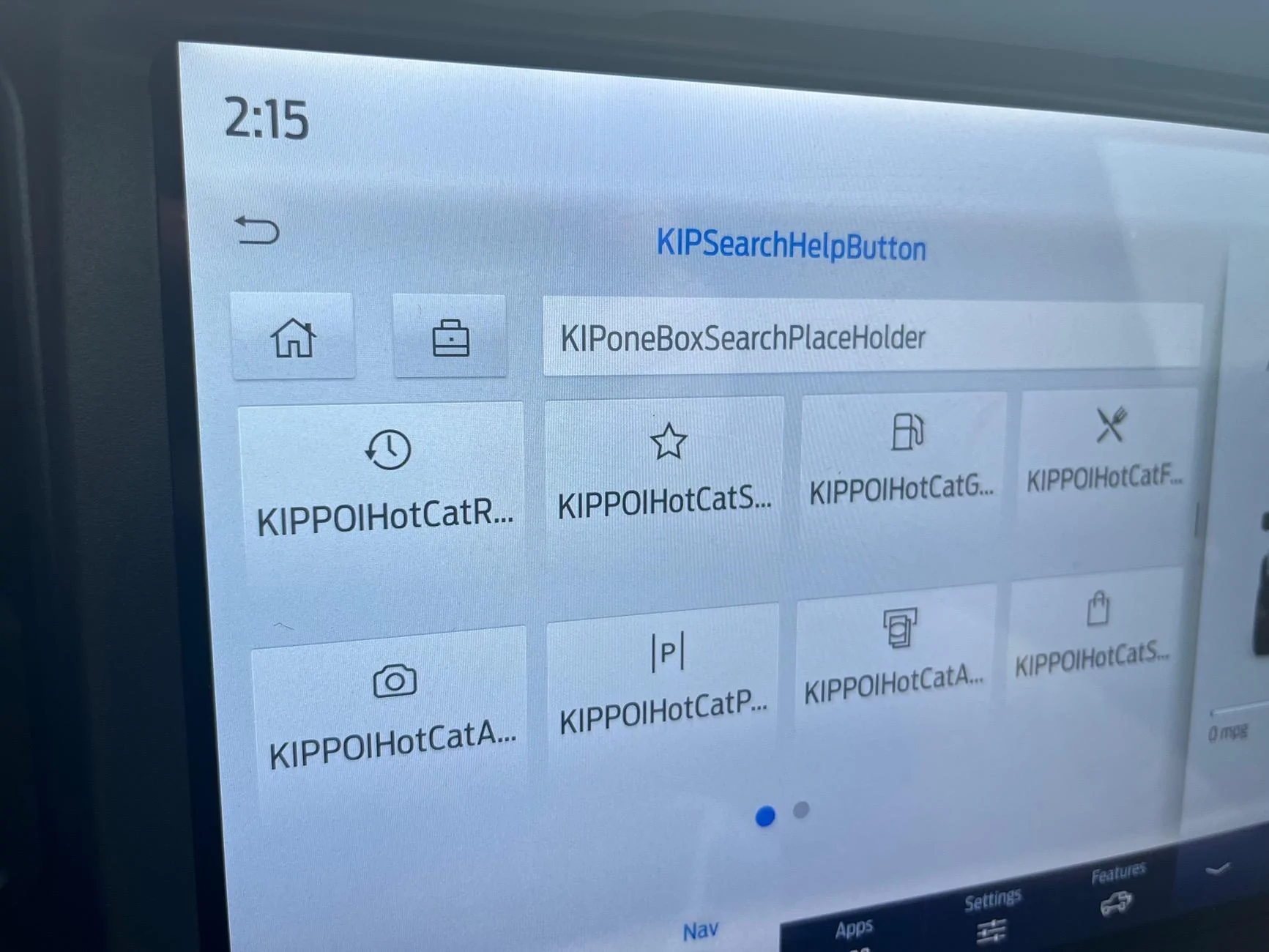

After making the change in Forscan, has anyone else encountered the attached jumble wording and titles on screen, and if so did you fix it somehow? I’ve done a dozen Forscan changes on the Bronco, a dozen more on my F-150, and this is the only time I’ve seen something this wonky. If the change weren’t so useful I’d revert to stock setup.

:oops: oh boy. This is the point where you think real hard if you made a backup before making this change.
That said... I've not seen that before.

You either picked an option that is not supported by the Bronco's APIM, or you picked the wrong option.
What were you trying to achieve and what values did you set??
Thanks for reacting and getting me to investigate further. I’m going to dig into it next week and update here. Mine did not work while driving so I applied a hex register change I’ll need to look up. I have the original configuration. Maybe I made a mistake in the entry.

Yeah I've had that junk pop up and stick around for months and finally I had to get fdrs and reflash the module and it cleared up I'm sure there's other ways to do it but I wasn't sure what change had affected it and tried many many changes and even reverted back to my original as built and it was still there. it's gone now
