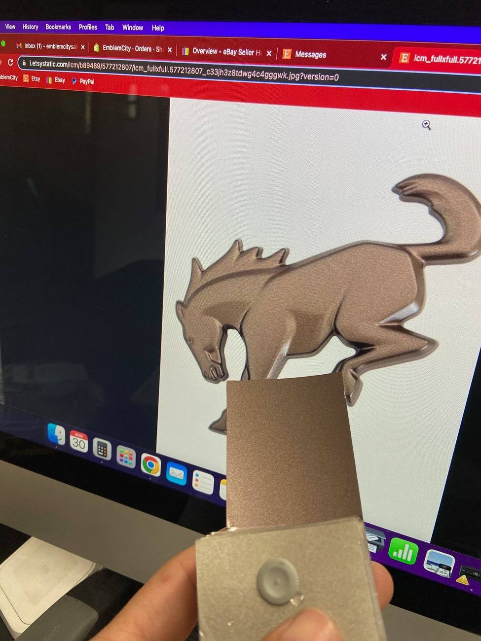

I have found a match for Sinister Bronze. I don't know it's actual color code but i have a Glasurit color chip #. You can use the Glasurit website to find body shops that are using this paint line or Glasurit paint stores and they will have this chip card and will be able to make automotive paint. Using Glasurit 90-line and the color chip is MM291.35
Ford Bronco Ford Performance Sinister Bronze Paint Code? IMG_7646
