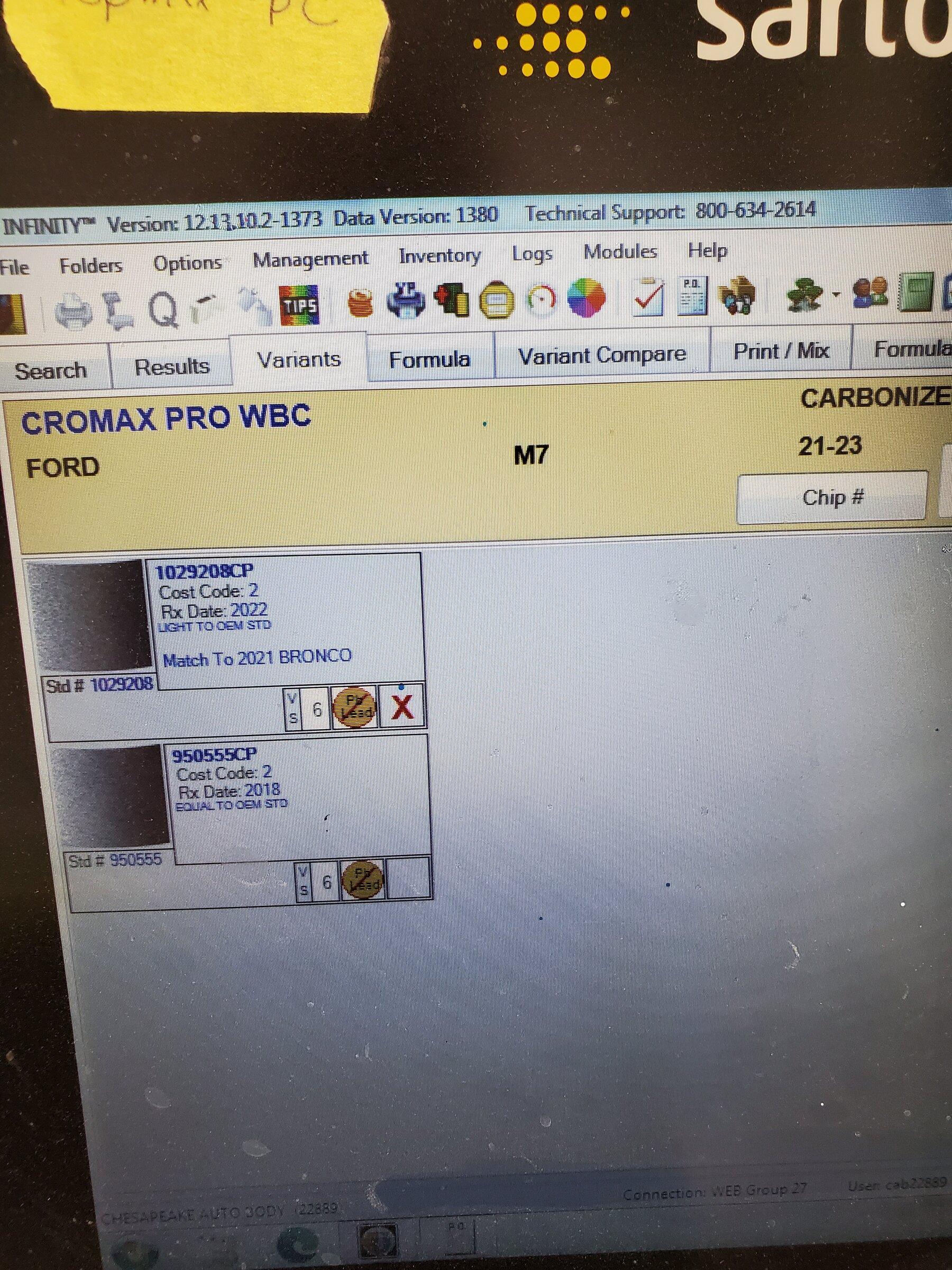

I'm a painter. Your code is definitely "M7"
However, as a painter. Your painter may want the vehicle In house so he can match the color. There are typically different alternates to most colors. In my picture, I show two. If he paints it now without being able to compare the color. It may not match when they put it on. As you see, one alternate says "bronco" that doesn't necessarily mean it will Match your bronco.
Ford Bronco Ford Paint Codes ? 20220502_141839
Thanks. I will probably wait then....
What's a little more time now?
Mattsn
Matt
Feb 3, 2022
84
93
Maryland eastern shore
If I was your painter, I would tell you let's wait until we have the vehicle. Doing it one time and making it right is alot cheaper and easier than doing it twice
