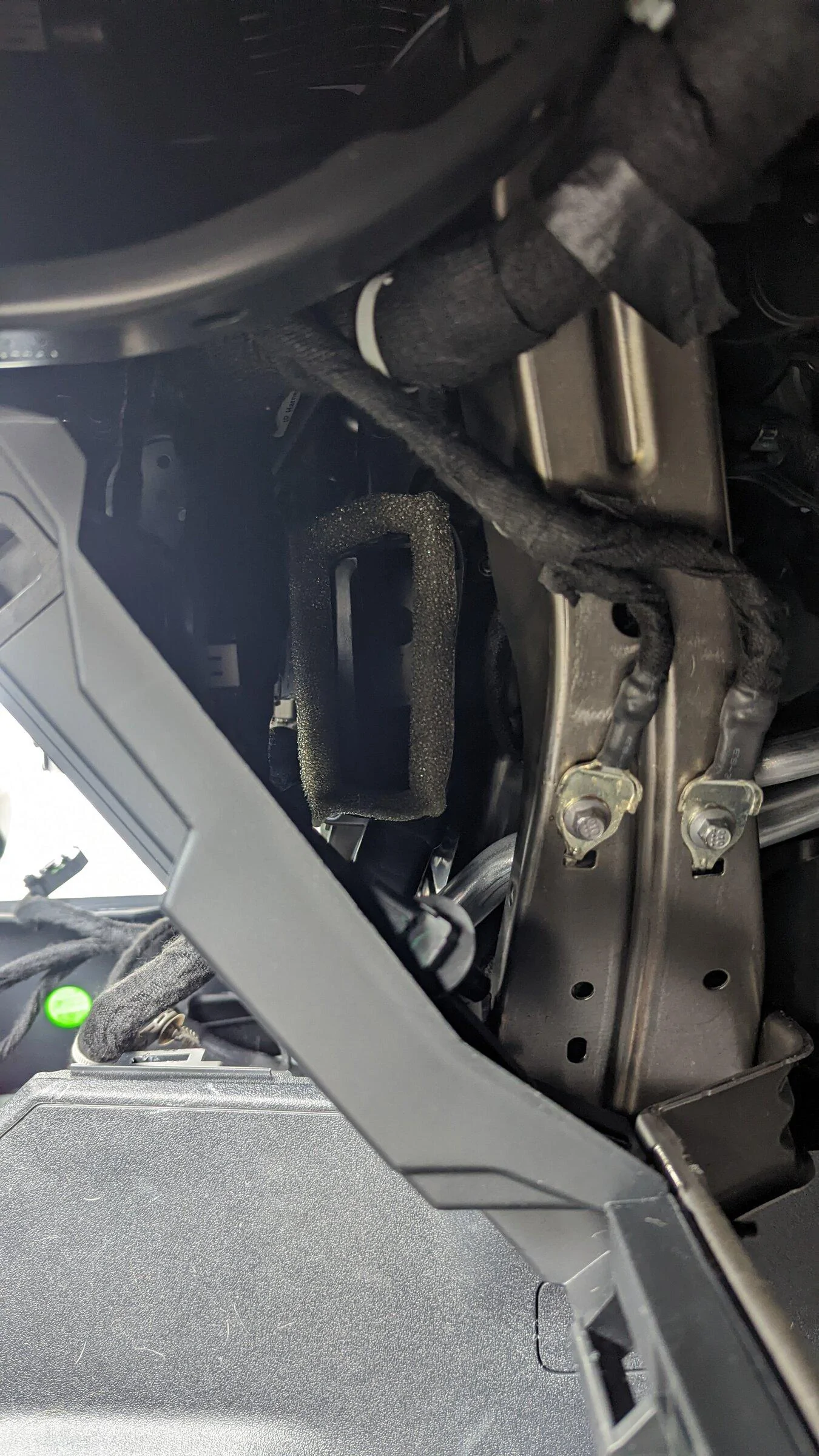

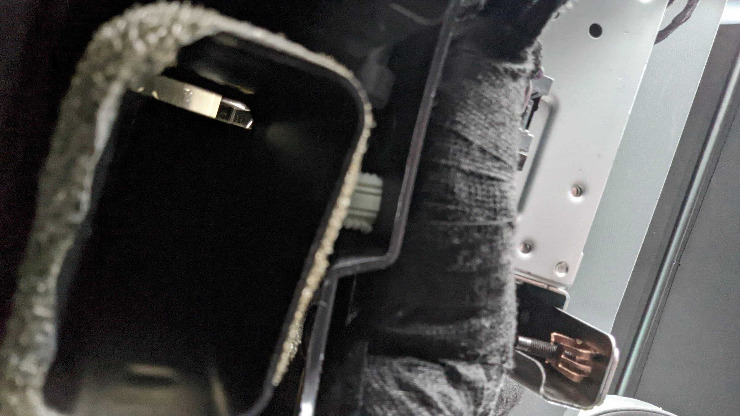

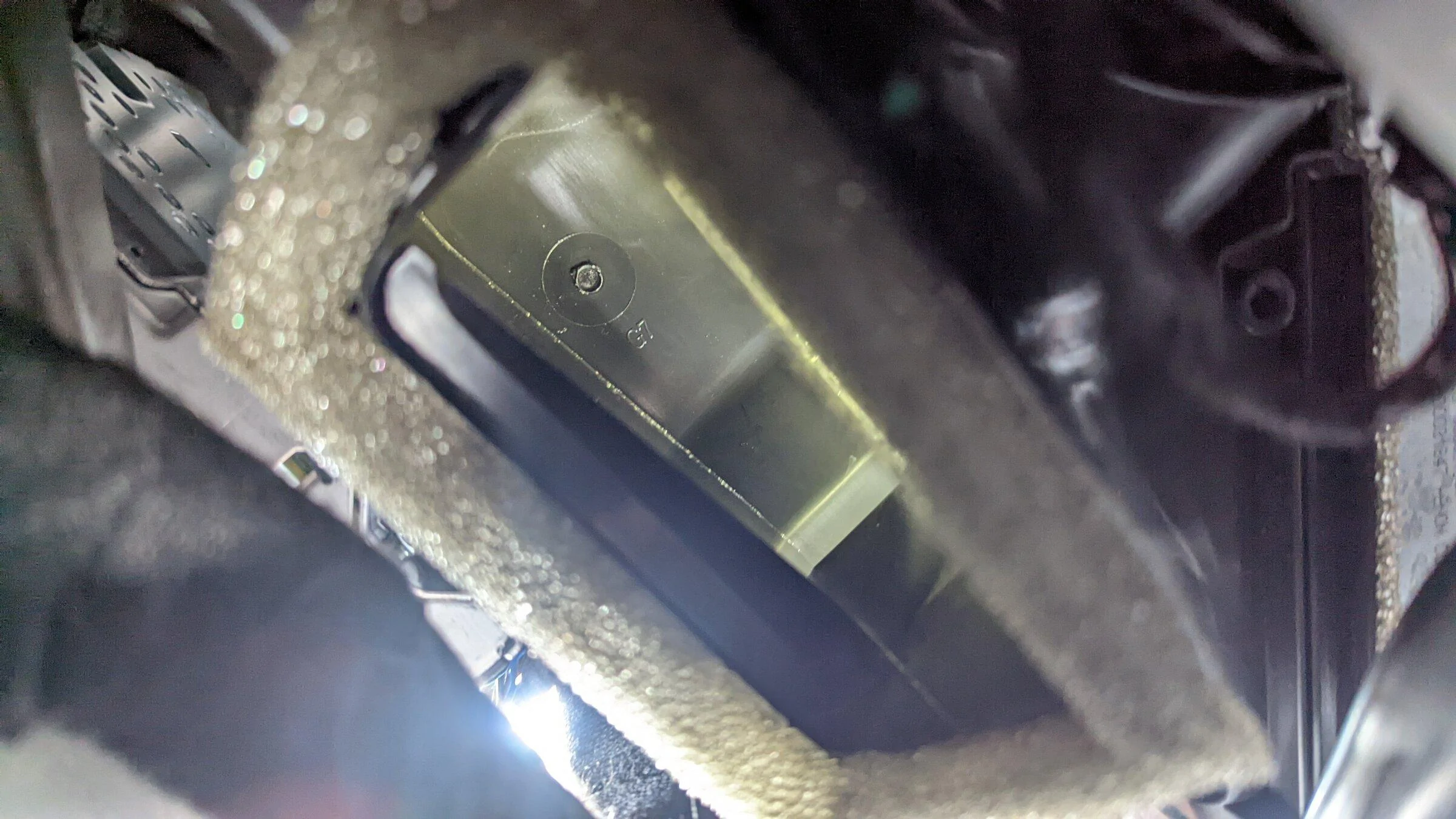

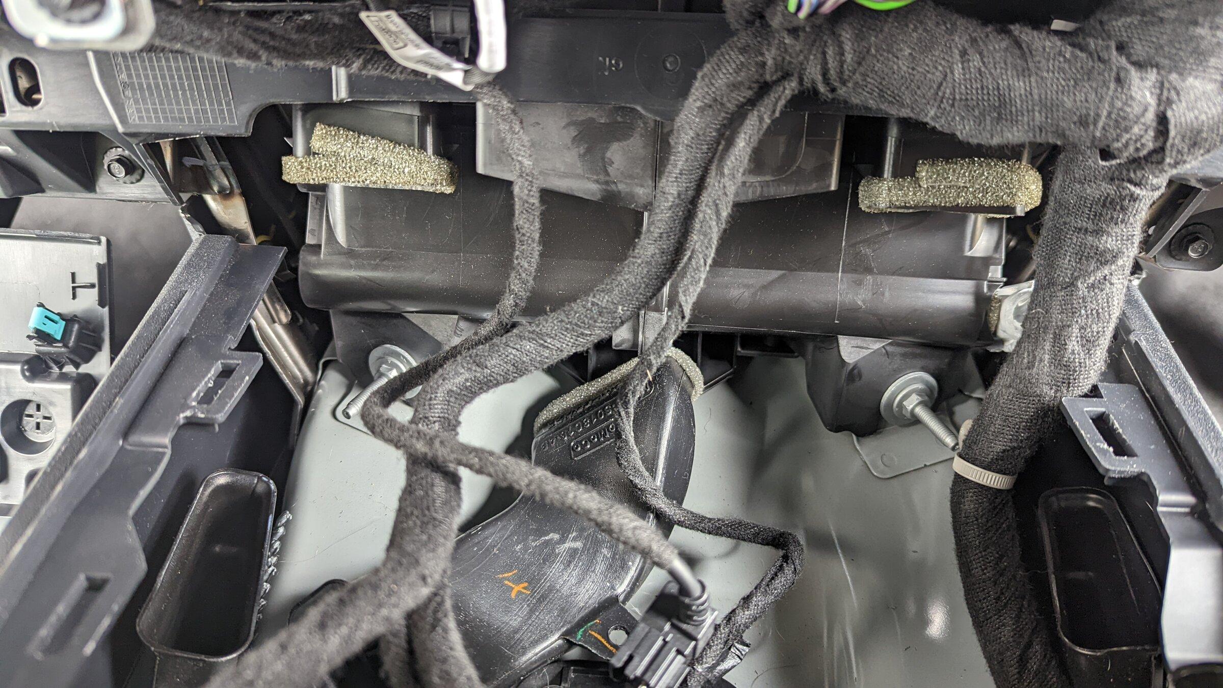

Decided to dig into this today and pull some things apart. Turns out that there is only a small passage for air left in the heat exchanger. When set to Floor, the majority of air is sent out to the front foot wells with only a very low volume being left for the rear to flow through a restricted port for the rear channels. It is certainly not the mechanism in the heater coil.
Image 1 - the console removed as well as the heater ducts.
Image 2 & 3 - view in from glove box with duct removed for floor in foot well and light from below to show the small hole at the end.
Image 4 is from below the rear heater channel opening from below with light from above.
Any obvious ways to improve the flow?

I was able to increase the air flow by cutting out the rest of the material in the way. It was not easy and I think I have a better way, and less destructive to the hands, to do it. I noticed that the airbox flap does not completely close when floor is selected. it remains open a bit and my guess is that with the side defrosters contributing to the heating that the lower ones would not be needed.
I Gorilla taped the two larger holes in the front passenger foot well to increase the volume to the rear. It is noticeably better on the passenger side rear than the driver side "hot breath" coming out.
I can see that they would want to keep the hot or cold air up front as that is where it will be needed most times, but the volume of air as it sits is the equivalent to a kerosene heater in a sports dome.
We're taking a road trip tomorrow so my daughter will be sure to give me an update as she is usually the one under a blanket while we melt up front. I am going to do some more testing and hopefully come up with a useable mod/fix for this that does not require the way I had to go about doing it.

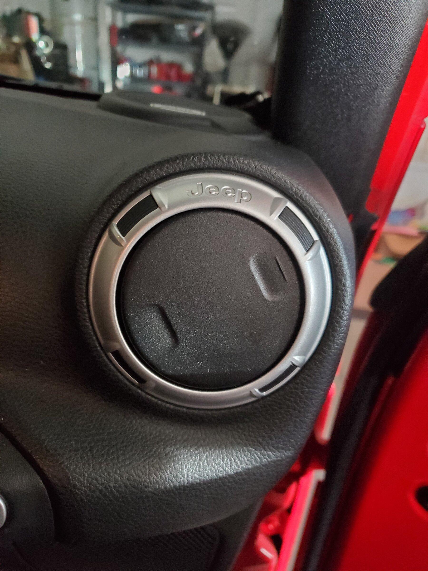

Not having my bronco I can't answer this... But can you simply close the dash vents when you have it on floor to increase the heat coming out of the floor vents?
My jeep vent...
You can close all the dash vents and switch the air to Floor, but what happens is all the air comes out the defroster and side window vents.
