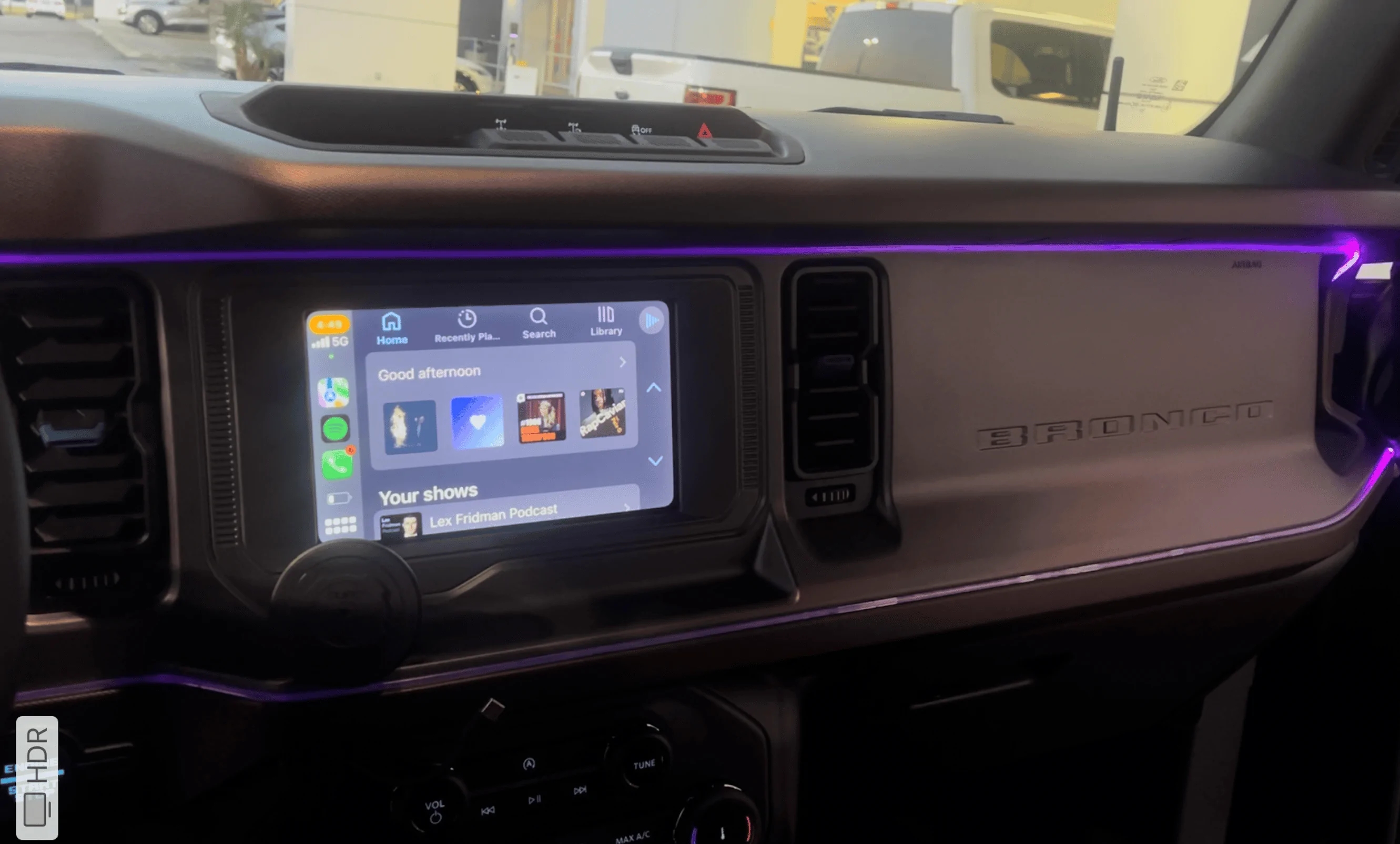

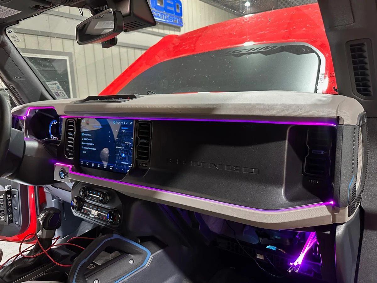

Installation video is up!
What are these imperfections and why are they shining through??? Looks like a cracked glow stick.
Ford Bronco First Look: ORACLE Lighting accent lighting for Bronco Dash 4B2B4B9E-54BE-4C55-87F2-1342BA99A6CE
JP_Oracle
Squatch Sponsor (Level 3)
JP
Apr 20, 2022
285
370
Metairie, LA
21 Bronco
This happens when too much pressure is put on the soft PMMA when pressed in. This can also happen when the cable is excessively bent while handling.

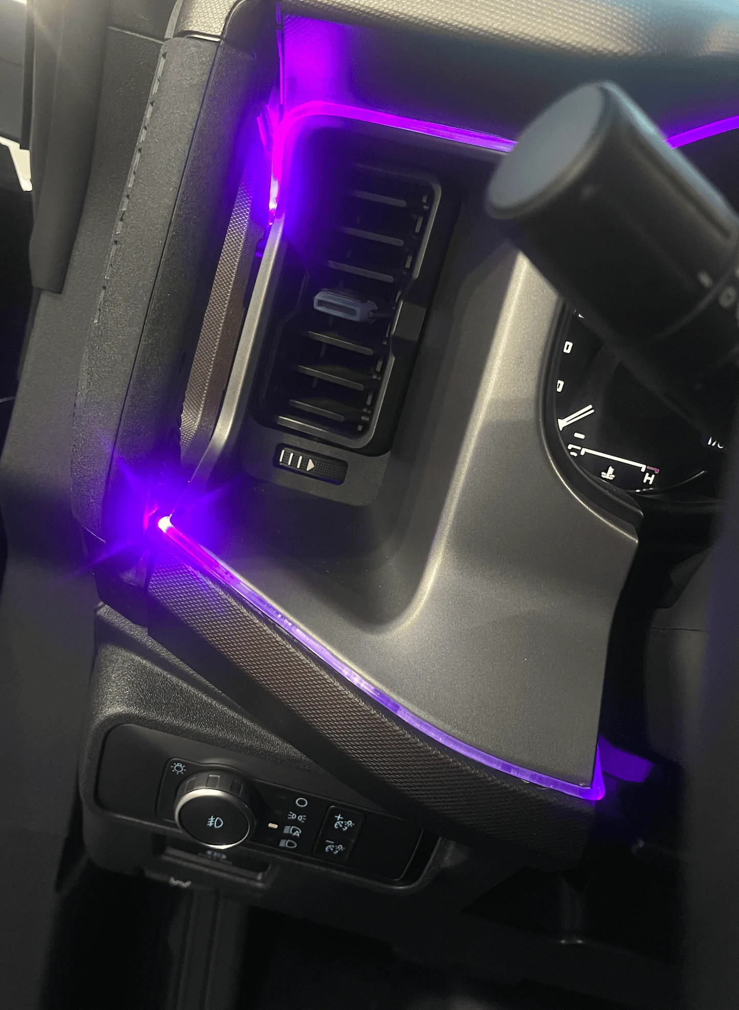

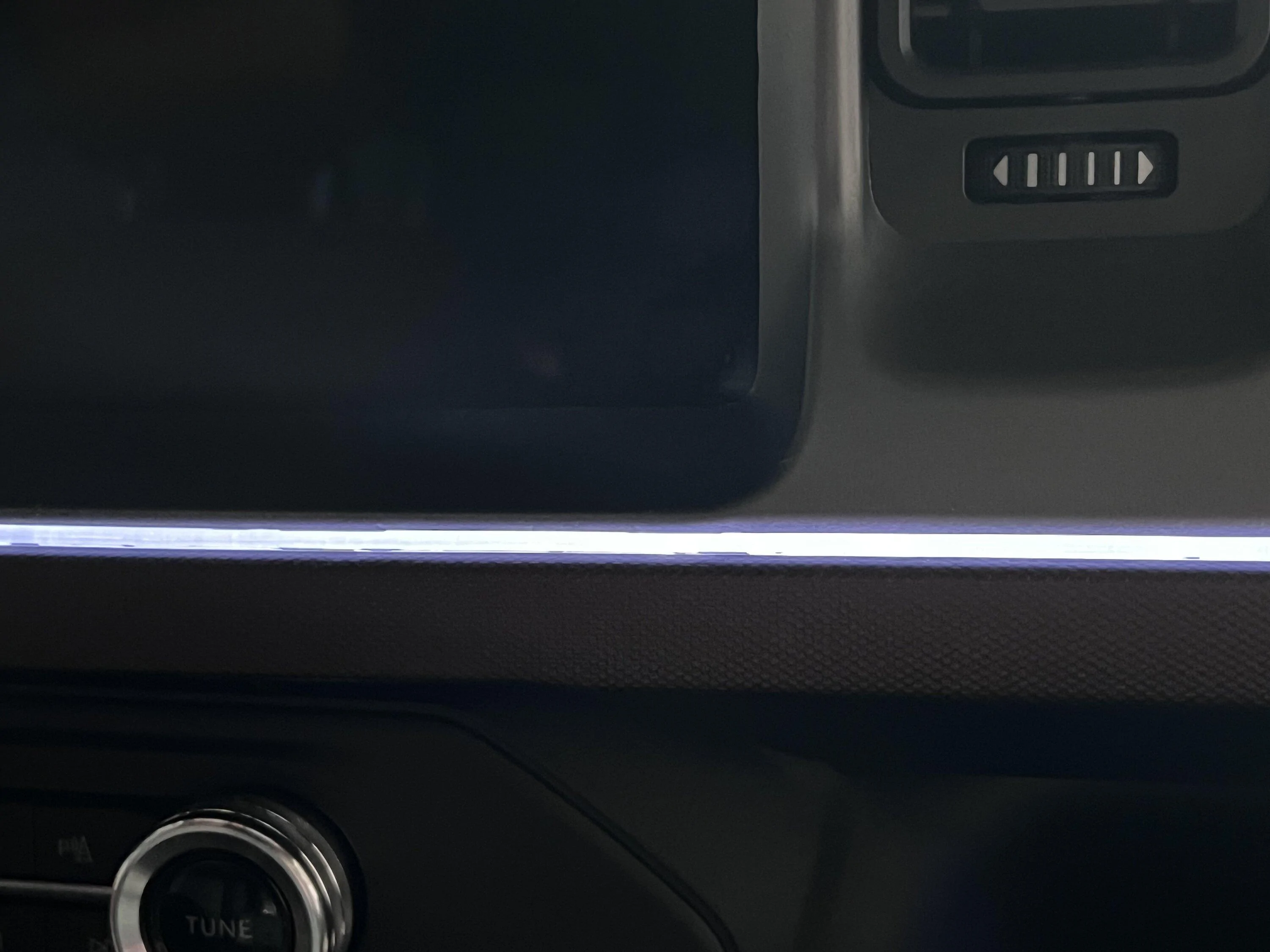

Hey @ORACLE Lighting. I had my local official Ford Dealership install your accent light kit (using the supplied instructions + install video). Can you advise if you are updating this kit with better materials and/or better instructions? Or perhaps the unit I have is defective?
To say the least it looks very far from the product photos and videos. Please provide your thoughts so I can pass to the dealership to fix this (if at all even possible)...
Problems / Observations:
- The entire bottom strip is half the brightness due to the turns at the edges
- There are imperfections in the material everywhere - looks like a cracked glow stick (looks even worse in daylight with unit off)
- The tubing doesn't appear perfectly straight (the installer pushed it in as far as it goes)
- The installer resorted to using glue in some areas where the tubing would not stay secured
- The overall fit is below satisfactory (per the dealership)

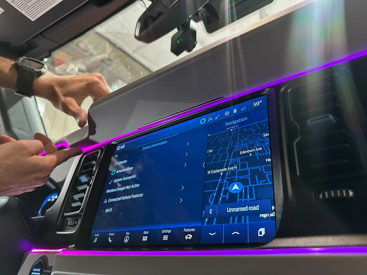

Looks like the dealer has the cable ends pinched between the side handles. There's a groove you can run each end through between the trim panel where it won't get pinched like that. Here's a picture. (The groove is where the tech is sticking the panel tool in)
Ford Bronco First Look: ORACLE Lighting accent lighting for Bronco Dash 1670944484665
In regards to the imperfections in the cable, This happens when too much pressure is put on the soft PMMA when pressed in. This can also happen when the cable is excessively bent while handling. As stated in my last post.
