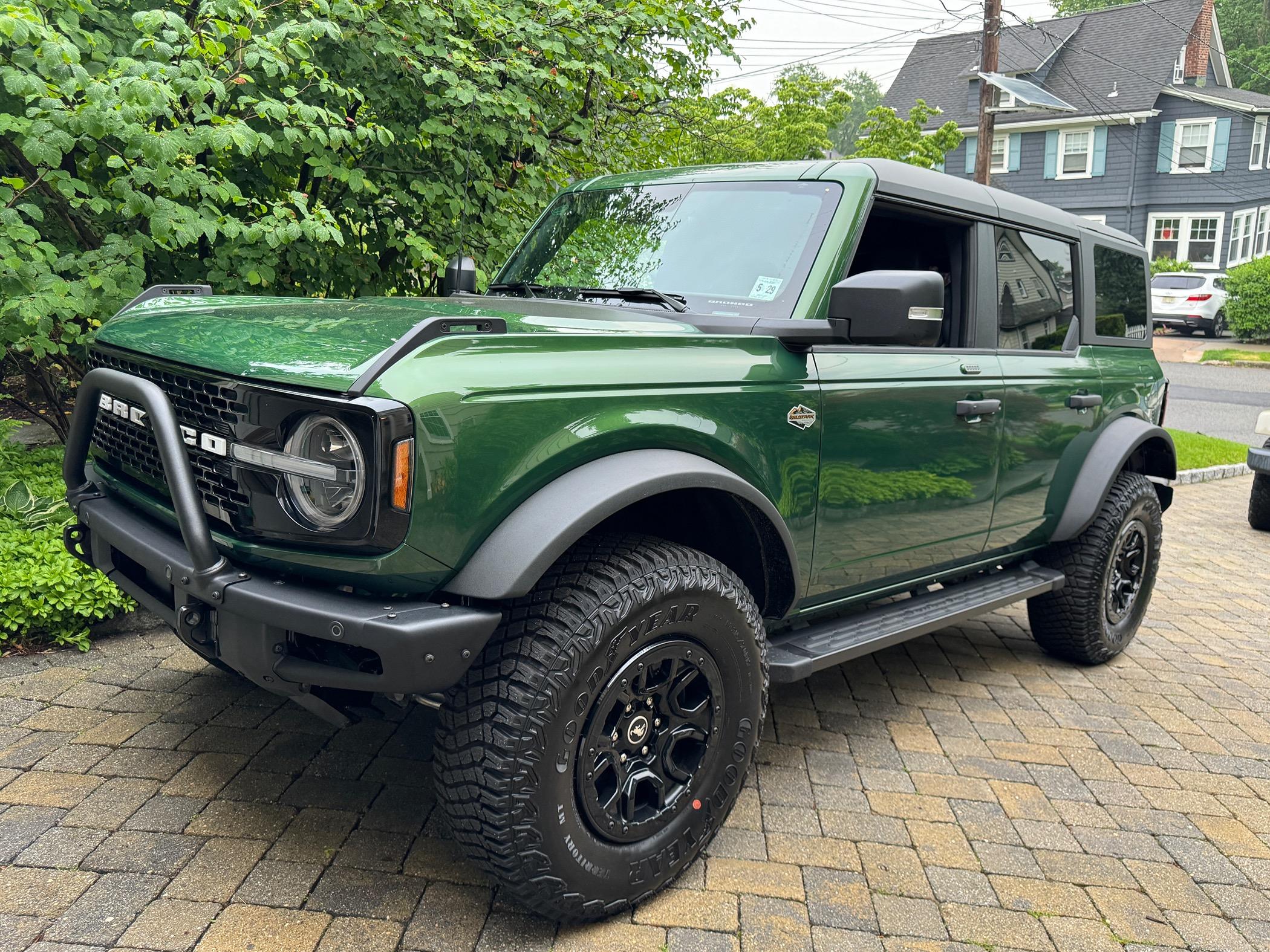

Took delivery today on a leftover 23 wildtrak
I’ve been driving jeeps since 2000 last Jeep was a 2021 gladiator Mojave ditched it today for this … This new bronco is a whole new animal Holy $hit ! Everything is perfect although I do have that tire vibration in between 45 and 60 the dealer does have the pressure at 45 so if lowering it doesn’t help, I guess I might have tire issue on the Goodyear territory MT? …. thoughts on the best way to handle that. Anyway I think I’m in love.

How long has it been on the lot? It’s more than likely flat spots if it’s been a few months there.

Lower the tire pressure and drive it on the highway. Will probably get rid of those flat spots.

Drop her down to 35psi cold and see if that makes a difference. Each time I go in for my 5k mile 5 tire rotation (35,000 miles so far) I have to remind them to return the tires to 35 psi. A few weeks back I allowed them to leave the psi at 39 (they said my mpg would be better, who cares, but I fell for it) and hit the road from Houston thru New Mexico on our way to Pagosa Springs, CO. It rode like crap and vibrated all the way to Waxahachie for my first fill up. Reduced her back down to 35psi and got the ride I've become used to which is nice and smooth, even cruising at higher speeds.
