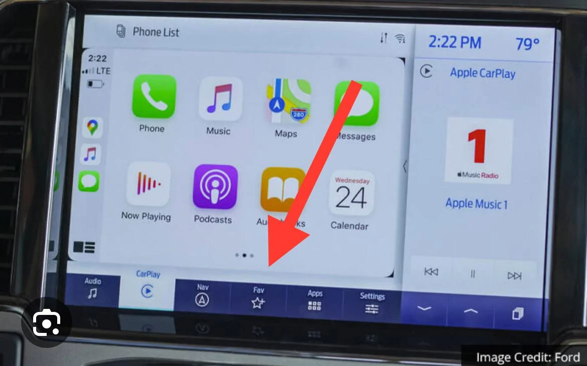

I've found how to add a Favorites touch button to the center display using ForScan.
For my High package Badlands in the APIM I changed to 7D0-02-01 xxx* xxxx xxxx. *=6.
originally was 7D0-02-01 0412 020A 02FE.
A Favorites touch button appears along with the Nav, Settings and the rest at the bottom of the center screen.
It could be handy for some, it mostly allows for short cuts to the menus. I was looking to use it for one touch Display off or Weather radar access but that wasn't possible so I returned the module back to as built.
