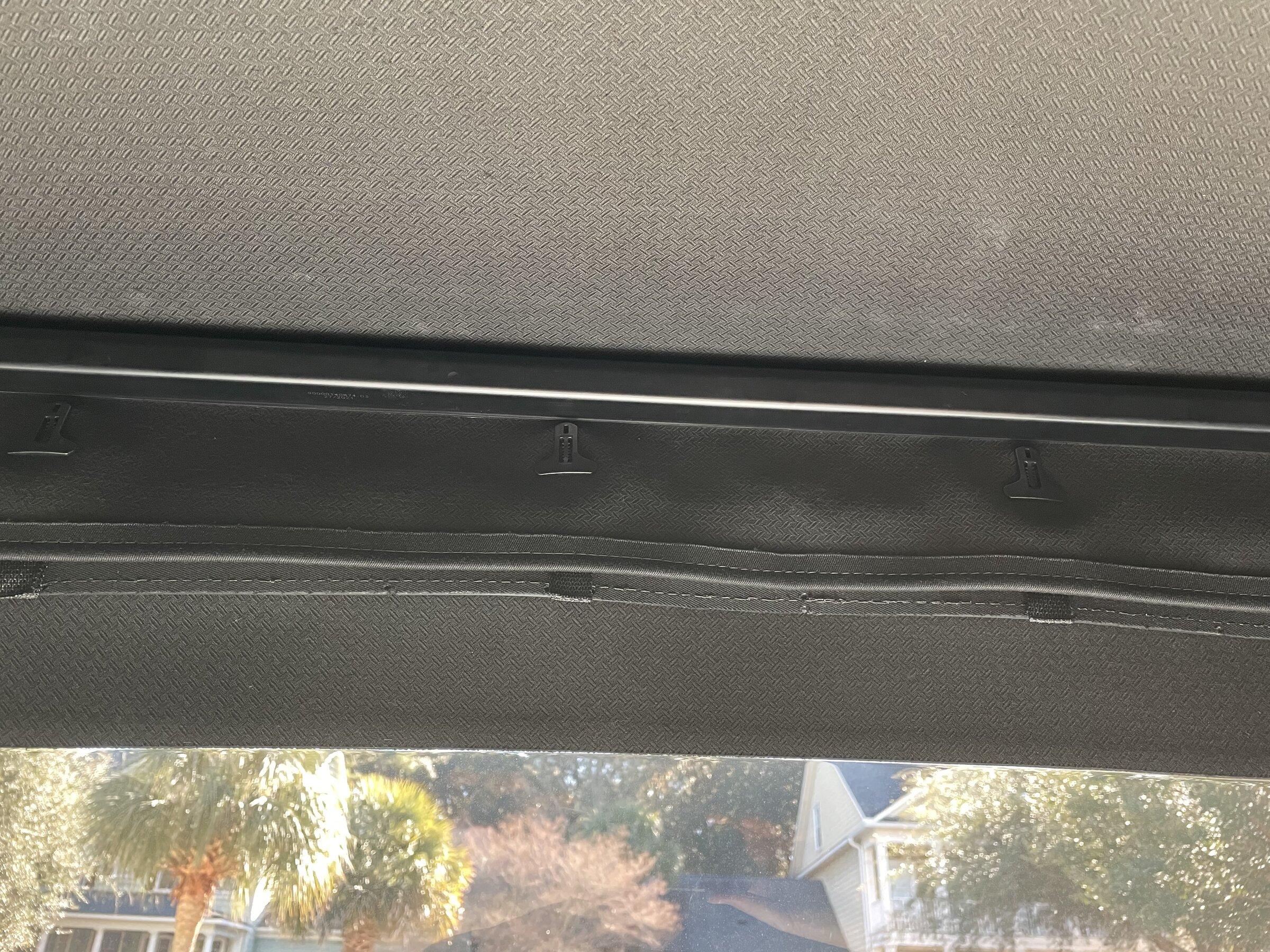

The main issue i have now that my dealer doesnt seem to want to acknowledge is the soft top noises. I have owned other soft tops before but this is a distinct noise coming from the rivets through the cross member above the rear window. When the top is in the "half back" position, it will pop and sqeak like there are two birds fighting in the back at any speed above 30 MPH. I have a video of the clicking sound when stationary. will have to get a driver to stick me in the back to film the sound when in motion :)
Im thinking that this needs some sort of lubricant around the rivets but have no idea what to use. Anybody else experiencing this? any ideas?

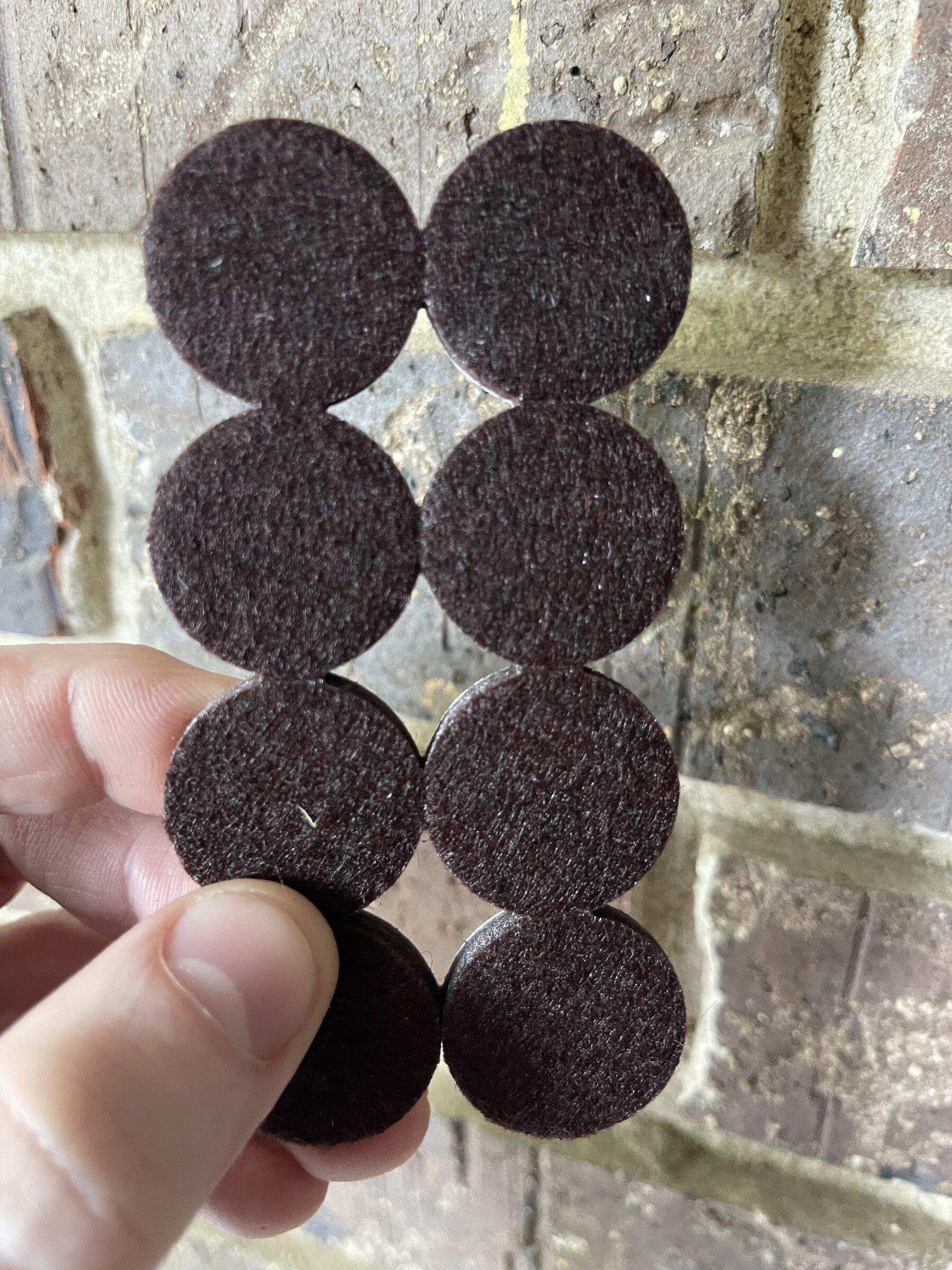

That does sound promising! thanks for sharing. Could you share which felt pads you used?
I’ll try and get a picture when I get home. You fold them in half as you put them in. Sticky side out.

Take the back off to expose the sticky side. With a flat head screw driver on the felt side, push up into the bar between the soft top plastic channel and metal bar as close to the rivets as possible. I used 2-4 per riveted space and several at the bar end where the plastic flares out.
It is helpful to place something heavy on top of the flap that has the female side of the clips to hold it on top of the soft top while you work.
