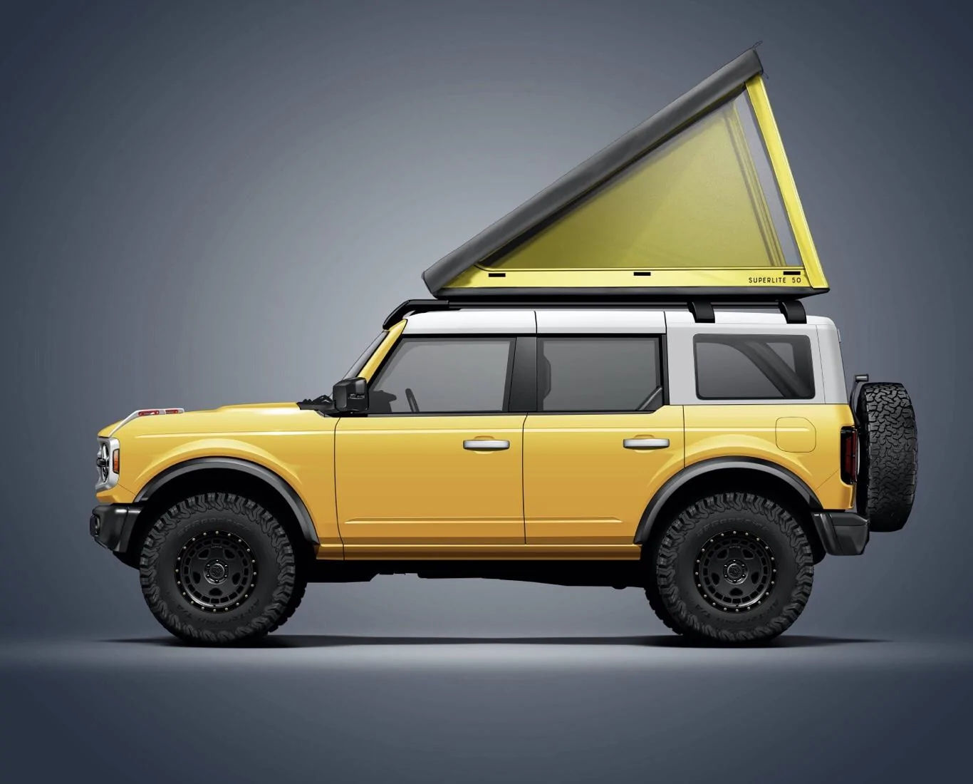

The SuperLite Roof Tent by Go Fast Campers is the option I’m considering. Weight is approximately 80 lbs, and it’s made for 2 adults plus pet or toddler.
https://gofastcampers.com/pages/superlite
Below is a CGI rendering from the company’s website showing the SuperLite on a 4-door Bronco. I haven’t seen a rendering for a 2-door Bronco, but I think the Company has indicated that it will fit the 2-door, too, but likely with some overhang.
I have emailed the company asking for an overhang diagram. If I receive a response, I will post it here.
Quick follow-up to my previous post from a few weeks ago. As I suggested, I recently emailed GFC requesting a mounting diagram with key dimensions — while considering the potential overhang when mounting on a 2-door Bronco — and this is what they sent me (both text and PDF attachment)...
Thanks for reaching out, I'm happy to help.
The SuperLite is made to work with a wide array of roof racks and crossbars. Given its weight, it's also compatible with most vehicles on the market. Two things to consider before purchasing are the dimensions of the tent and how much overhang will be present when mounted on the vehicle, and the static weight rating of your roof rack. I'll dive a little deeper below:
Dimensions and overhang:
I've attached a visual guide for overhang guidelines, but I'll sum it up here as well. SuperLite's need to be mounted with no more than 16" of overhang off the rear of the tent. That's because this is where you put your weight when you're entering the tent, or where you'll sit when you're hanging out at camp. In order to avoid too much leverage off the front, the front-most crossbar needs to be a minimum of 7" from the center of the tent. This means there's 38" of available overhang off the front of the tent. This basically means you'll only need 36" from crossbar to crossbar in order to successfully mount the SuperLite on your vehicle. Keep in mind, we do not recommend standing or sitting on the SuperLite when it's closed.
Crossbar/rack weight rating:
The ball is in your court on this part. You'll want to find a mounting solution that will accommodate the weight of the tent (~80 lbs) plus whoever is planning on sleep inside of it. For this, you'll want to find out the "static" weight rating of your rack or crossbars. If you determine it's a safe fit for the weight you anticipate in the tent, go for it!
Mounting/hardware:
All SuperLite tents will ship with our Universal Mounting Straps and all necessary hardware to mount the SuperLite to your vehicle. Our quick-release mounts are still in development and we hope to have those ready soon...keep an eye out for updates and check out our new SuperLite Mounting Video HERE for more information and a visual guide for mounting the SuperLite using the Universal Mounting Straps.
If you have any other questions please let us know.
